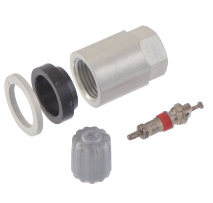

[MENTION=137652]jfry008[/MENTION] is right - these are what you need. I worked on a tire/sensor set up like this today - it is pretty simple and would take the shop all of 15 minutes. Just do it and be done, shouldn't cost much at all! Or delete the TPMS!
I would say tire shop as well. Those aluminum stems tend to corrode and can leak from a few different spots. The do break easily if over tightened. Any decent tire shop will have replacement stems that can be swapped onto your existing tpms sensor, or a complete sensor/stem assembly for around 30 bucks.
They will not have to remove the tire, just break the bead and squish the tire out of the way in order to swap stems. This is the quickest way and no need to rebalance the tire because it hasn't move on the rim.
