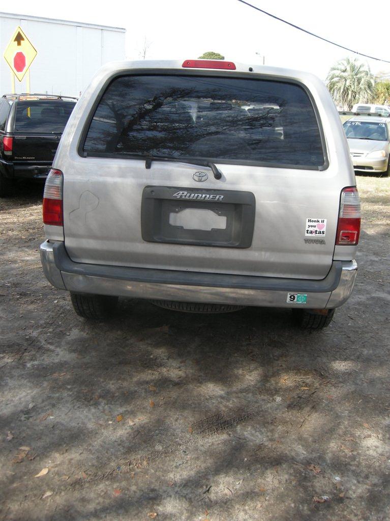

Im thinking of buying this 97 4Runner just because, but i want to know is, is it normal for a 4Runner to lean this much on the passenger side?

Measure from your hub straight up to bottom of bottom of the fender. That looks like a pretty bad lean and could indicate a broken spring on the passenger side.
A 4Runner/Taco should lean towards drivers side, not passenger. That is because the battery, fuel tank and driver all sit on one side. Something is wrong with that 4Runner's suspension
Alright, well if its just suspension then thats alright, im putting a lift on anyways, i just wanted some info from guys who know more about these trucks than i do. Thanks.
