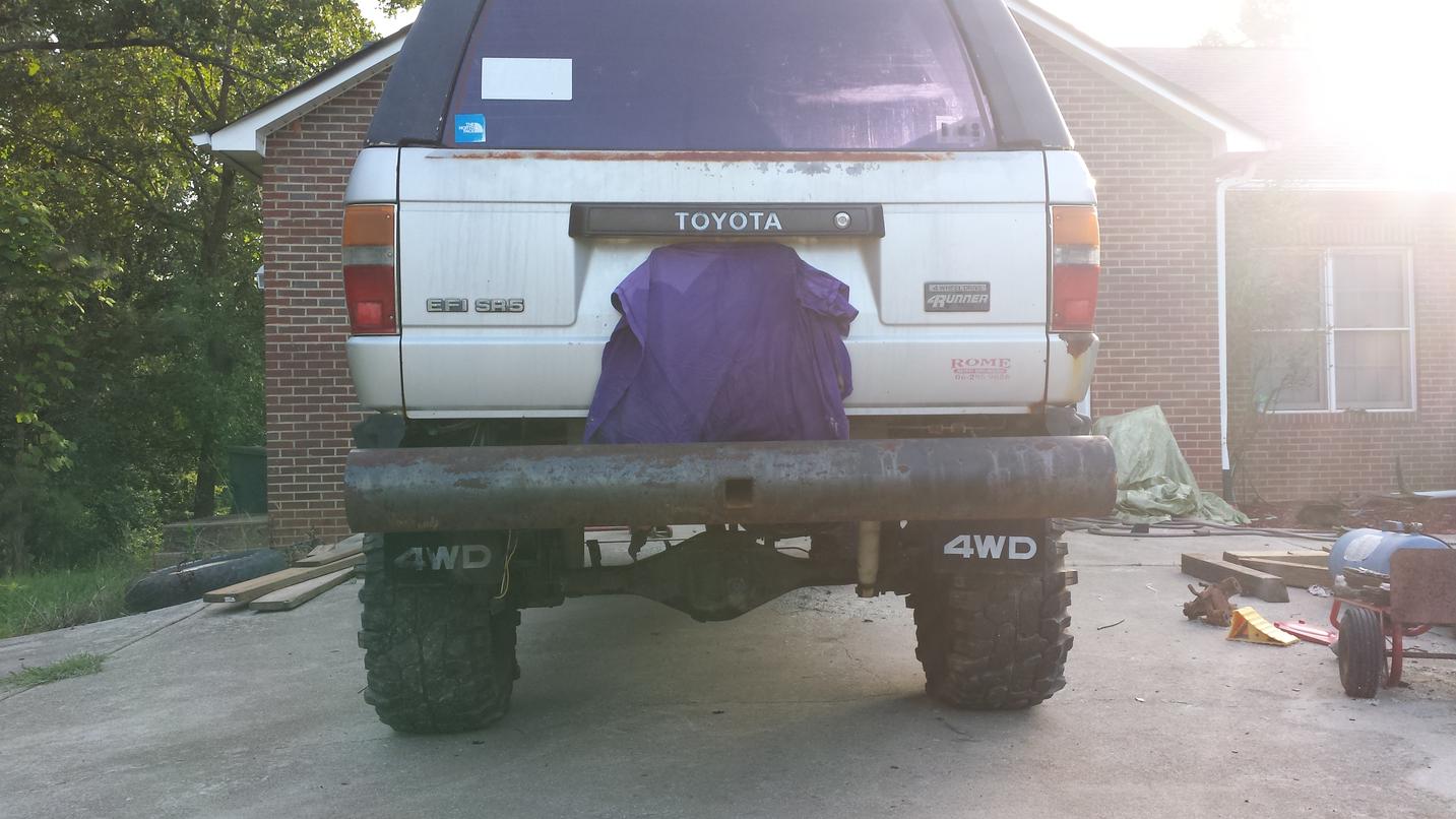

What can cause my 1987 4runner to lean to the right? Measuring from the ground up to the fender well, there is over an inch difference. Just installed new OME 2 inch lift springs in rear and bj spacers up front. I backed the tbars completely off and it is still leaning. It does have a full tank of gas on that side. Can that be it? What to do?

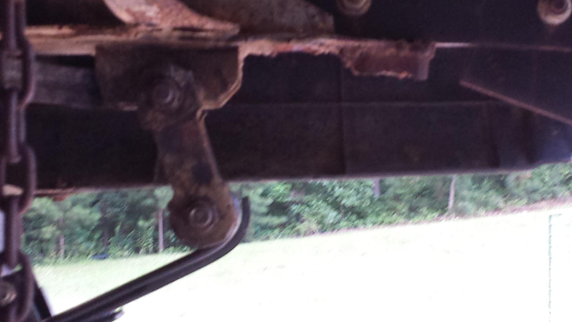

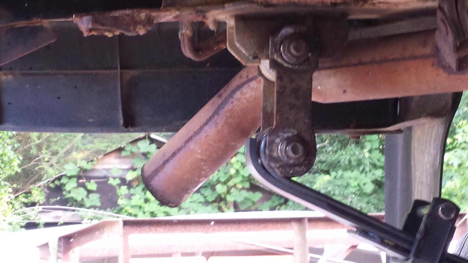

Here are some pictures of the shackles. Not an extreme difference but noticeable. A little over an inch higher on the drivers side.
