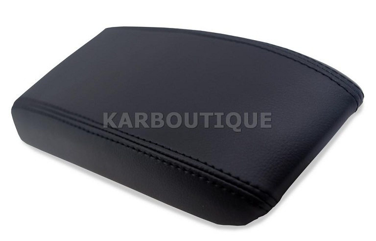

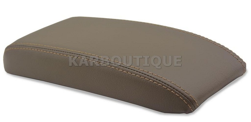

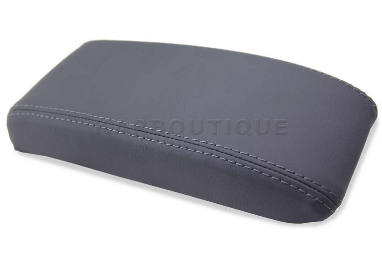

I just ordered one of these and thought other members might be interested. Nice little addition to non-limited 3rd gens. He makes them in black, tan, and grey. Pretty much covers all of the 3rd gen interiors. I think the pricing is good. He sells black in real leather according to his add. Can also get black, tan and grey in synthetic leather (vinyl). But vinyl is a really good durable product as well.

Well I got mine mast night and got it installed. Pretty easy process, remove the lid, remove the screws on the bottom of the lid, pull the staples in the old cover, put the new cover on.
A couple points, this cover is fake leather, not real (probably obvious from the price). It is not as thick as the OEM one.
I didnt' notice the foam that Pattycakes mentions, but maybe it's there and just compressed.
This cover is much thinner than the OEM one.
The curvature wasn't perfect, but it seems to have pulled tight.
I ended up putting the new one right on top of the old one, so using the old one as padding basically. This allowed the curvature to match better, but it made reattaching it to the plastic carrier much tough, and I really should go back and cut to old leather away from the corners so it'll fit better. Anyway, it looks pretty good so far. I will try to remember to update some pics once I get the interior put back together so I can get a pic of it in place.

Well, I still havn't put my interior back together, but I did compare the cover to the tan of my seats, and it is damn near exactly the same color. Very good color match to the seats. I am hoping to get my speakers re-wired and installed this weekend so I can put the interior back together then.
I just ordered one in black. My grey cover has a .25" cut on it. But i think black would match the 2 tone center console ok black and grey.
