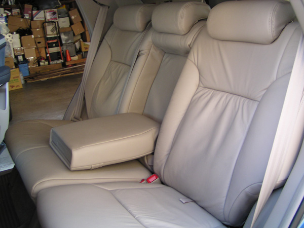

can you post a pic with the rear seats, with the armrest in the middle opened. and how did the double seat with the armrest leather came through? did they came separate? a close up would be great. thanks:)

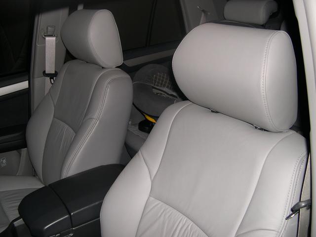

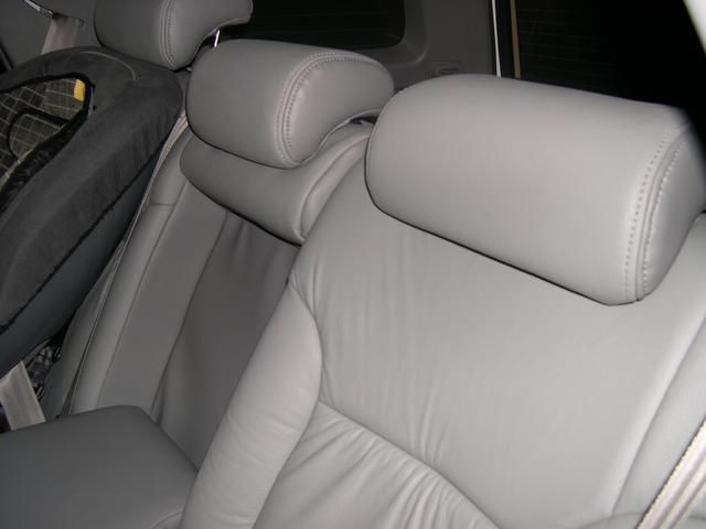

yea, the LC headrest are really nice on your head! Fit the new 4R nicely too! He took the LC headrest off his brothers LC to compare the factory color to the Ebay leather for you guys to see how perfectly it match.

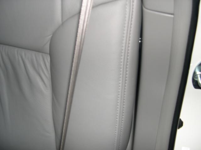

Here some Pix off the ebay leather.

Ask and you shall receive! (See attachment).
The leather for the armrest comes separately. You can remove the armrest by prying off the plastic cover on the exposed side and unscrewing the screws (I think there are 2 or 3). The cupholder/tray is held in by 3 screws. You'll need to remove the cloth cover partially, unscrew the screws holding the tray in and pulling the tray out before you can remove the whole cloth cover. The double seat-back was the hardest part to install. I'm actually thinking about re-installing it to get a tighter fit. As you can see, I've got too many loose parts on that portion. I did that part without hogring pliers and also re-used the old hogrings. I've got all the "right" tools now, so I'll be tackling it soon.

one more thing, how were you able to put the seat cover on the 2nd row with the seat belt in the middle? did you have to take it out? how? tnx.
Tearjerky said:
tkr,
If I remember correctly, the seatbelt is bolted onto the frame of the car with a 10mm bolt, so just remove it and that'll give you access to installing the seat. Just remember how it's installed so you can put it back later.
