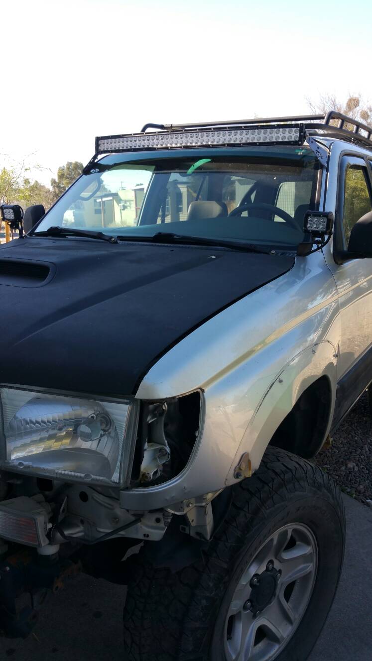

I used the channel mounts that are being sold on here by another member and I purchased my bar on Amazon for 160.00 I am very happy with both. The light output is amazing and rivals my friends bar which was about 800 bucks. You will have to drill because of the weight of the bar I don't see any way to safely secure it if you don't have a roof rack. My 42" curved bar sits nicely above my windshield and I have the wires running down the a pillar in between the 2 weather strips. I don't have pics of the wiring right now but here's the bar and mounts. Pm me if you want the exact model I have I'll send you the invoice.

I have the same setup as tucson, spent alittle under $200 for the whole setup,
also ran my wires like tucson.
