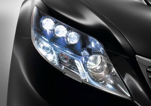

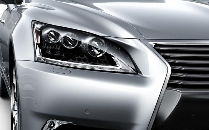

The new Lexus LED headlights are using multiple LED's in each lens and maybe we can double them up or put them in the high beam buckets too. No need for high beams with gazzilion lumens in you other lights. I never even use my high beams as I just use my LED's.
New Lexus LED headlights....
