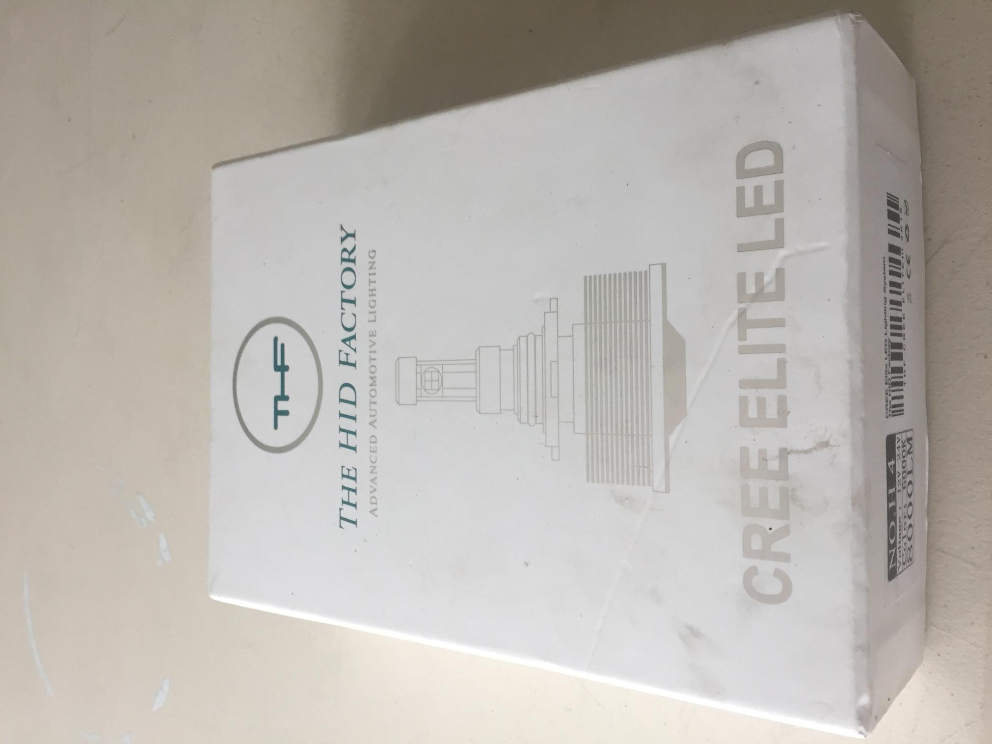

I bought a set of 6000k LED bulbs from the hid factory and installed straight from the box. Everything was wonky, lighting up the sky and the neighbors house but not the road. Pulled them out and on closer inspection found that there were two panels of LED's, on either side of the bulb. Also found a small allen set screw that allowed the panel to be rotated. Based on how the bulb went into the housing, (three tab version), turned the bulb so the LED panels faced up and down, installed. Had the same issue as you, highs were low and lows were high. Pulled for a third time and reversed the panels, finally fixed the issue.
All in all I ended up going back to the H4 bulbs because I just was never happy with the performance in the dark night, never gave me the throw I wanted down the road. 140$ lesson learned.
Also in my research I found that the LEDS work the best with halogen or striated type housings, while I had vision x clear housings. I never went further to see if those housings would have cured my ails.
