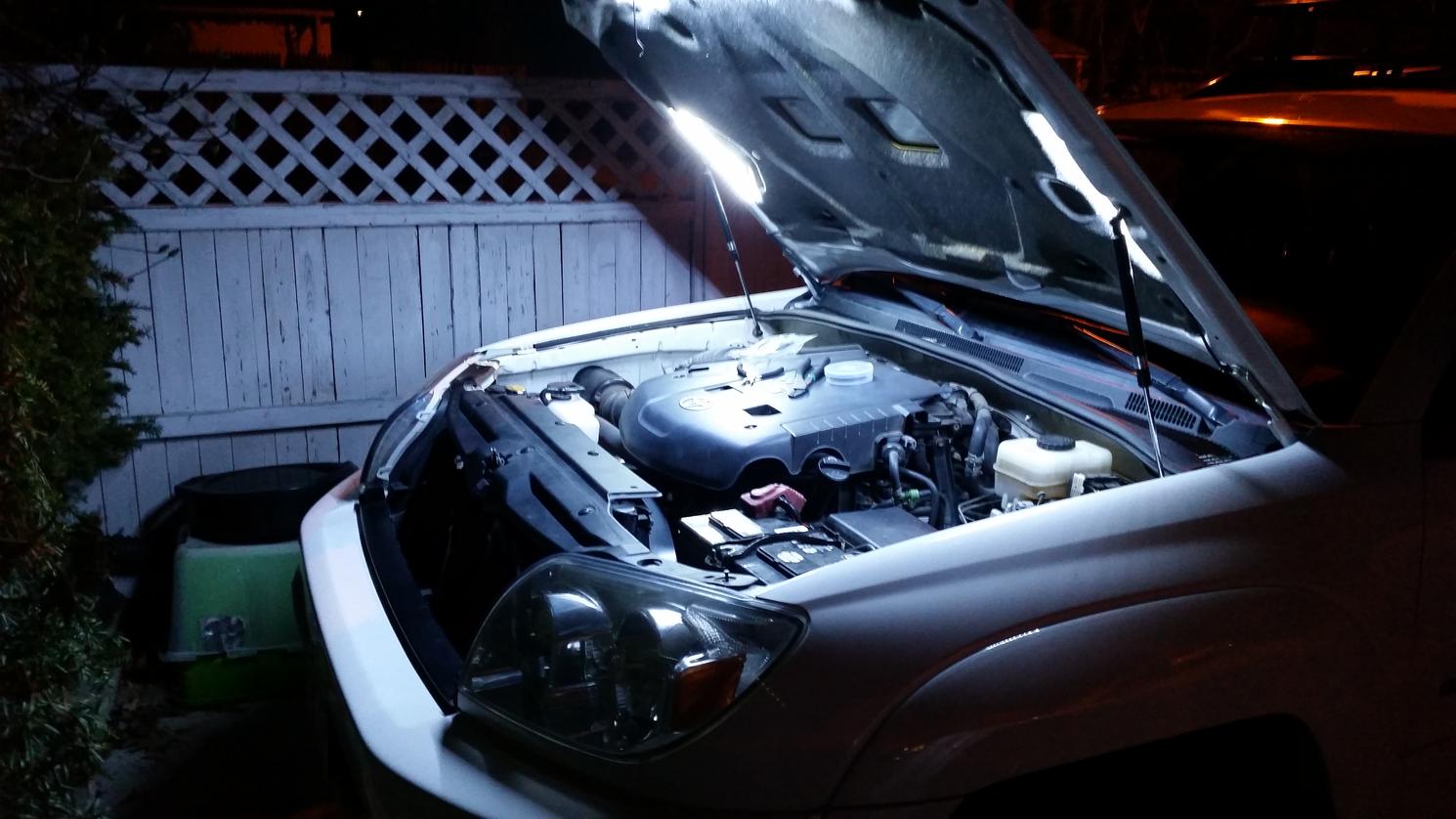

Here is a pic of the hood lights installed. They are crazy bright and extremely well made. I'll post more about the install in a new thread

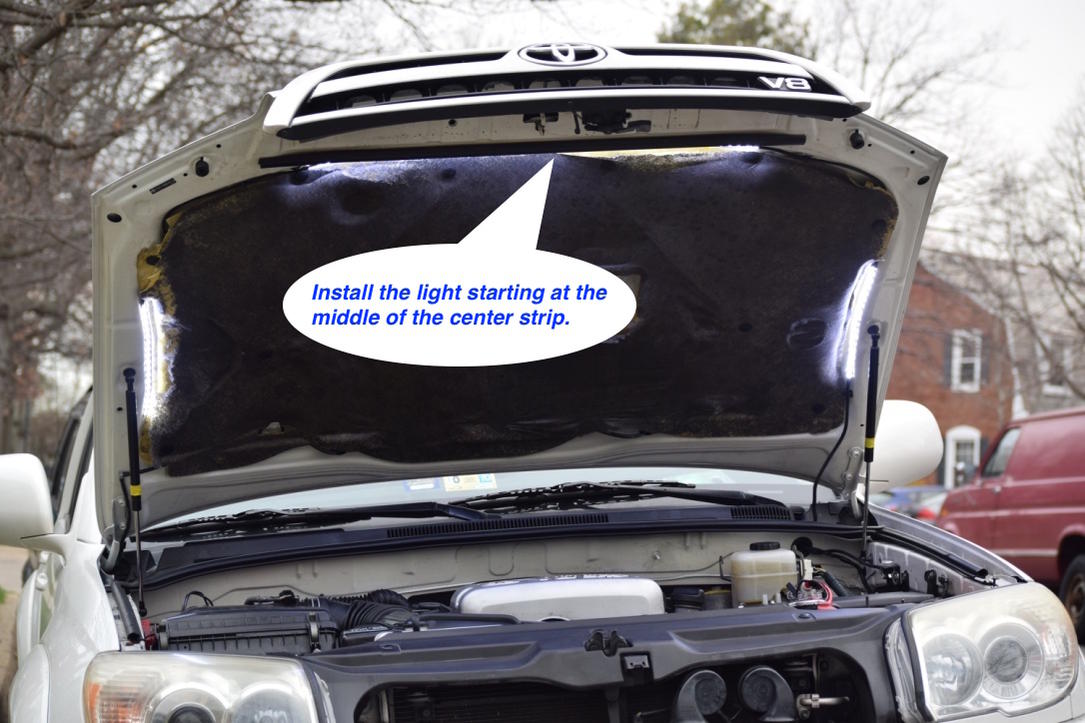

--> Step 3: INSTALL CENTER LIGHT STRIP) -- Locate the center part of the center light. Hold your finger there as a way of marking that spot. Pull the backing off starting at the center, and you can apply the center piece starting from the center of the hood. Pay attention to run it so that your hook up wires will end up on the side of the truck near the battery.

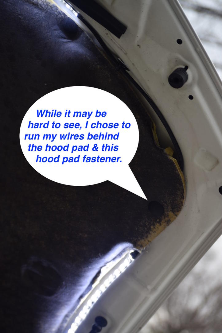

--> Step 4: PLAN AND ROUTE SIDE LIGHTS) Determine how you want to route the wires connect to the two side light strips. I decided to snake them behind the hood pad myself, although based on the length of the wires, it seems that it was intended for the wires to simply go around the edge of the hood. NOTE: I didn't realize that the hood pad will crumble easily. It's almost like well-baked cardboard. Now I know. Don't try to take the pad off, ir fit your hand behind it. If you do go behind the hood pad, use the light strip itself to fish the passenger side behind the pad.
On the driver's side, use the wires, or choose your favorite "fish tape" type of solution, and temporarily connect the wire to it via duct tape or any other suitable means to fish the wire and the light strip behind the hood pad on the driver's side.

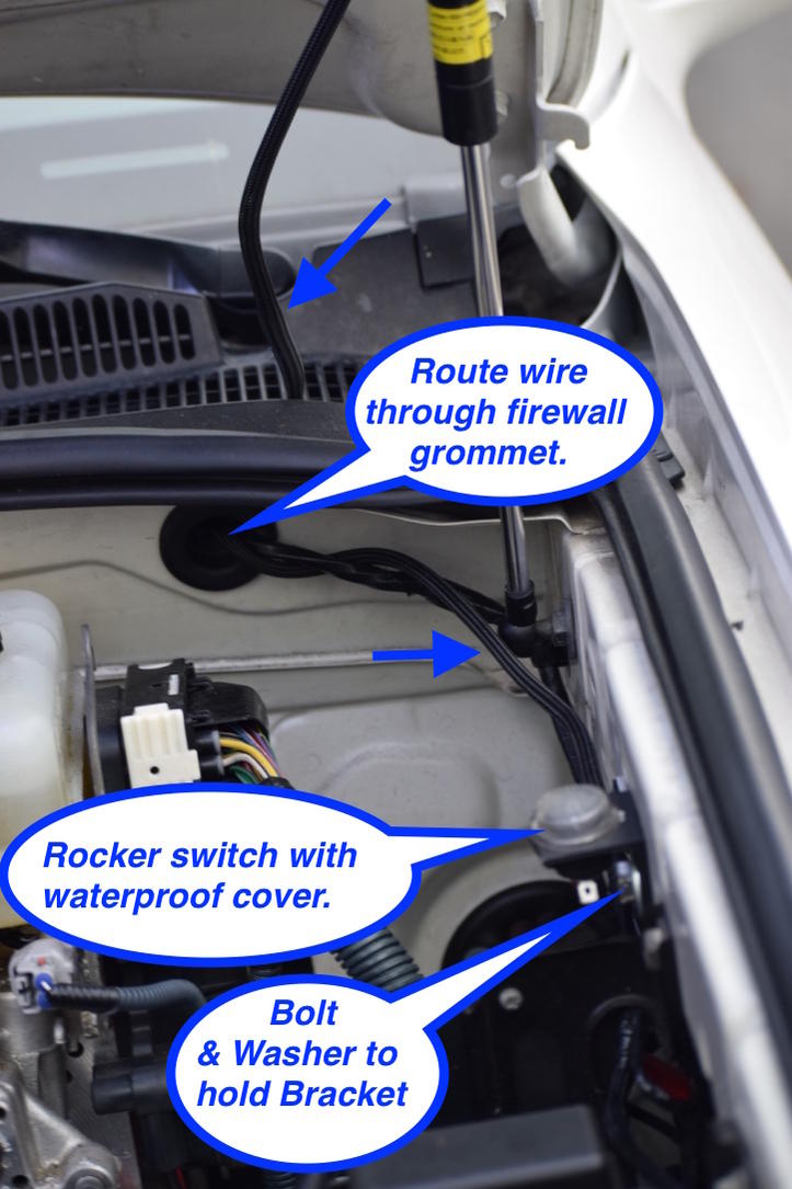

--> Step 7: RUN THE WIRE INTO THE ENGINE BAY )
I decided to run my wire though an existing slot in front of the windshield.
On the driver's side of the firewall, there is an existing wire that runs into that space, and about 1.5" or so rubber plug that the wire runs through. I decided to remove this plug, and run my wires through it too. It was difficult to remove the electrical tape on the back of this plug and not worth it to me to put in the time, so I used a small knife to make a new slit in the rubber, and with some stretching and pulling on the rubber of the plug and some needle nose pliers, I was able to fish the wire and it's looming through the rubber plug. Leave a enough free play so that you aren't straining the wire when the hood if fully opened. Then put the plug back.

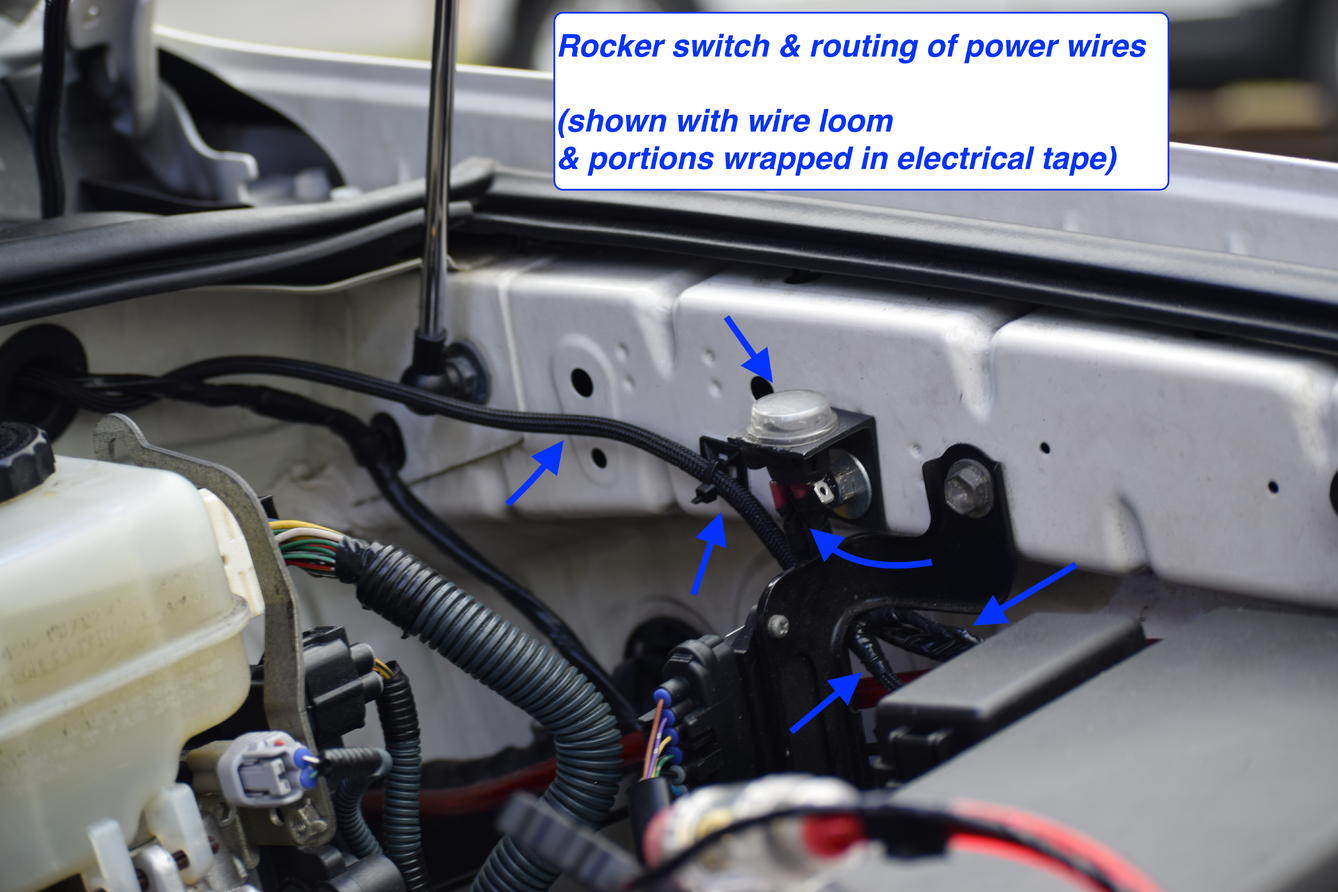

--> Step 10: INSTALL YOUR POWER WIRE & SWITCH)
Simply run the wires straight along the driver's side of the inside of the engine bay. If you do this, the wire looming will easily reach to a good location where you intend to ground the circuit. If you have a switch, you need to make a hole in the looming below the switch, separate the end of the red wire from the black wire, and pull the red end through the hole in the looming.
Now you can leave an inch or two of length on the red wire, and cut it, and attach the crimp on connectors to the red wire. THE CRIMP ON CONNECTORS SUPPLIED ARE A GOOD KIND (they have heat shrink tubing built on to them), but I couldn't use them -- or I was using them improperly. I tried using my crimpers, and everytime I tried it failed to connect the wire. I end up using my own inferior crimp on connectors, and good quality electrical tap to wrap them carefully so they are weather tight.
FOR THE SWITCH ROCKER SWITCH
-- it comes with a nice, water proof cover. I hadn't used one before, so I kept trying to install it the wrong way. Here's the scoop. It's easier than I thought. The water proof cover has a small, split lip around the edge. This split lip fits snugly over the bezel built onto the switch. Pull the two ends of the red wire through the hole, and hook the wires up to the switch -- the center connector and one of the ends, and the gently push the switch into the mounting hole, so that the wires come out the bottom.

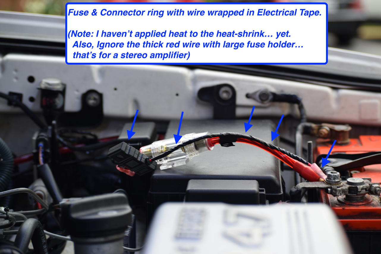

--> STEP 11 INSTALL YOUR FUSE) Cut the red wire on the fuse. I left about one inch of wire on one side, so that their was a longer piece of wire on the other side. Strip a little wire and crimp the ring connector on the the long end of the wire. Strip a little of the other end, and the end of your power wire, and use the crimp-on butt connector to connect these two ends together.
I then used electrical tape to wrap a protective layer around all of the exposed parts of the red power wire. This is just to give the wire's sheath some protection against drying, cracking with age and rubbing.
PUT THE FUSE IN THE FUSE CONNECTOR, route the red wire, and connect the ring at the end to your positive battery terminal.

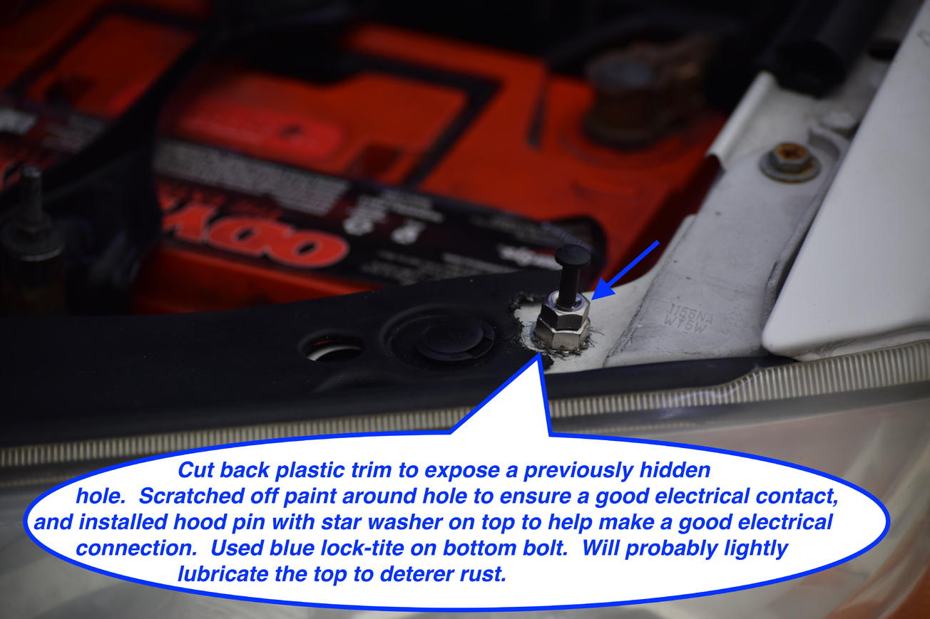

If you don't have a hood pin, then apply the crimp on ground ring, and ground it either directly to the negative side of the battery, or by bolting it to bare metal somewhere appropriate on the chassis.

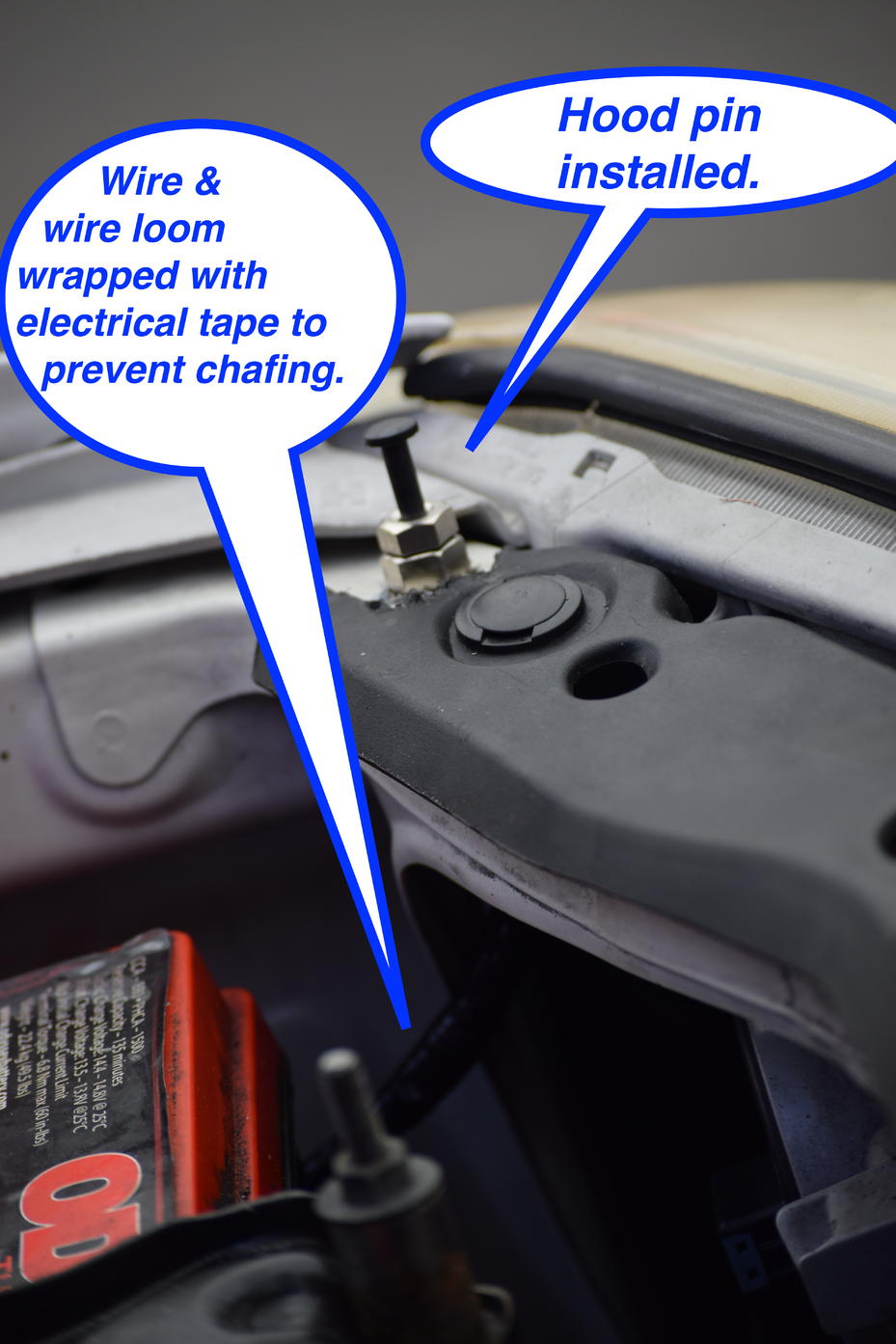

If you have a hood pin switch, find a suitable location to mount it, drill a hole if necessary or otherwise prep the location, and the mount the hood pin switch.
I partially removed the plastic trim along the front edge of the engine bay. I did this by using a small flat blade to pop up two the black "push pin" connectors that held it on. This allowed me to lift up enough of the trim to see what was under it. Near the driver's side edge of the trim, hidden by the plastic itself, there was an existing, unused hole that was a good size for the hood pin switch. I trimmed off a semi-circle from about the last 1 inch of the plastic trim. This allowed access to the hole, even when the trim is re-installed.
I used a small knife, and carefully removed the paint right around the hole, so that the hood pin & it's start washer would contact bare metal.
Then I used blue lock-tite on the threads of the hood pin, and installed the hood pin in the hole, using two sets of pliers to tighten it down securely. (one set to hold the nut underneath, and the other needle nose set to tighten the nut on top that was closest to the truck's frame.
Then install a crimp connector to the end of the ground wire. Use heat shrink or electrical tape to neatly seal the wire looming to the crimp connector, and plug the ground wire connector onto the bottom flat spade of the hood connector. The hood pin will now connect to ground when the hood is open, completing the circuit so that your light can come on, and it will disconnect the ground when you close the hood, turning your light off.
I also looked at where the looming on the ground wire might rub against some metal on the truck's frame, and I wrapped several layers of electrical tape around the outside of the looming for about two inches near the part that might rub.

--> Step 15 TEST YOUR SYSTEM & FIX ANYTHING YOU MISSED )
Test your system. With the hood open, the light should be on. If you have a rocker switch too, in one position the light should be on when the hood is open.
In the other position, the light should be permanently off. When you close the hood, make sure that the hood pin turns off the light by disconnecting the ground.

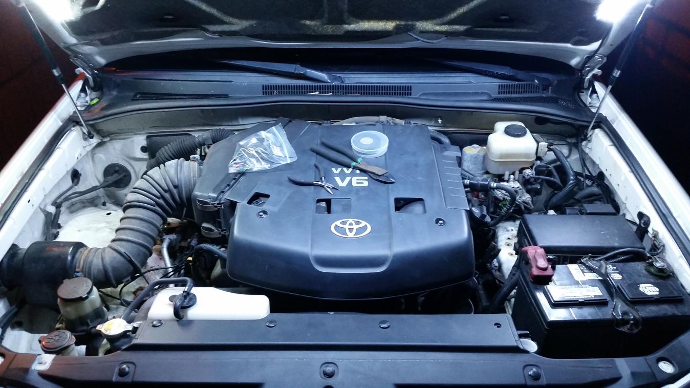

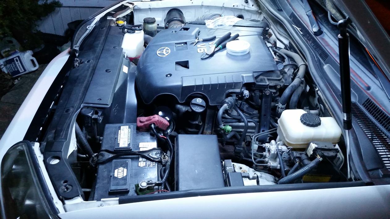

Kit installed
I was lucky to be able to help with some beta fitting.
No doubt as the others mentioned this is a stellar kit and the output is just perfect for most anything you would need to do under the hood at night.
This is on a 2005 SR5 V6 4wd...you may have different holes or things depending on year.
Pjbrownva covered most of the details in his post...just make sure to wipe it all down and then use rubbing alcohol to clean residue from the led strip areas.

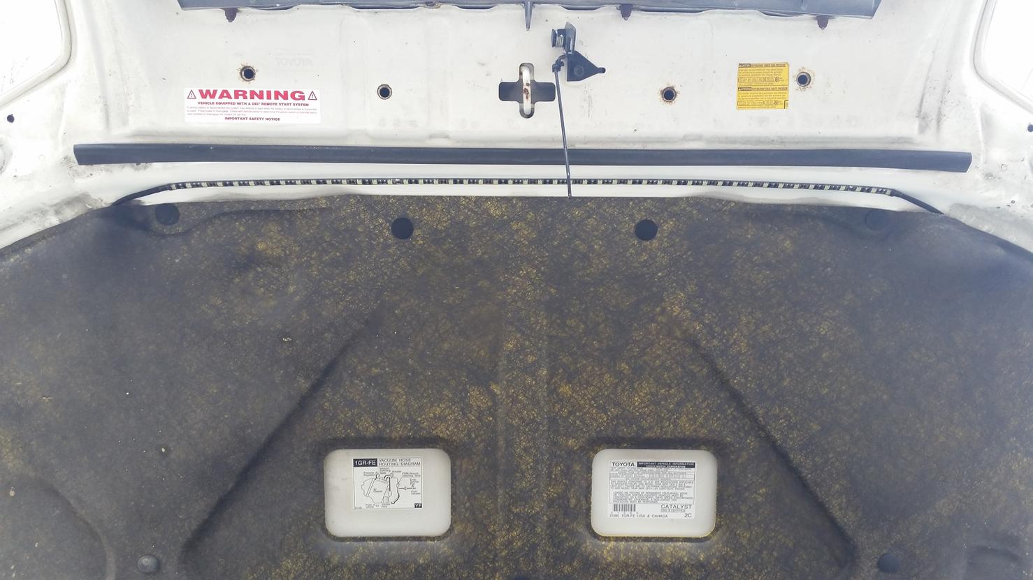

Instead of the starting in the center, I start at one end of the strips and peel back just a bit of the sticky back paper and then press the strips on removing the paper as I go little by little.
LED strips are the perfect length.

I laid everything out and sort of test fit to make sure the lengths were all correct and then started by applying the passenger side first. Then just stuffed the wiring up and behind the hood matting. If your under-hood mat is still in good shape do not touch it or try to remove it. It will crumble. The wire loom will sit between the mat and the hood no problem without need any sort of tie-down (at least mine does)
I left some sticking out in this photo so you can see how it fits nicely in there.

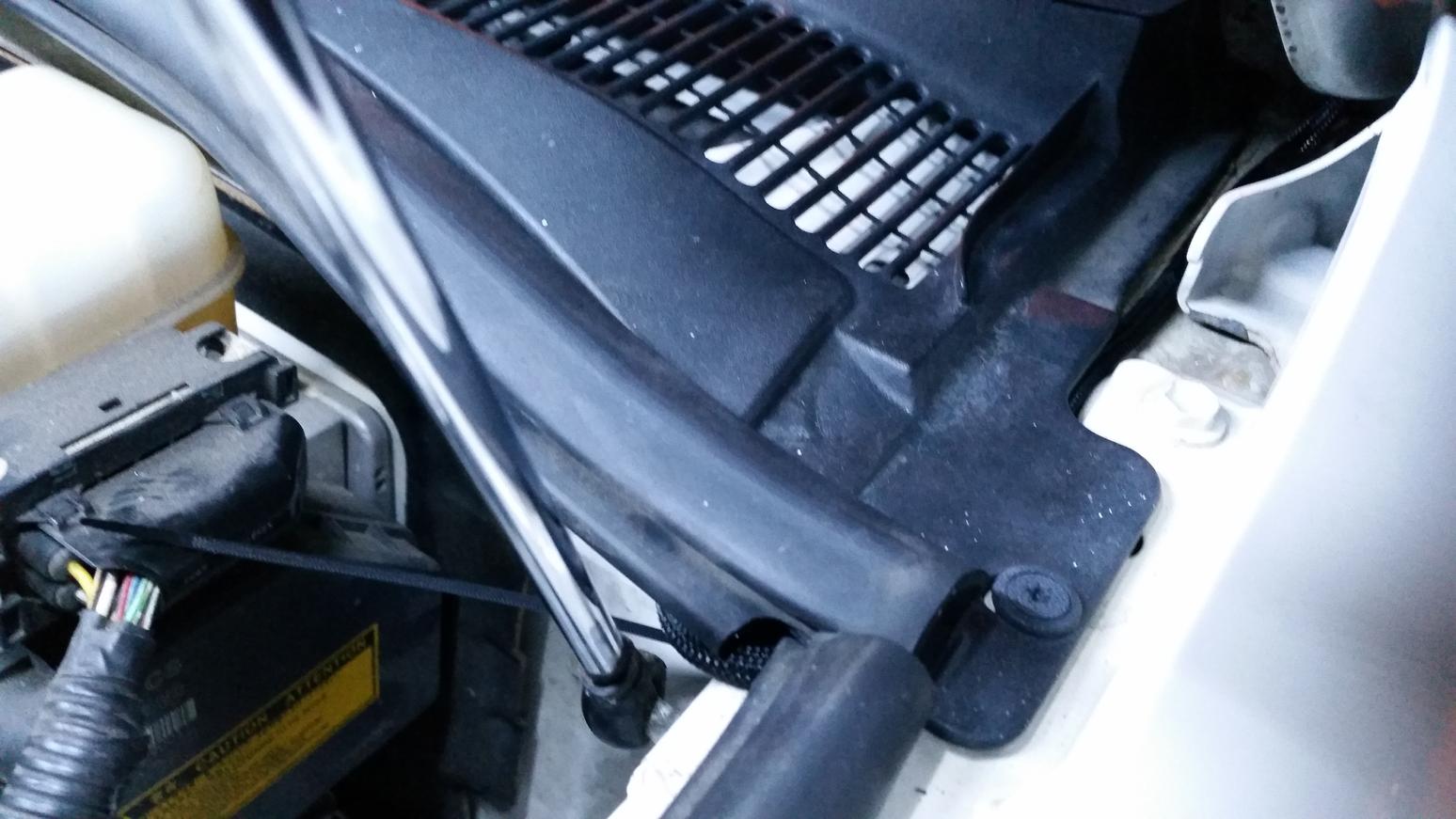

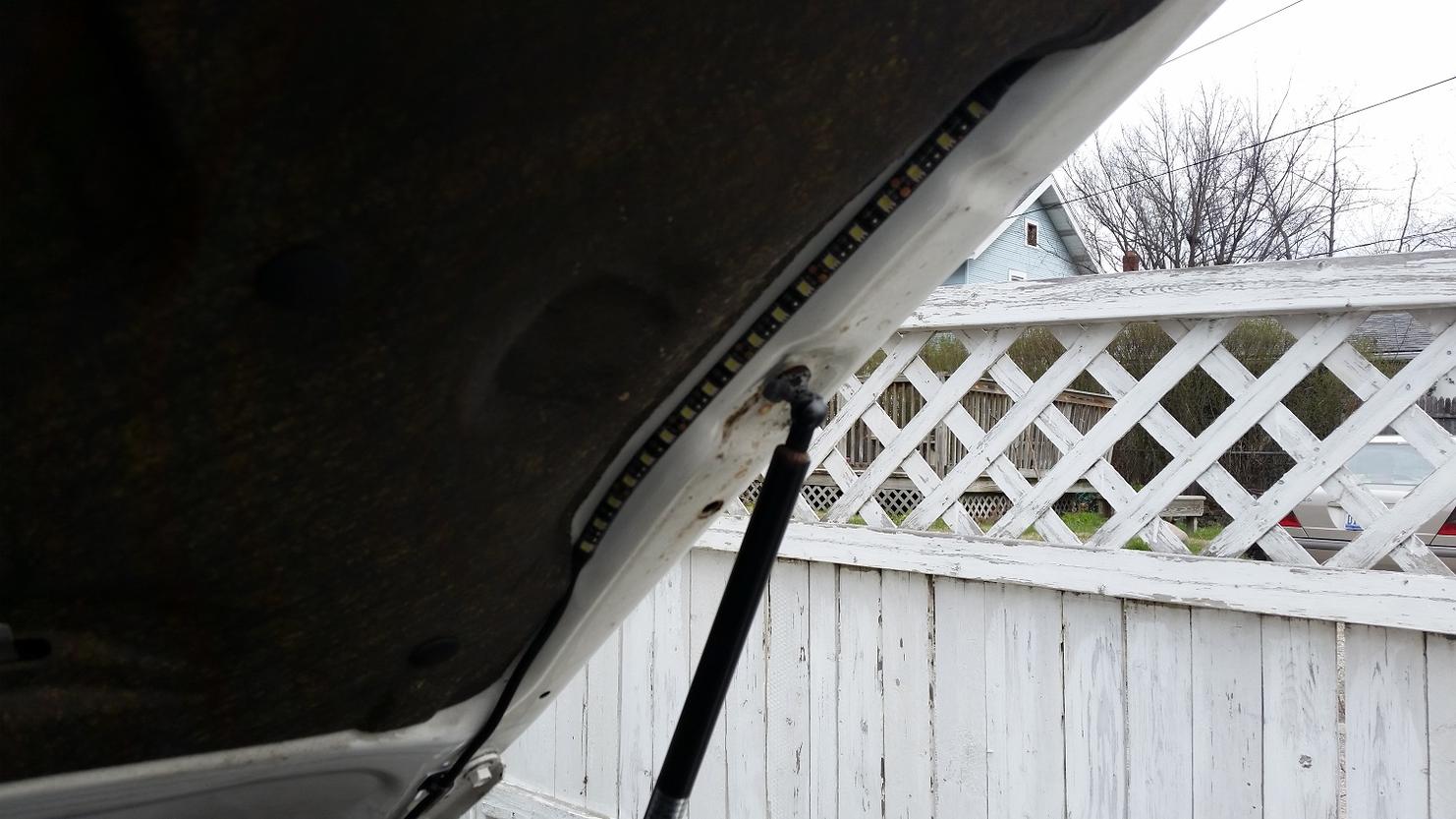

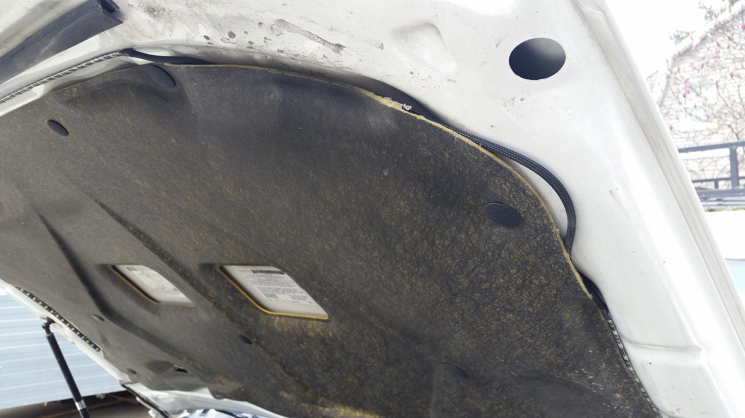

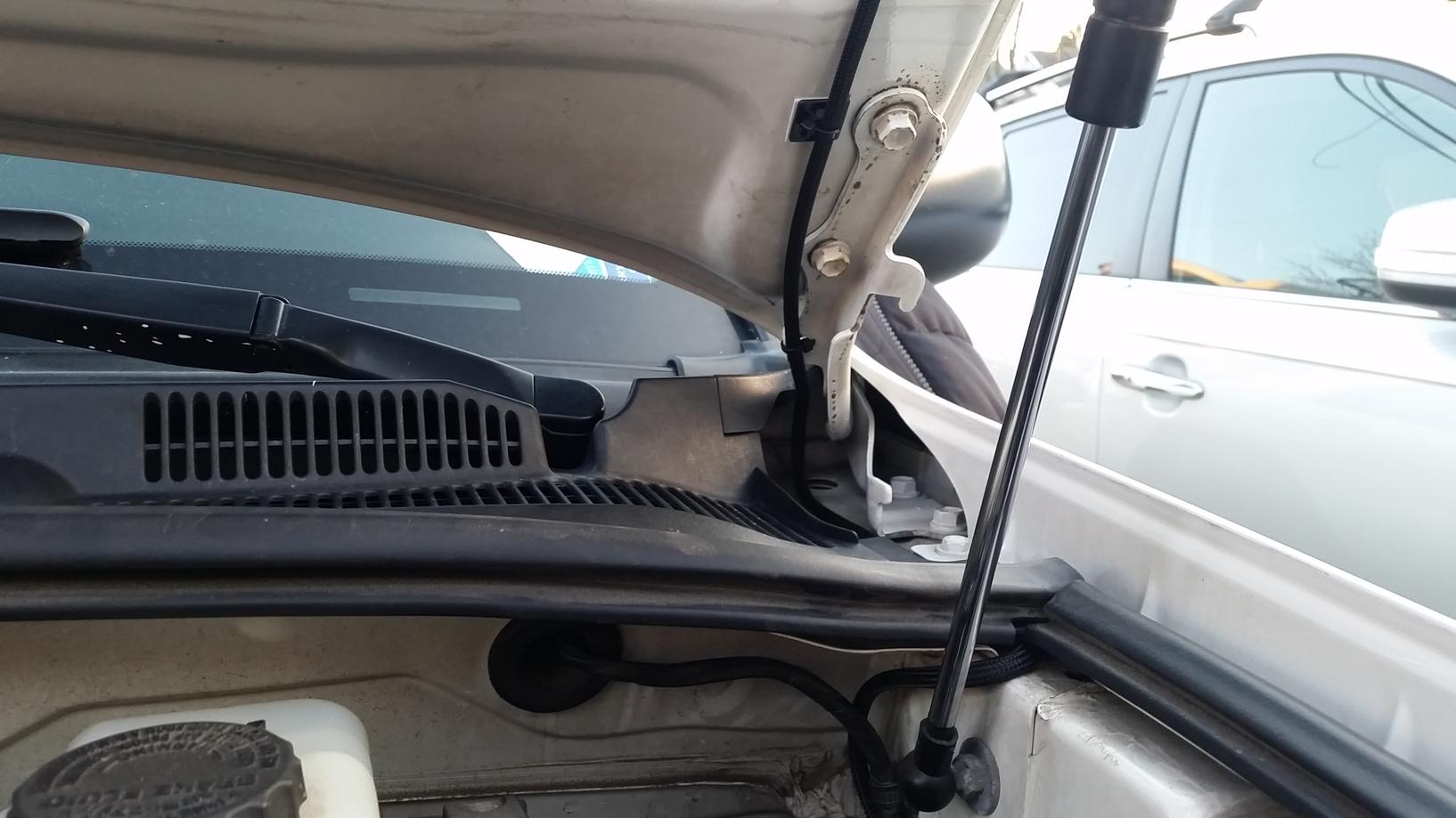

After the strips were installed I routed the loom down along the hinge using one of the sticky back tywrap tie-downs and a supplied zip-tie to an existing hole in the hinge then was able make a large radius bend and bring the loom back toward and into the engine bay.
I thought about going through the hole behind the hinge a little closer to the A-pillar and then routing it through the wiper motor area and out the rubber plug in the firewall but did not feel like removing the plastic grating/cover and/or fishing it all through.
I was able to just route it under the drivers side edge of the plastic cover and hood gasket then wrap it back behind the hood strut and down to a factory loom along the drivers side inner fender. There is actually a sheet metal bend in here that the wire loom sits under to help protect it. Can't see it in the photo but it's super easy to just lift the edge of the plastic cover and feed the end of the loom through and out into the engine bay.

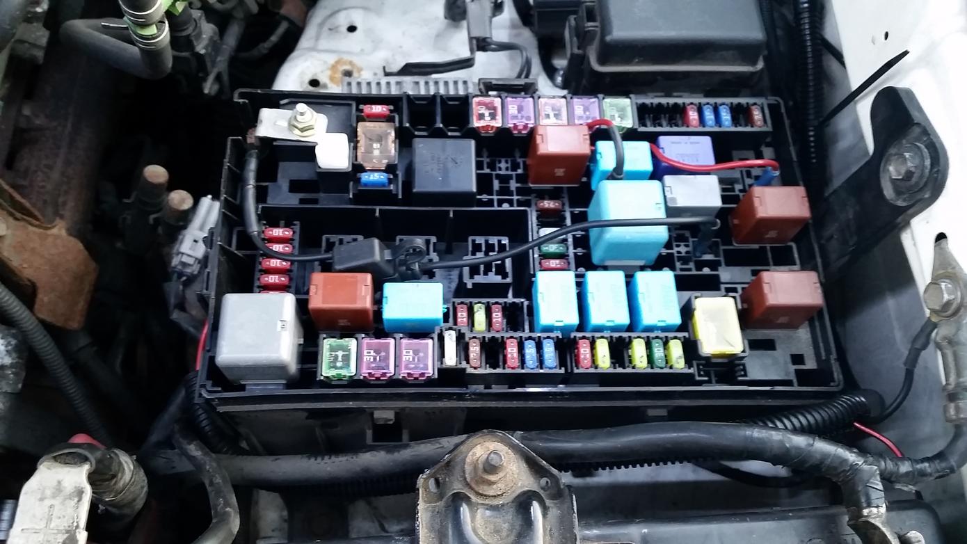

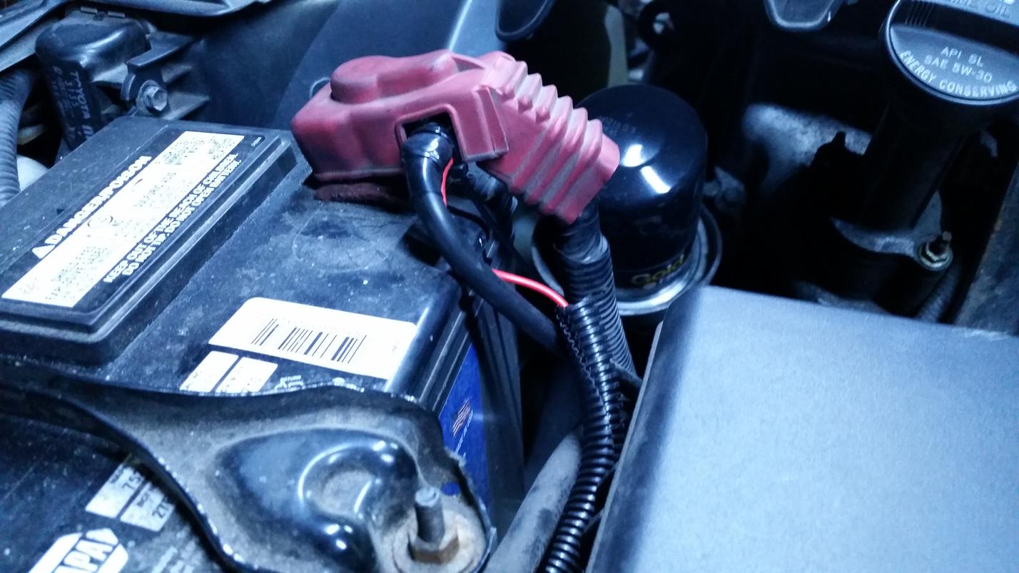

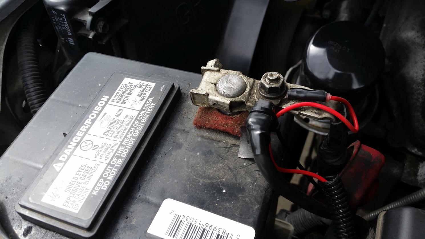

From here I just followed the factory wiring using tywraps to the battery and made my connections.
Initially I connected my red +12v directly to the positive battery terminal as designed and it works great. I used some electrical tape on the ring terminal here since I got the the heat shrink too hot and it split...totally my fault wasn't paying attention and using a too large of a torch.

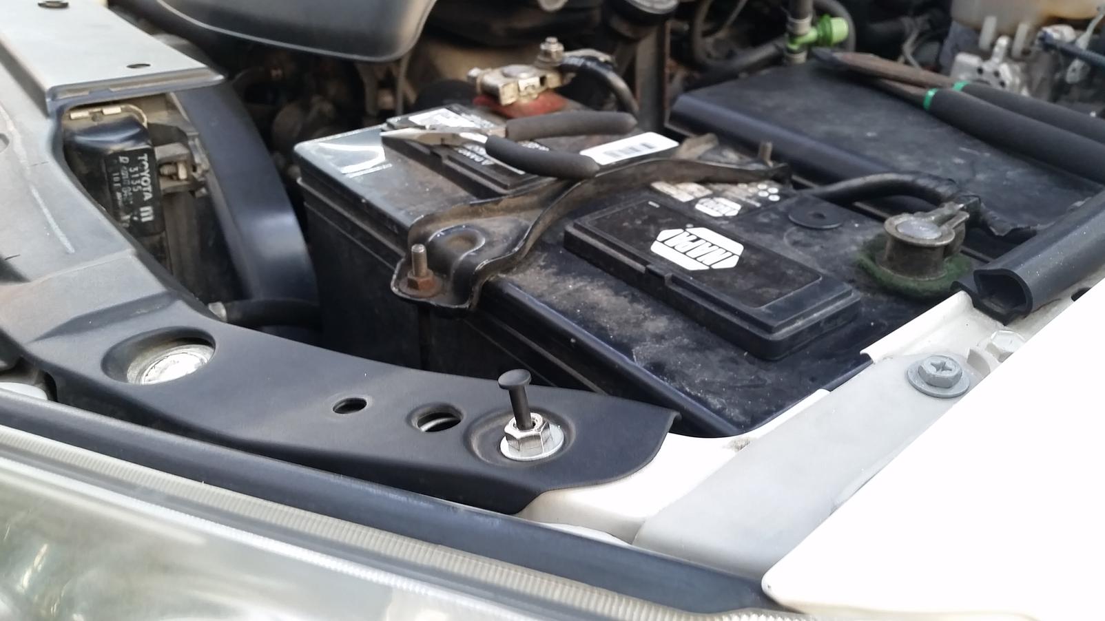

The hood pin switch is easy as pie to install. I popped out the little factory plastic hold down for the upper radiator support cover trim and installed it there. I tried it in a couple of the other holes here but didn't like the interference with the headlight directly beneath it. In this hole the pin switch is angled just slightly to avoid hitting anything and you don't have to cut or drill any additional holes. Choice!
I had to use a washer on top because the hole in the plastic is oversize, but this switch is sitting directly on top of the sheetmetal with the star washer and one nut to tighten it all together underneath. The pin switch comes with 2 nuts so you can adjust the height of the pin switch but I found that it was not necessary in this location to try to raise the switch up.

Output shots. These lights are just right. Photos taken at night.
Front
Side
Side again
A close up to show with lights on
So, in my previous post I showed the red +12v wire attached directly to the battery post. Being the perfectionist, anal retentive person that I am I wanted the fuse holder and wiring to be hidden so I put it in the factory fuse box. This is not how the kit is designed, this is just my mod to do it my way.
I just pulled power from an empty spot in the fuse box with a spade connector and ran the red+12v wire up where the alternator ( I think it's the alternator wire) comes into the fuse box from the engine. The other red wire in there is for the '12v on all the time' mod or maybe it's the fog light mod, I don't remember.
