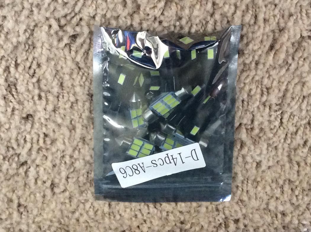

Wow...these LED's arrived early and fast. With that said, they are stuffed in a sealed baggy. I'm hoping to install later today!!!
