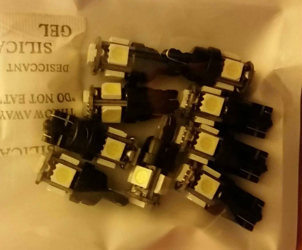

Wow...these LED's arrived early and fast. With that said, they are stuffed in a sealed baggy. I'm hoping to install later today!!!
So...now I'm a little bummed and disappointed with these LED's. Price was great, but quality has been iffy. 2 dome lights flickered (replaced with extras and have worked fine so far) and now my license plate lights (different bulb and no extras) are flickering. I've tried to contact seller 3 times with no response.
Color is good, quality is suspect, and customer service is bad. Has anyone else experienced these issues? Thoughts?

Mine are doing the same exact thing, dude. Same bulbs, too.
Bought and installed. Had trouble w two lights but I bent the wire at the bottom so it catches both sides on the metal socket. Works fine. Looks good.

Pay attention to the polarity. If a bulb doesn't work out of the bag flip it around.
I also remember having to be careful with the prongs/leads on the car side. If the bulb is a loose fit you might have spread the leads too far out but a slight adjustment in the opposite direction to ensure a tight fit might be necessary. Just be careful not to break your leads.
