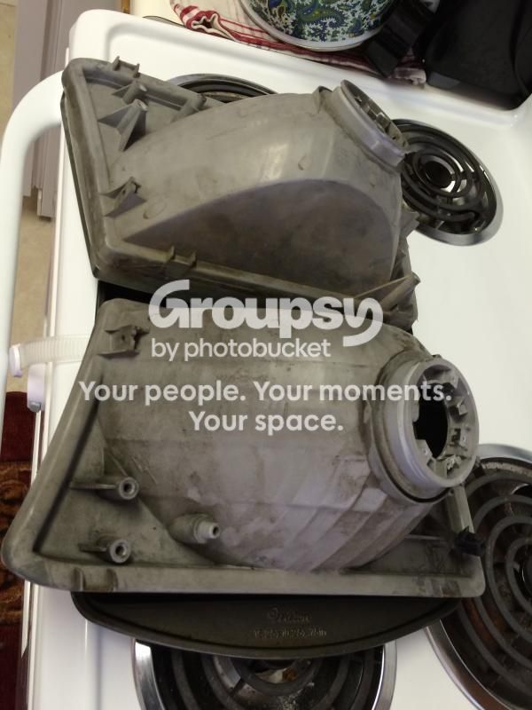

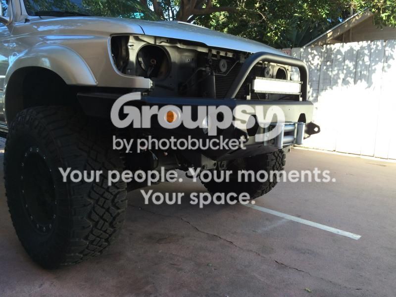

the start..
headlights out ...

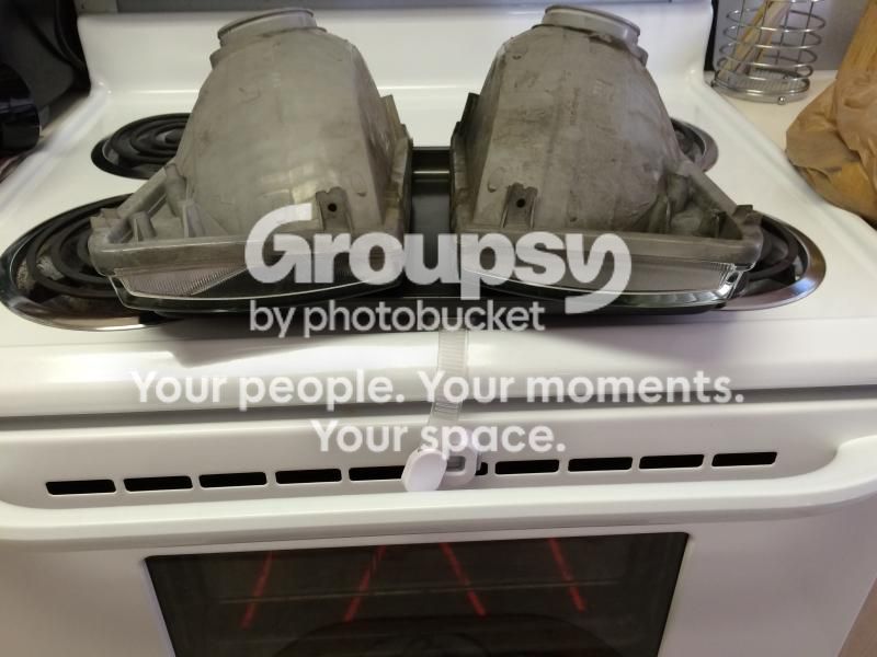

preparing for baking...

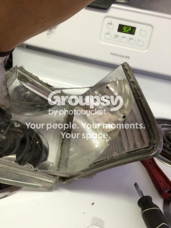

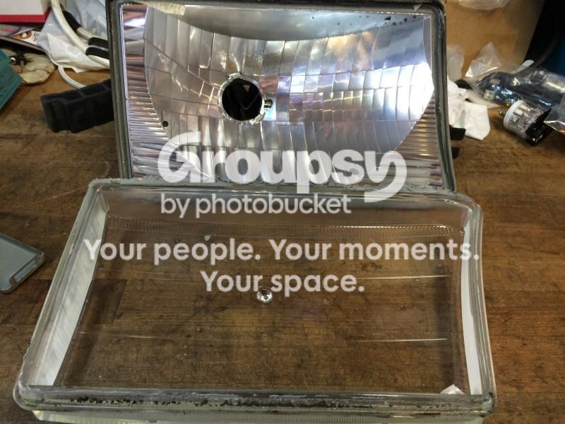

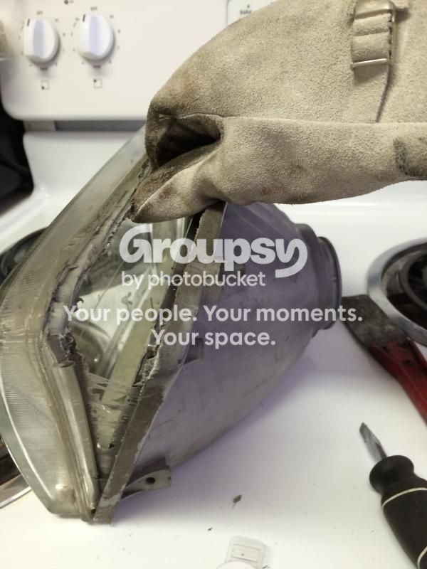

and done and ready for pulling apart...

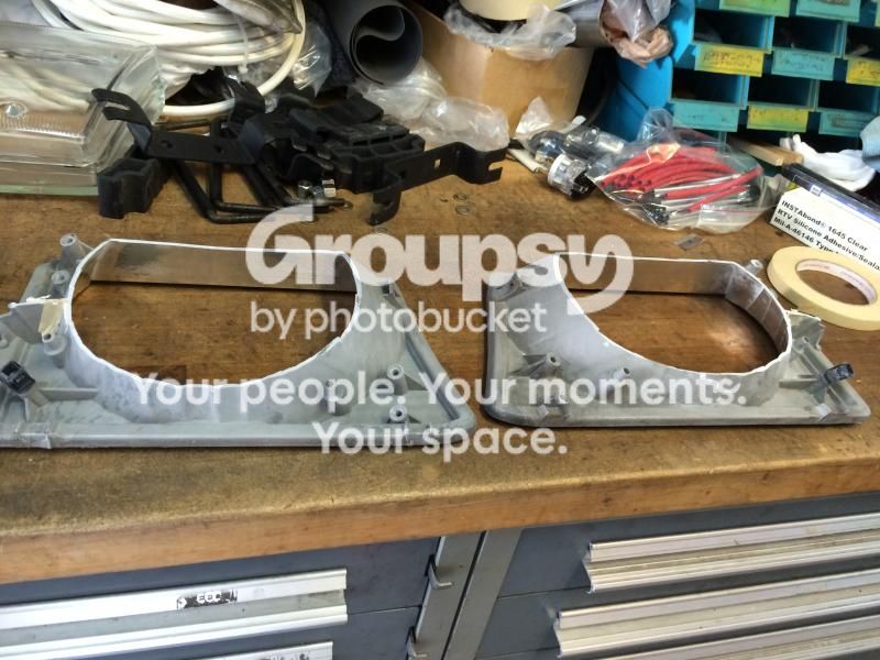

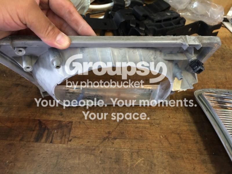

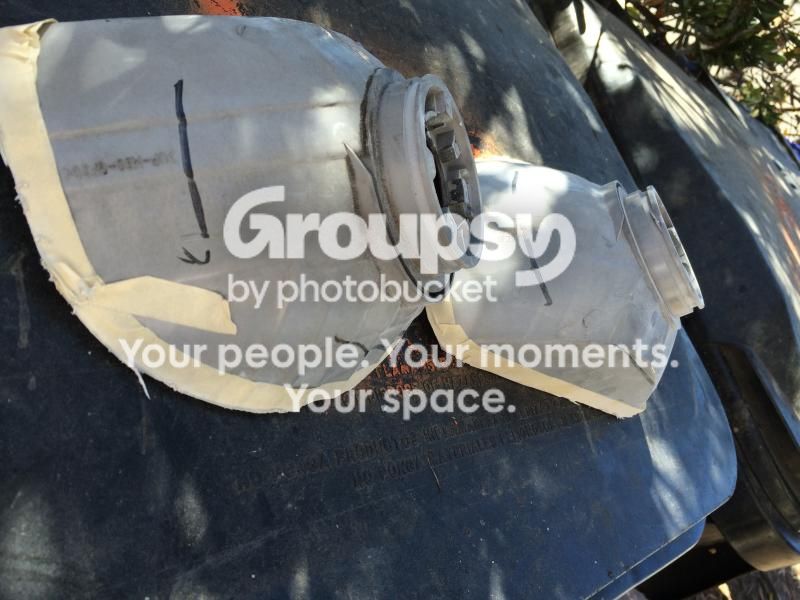

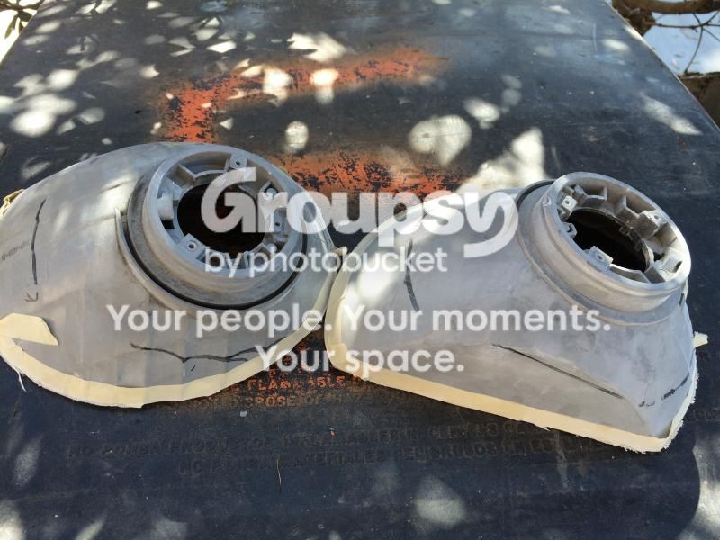

cutting ....

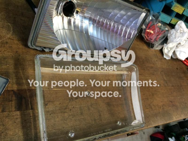

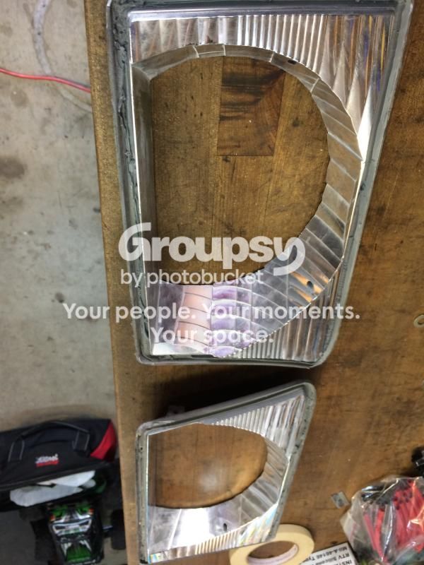

cut....

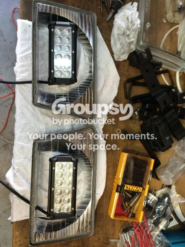

and mocked up before little more prep work and paint. i do also have to cut a plate to mount the lights in. i will be using sheet of plastic/ abs material and after cutting the hole for the light bar to mount in, i will attach it to the light housing. more pics later.

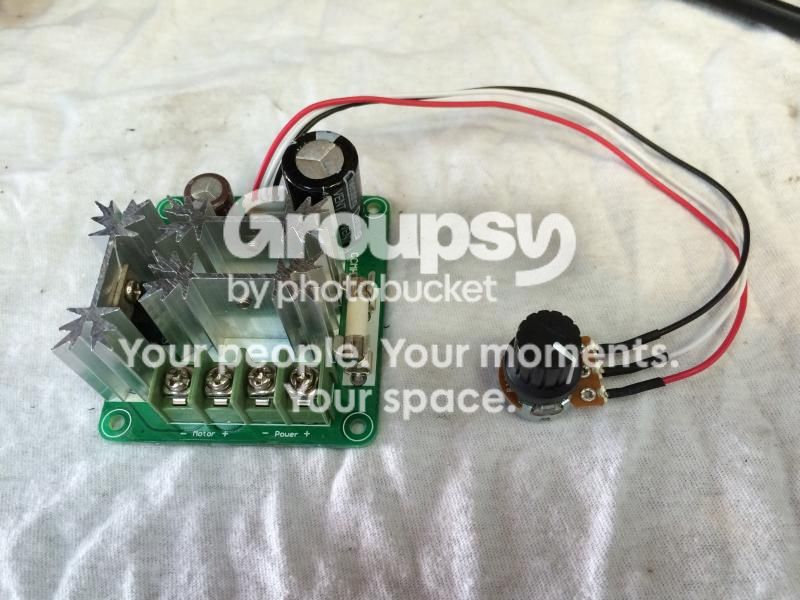

this is the PWM dimmer, dims from 10 percent to 100 percent.

man this was a job! still working on it. Mocking all this up to look right is a job. angles and such. got templates done and gotta get some ABS or some kind of plastic to start cutting and fitting them in. Stay Tuned fellas...
