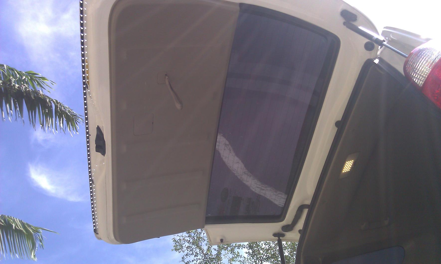

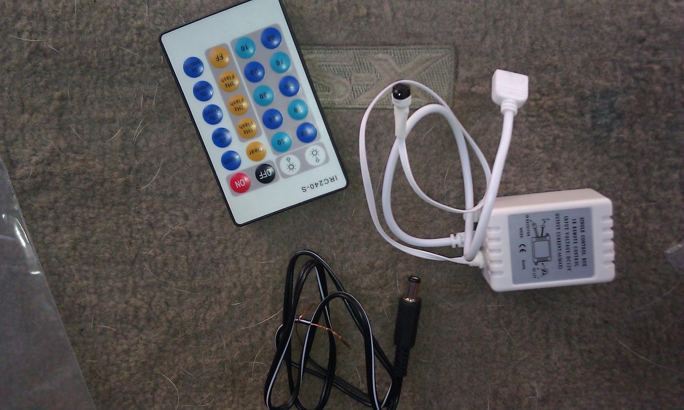

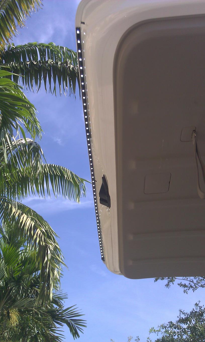

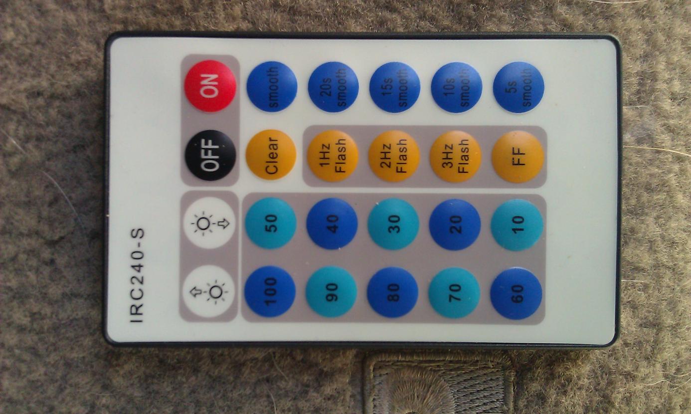

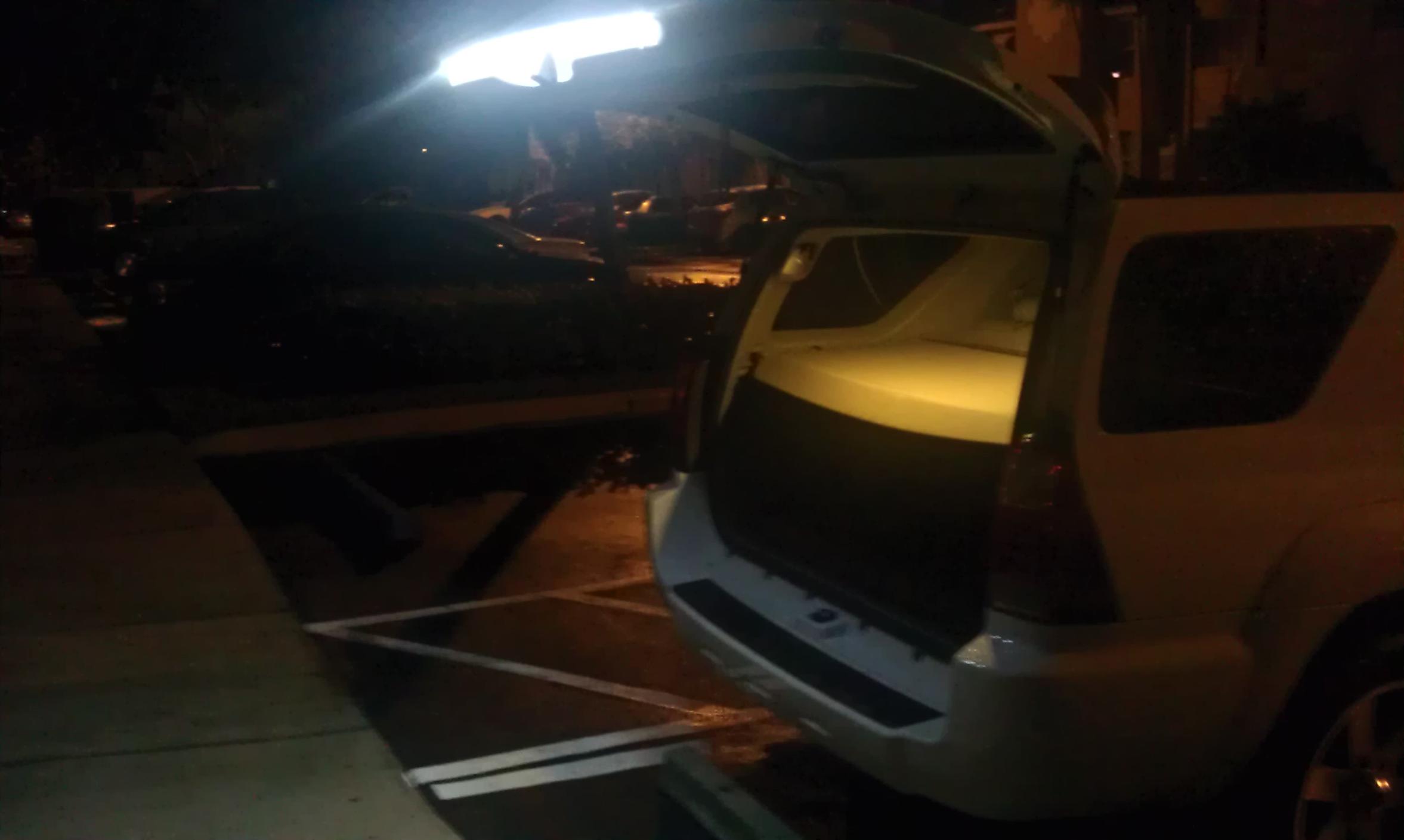

Ive been thinking about doing this for awhile now.. I always thought it can be a very useful mod. Thought about you offroad camping guys n gals when i did this. Either way i currently wired it to the dome light but it can be hooked up to the remote control as well. I used a 4ft strip and i had to extend the plug from the end of the strip so it could reach to the dome light. The connection comes from the driver side through the drain hole and goes up inside the hatch through the factory rubber thingy there that goes to the body and then to the dome light.... I like to keep things factory as possible when it comes to wiring. Enjoy!! If you have any questions ask away...

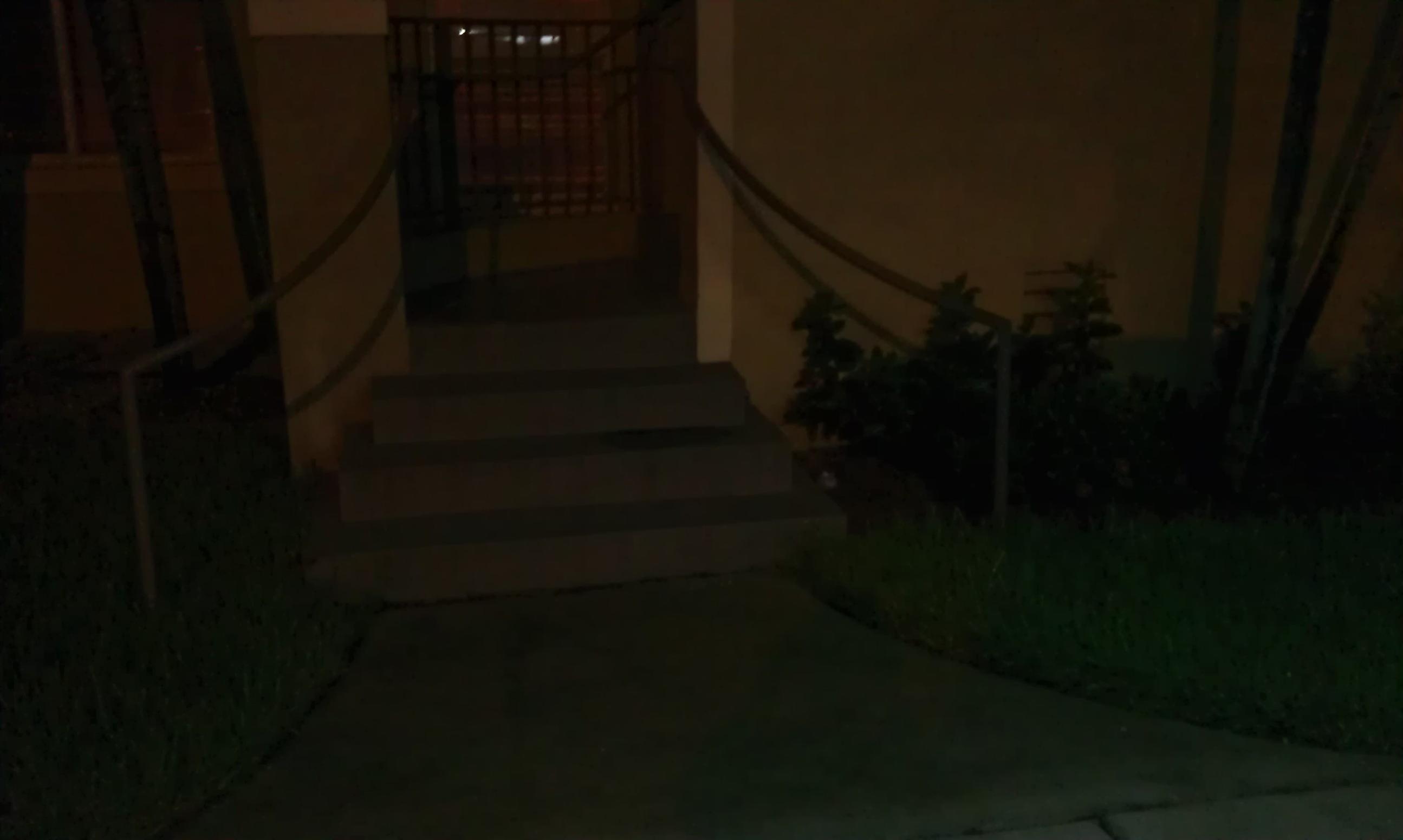

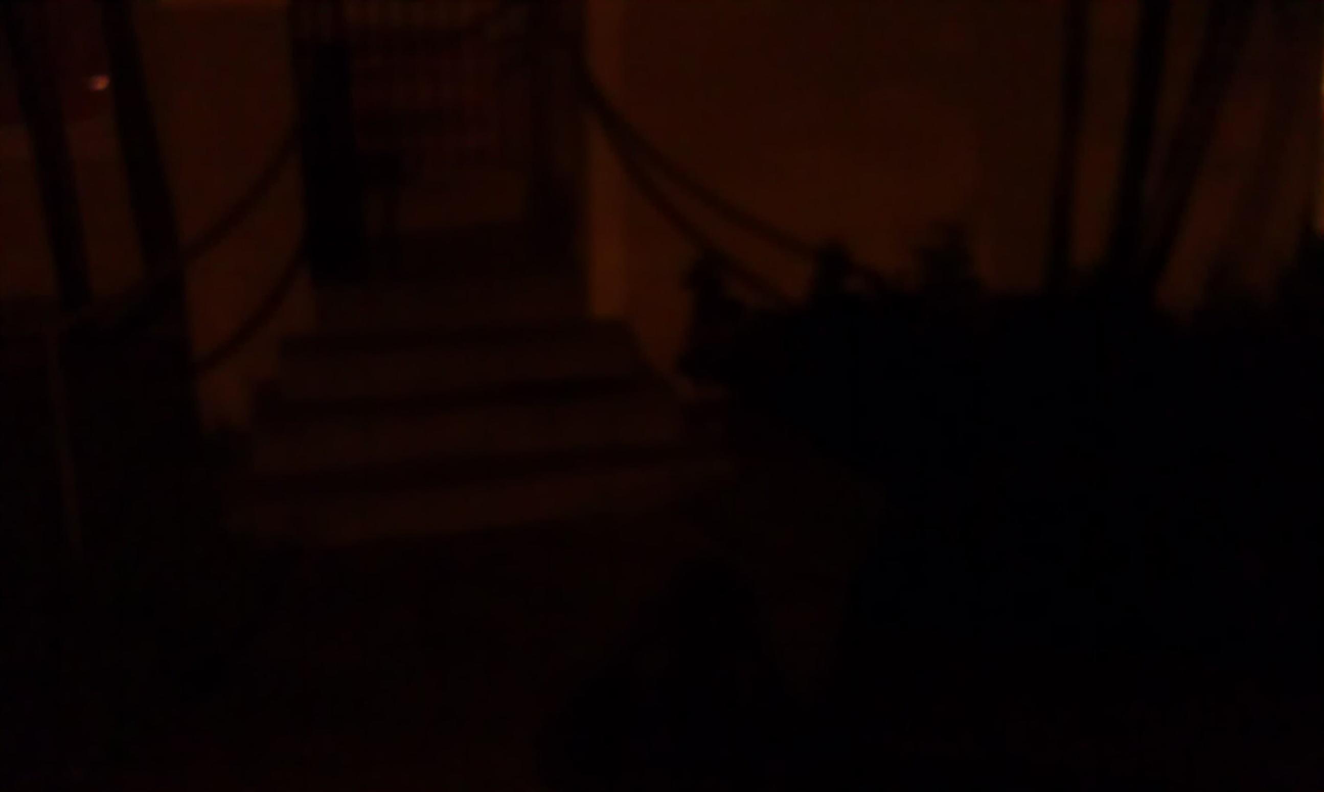

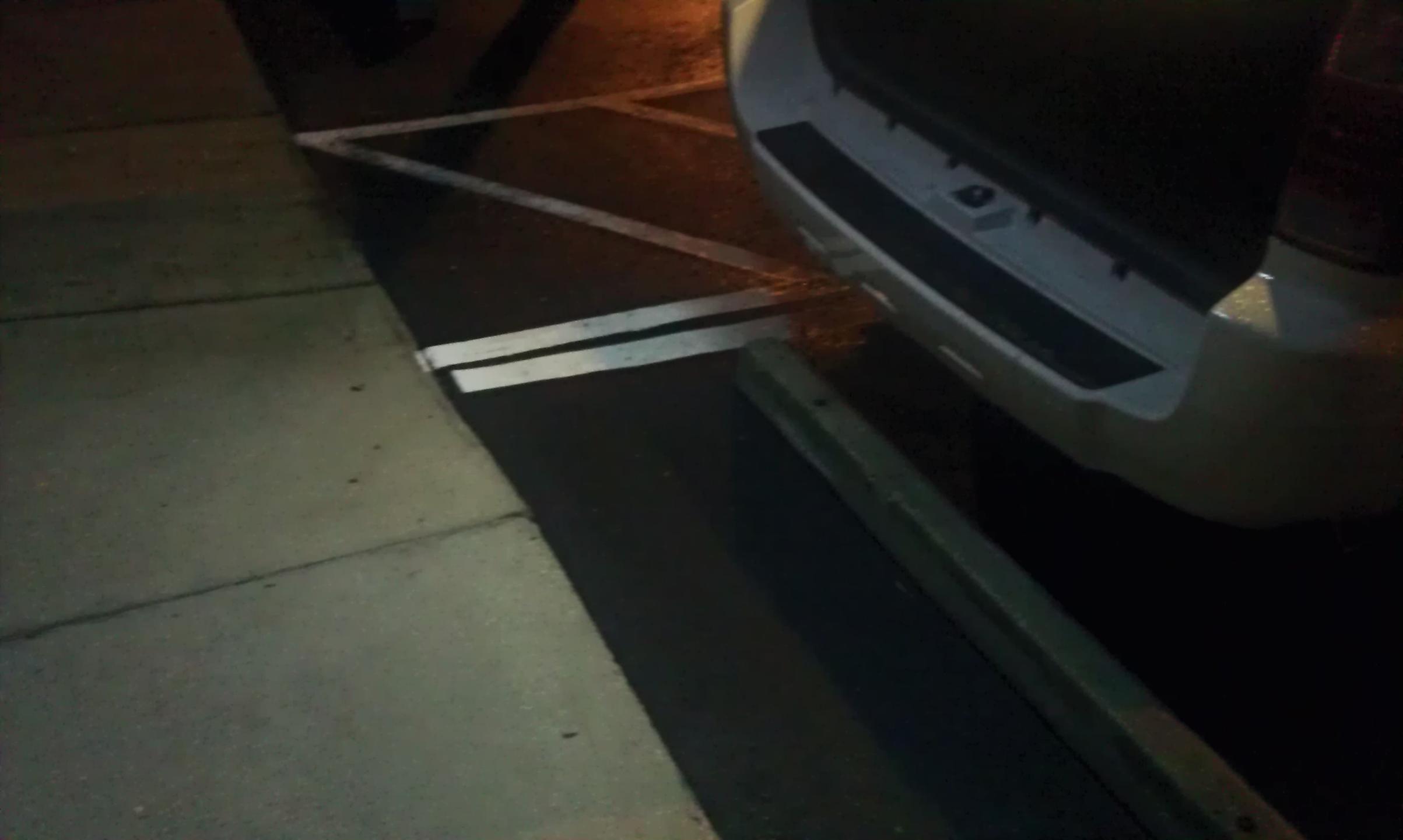

The last picture is about 15 to 20 ft back.

Led strip looks good, from what I can see. Try re-sizing the pics. The second pic is the only one I can make out.
