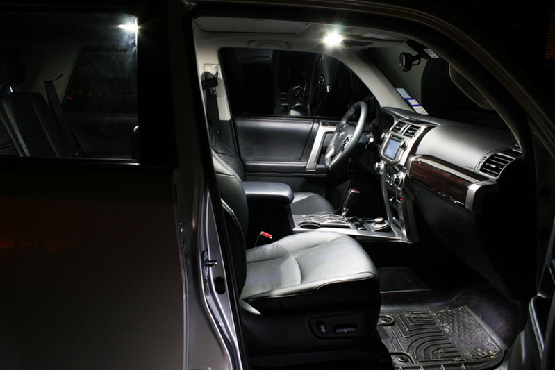

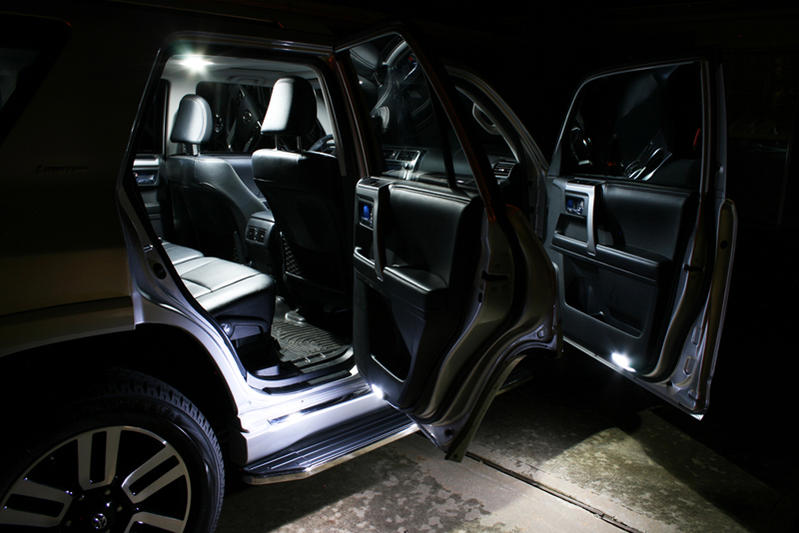

Hey everyone,
As soon as I got my 2014 LE, I knew I wanted to do the interior LED swap + puddle lights + license plate lights. I read many threads here and watched several videos where I found a lot of very helpful information. However, I never found a single thread with all the information neatly contained in one place. So I decided to post my entire process, products and final pictures in this thread.
Lights
The premium set from Precision LED seems to have everything you need (tools and premium lights). However, I did not want to spend $150+ for something that could be purchased for $30 elsewhere. So I decided to keep looking. First, I ordered a set from Amazon that was not nearly bright enough. Then I ordered a set from eBay that was brighter, but were not the exact color I was looking for.
Finally, I found these:
If you have a 2010 - 2013 5th Gen:
13 Pcs Deluxe White LED Lights Interior Package Kit for 2003 2012 Toyota 4Runner | eBay
If you have a 2014 - 2015 5th Gen:
http://www.ebay.com/itm/28156270827...r&_from=R40&_sacat=0&_nkw=281562708274&_rdc=1
This was the only listing I found that shipped from the US and included a set of “luxury” lights. I did a lot of reading on LEDs and decided that as long as you purchase an SMD of the newer kind 5630 or 5730, you should be OK. The eBay set listed above includes the 5630 chips. These are super bright and a nice 6000K pure white color. The other sets I returned had the 5050 chips and there is no comparison. The 5630 are truly three times brighter just like they claim. This is the list of parts that you need (at least for the 2014 LE):
A total of 12 “T10” lights and three “31mm” festoon type lights
Map Lights (2 x T10)
Dome Light (1 x 31mm)
Door Courtesy Lights (4 x T10)
Vanity Mirrors (2 x T10)

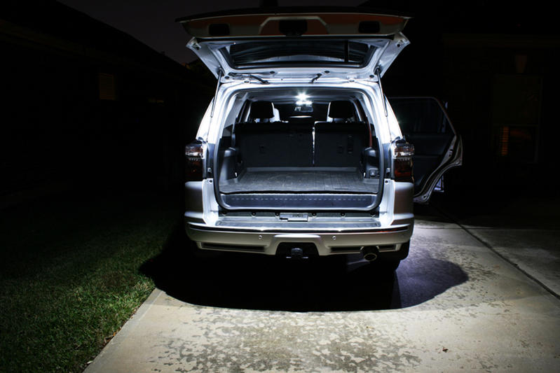

Trunk Rear Hatch (2 x 31mm)

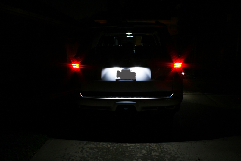

License Plate (2 x T10)

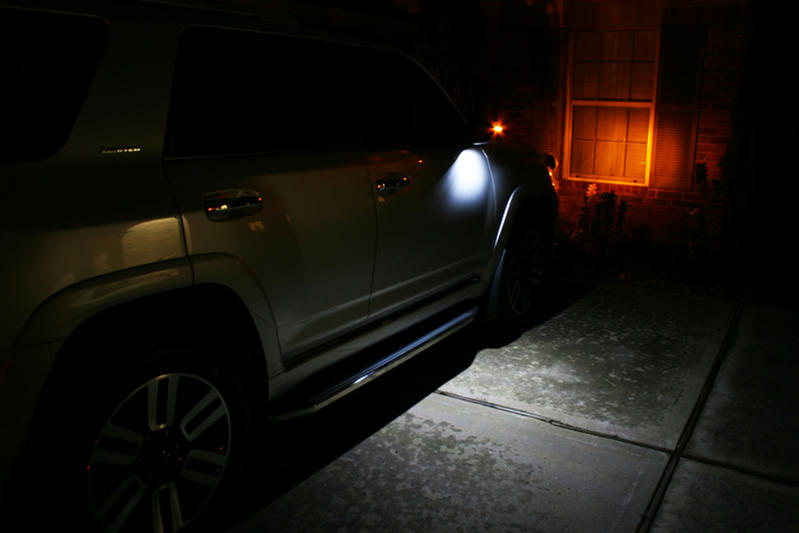

Side Mirror Puddle (2 x T10)
Tools
Since the eBay set did not include any tools, I ordered the set from Amazon linked below. It includes four different hard plastic bars that seem sturdy enough for this purpose. You could use a screwdriver or some other tool, but since these are just $5 bucks, I decided to get the tool set and do it right. That way you avoid breaking or scratching something.
Amazon.com: KINGLAKE® Portable 4Pcs Auto Car Radio Door Clip Panel Trim Dash Audio Removal Installer Pry Tool: Automotive
Installation
My two main sources for installation instructions were the Precision LED YouTube video and the thread linked below. The video is pretty good, except for the side mirror puddle lights, that is where I used the t4R thread instead. The guy on the video removed the side mirrors which I felt was not needed at all. The post by ROSBCOOL in the thread explains with pictures how to access the bulbs without removing the mirrors.
Toyota 4Runner LED Install - 2014 5th Gen DIY - YouTube
http://www.toyota-4runner.org/5th-gen-t4rs/162994-2014-side-mirror-bulb-access-2.html
The dome light is a pain in the neck to fit. The festoon lights is too long for the space in the 4R. I found this to be the case on all three sets that I ordered. In the end, I was able to fit the bullet at an angle from front to back and from top to bottom. It took me a while since I’m a bit OCD about these things, but I think that it feels pretty secure the way it turned out.
Pictures
The lights turned out to be the exact color I was looking for. The rear hatch lights are super bright and the extra brightness in the trunk and the floor around it is especially helpful. Also, I really like the look of the white light in the license plate and the puddle lights.
I hope that anyone thinking of doing the LED swap finds this thread helpful. It’s an extremely cheap and easy mod to complete in less than an hour. Go for it!
