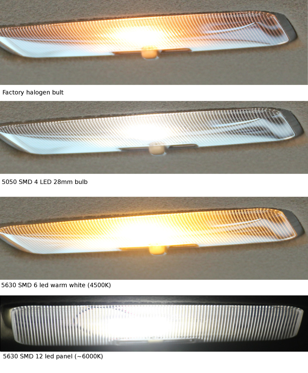

Ok, I tested a couple of different bulbs in the dome light today. Unfortunately, I broke the one that came with the kit trying to make it fit better and ordered the wrong replacement. But the results are still useful. These were all taken with the camera set to manual for everything (iso, white balance, shutter speed and aperture. And all were taken within a few minutes of each other so exterior conditions remained the same.
My conclusions. The 5050 bulbs seem to have about the same brightness, just different color temperature from the original halogen. The 5630 bulbs are definitely a lot brighter and the "warm white" 4500k bulbs are a close match for the original halogens.
The 28mm bulb fit much easier but I didn't have too much trouble with the 31mm bulb this time. It was daytime and I did take the whole assembly out. I have the 5050 bulb in there now since it is close to the same color temp as the other bulbs but I'm debating on if I should order a new 5630 in "pure white" 6000K to get the brighter dome light.
Update: The 12 led 5630 panel with festoon adapter fits without any trouble and is definitely brighter than the 5050 bulb. It should be brighter than the 6 smd 5630 bulb but looks similar in the picture. That may be because it was too bright for the exposure and because I took this one over 1 month later and my not have the camera in the same position (but did use the same camera settings).
