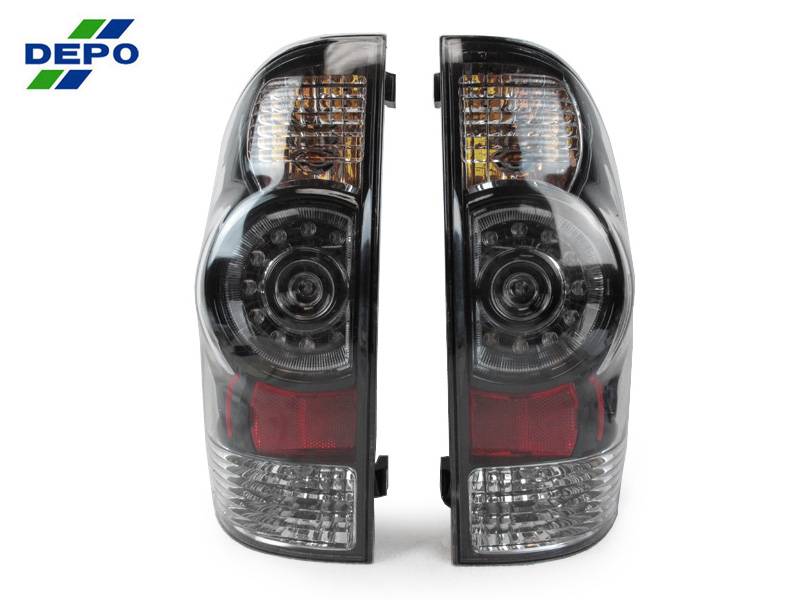

Has anyone switch there tail lights to something other than a OEM-style LED tail lights for 2006? I was sitting in traffic today behind a Tacoma and these look like they might fit.
