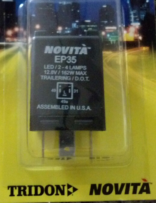

Hope this is the right one
I can eyeball that EP-33 and tell you it won't fit. Get the EP-35.(unless they changed between my year and yours.)
