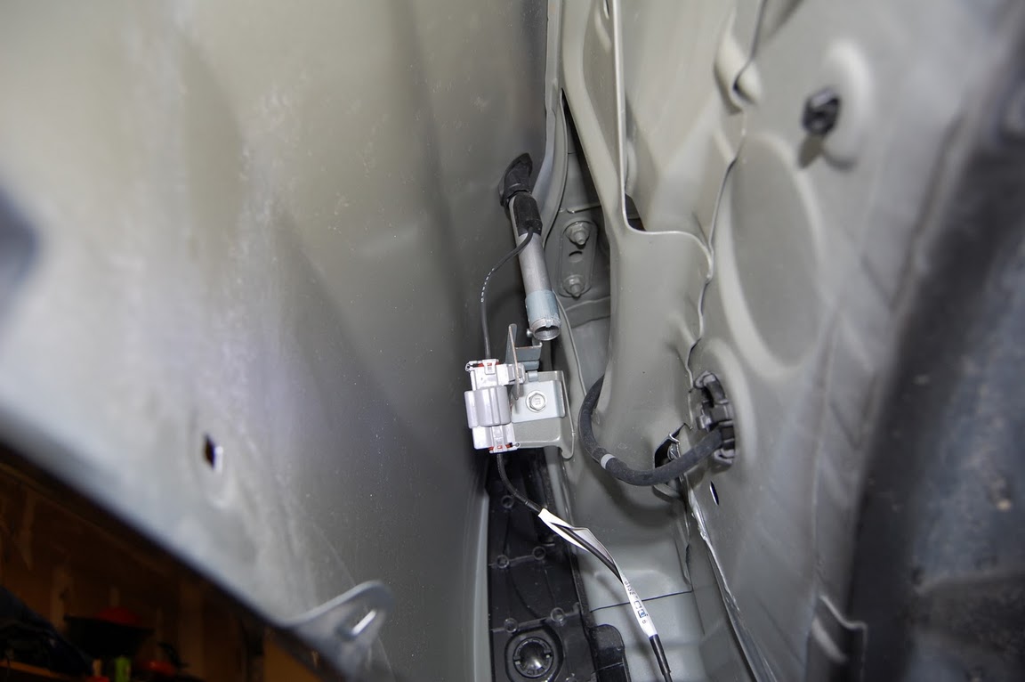

It's a powered antenna so see if you still have reception as the wires might have twisted off if it's turning and turning like this guy.....http://www.toyota-4runner.org/5th-gen-t4rs/58587-ideas-shorter-antenna-7.html#post905189
Not an easy fix if this happens as the wheel well liner has to come off to get to the other side.Liner removal is a real PITA and left a couple scars on my arms.

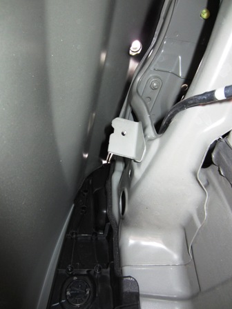

Here is a pic looking up at it with the liner removed.

I think I see what's going on, from your picture. Thank you again.
The antenna Assembly sits in collar or a sleeve. This collar pinches closed around the assembly and there's a screw that is clamping it closed. Which is suppose to keep the antenna from spinning in it's housing.
I might be able to undo that screw on the collar and slip every thing out the top of the fender. Since the Antenna ornament wont come through the hole in the fender.
To be honest ,I didn't really pay attention to how the antenna was attached underneath,just took the pic since it was open to it but ya that's what it looks like. Maybe pm that other guy that had to fix his for more info.

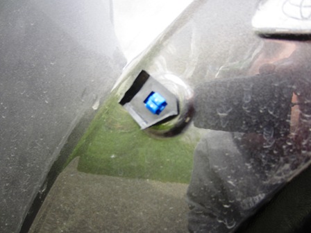

Well I Figured what was wrong with my Antenna...
Here's the steps I went through to fix it.
1.) Order all the correct clips and Fasteners. This is what I order.
Fender Moulding Clips 90904-67036
Hood/Fender Screw Grommet 20mm Head Diameter
Rocker Moulding Clip With Sealer 75495-35010

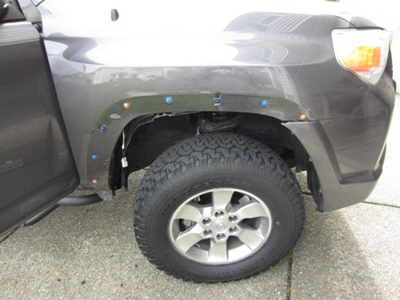

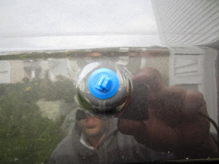

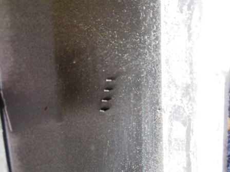

2.) Remove All the fasteners in the fender and in the liners.
Be careful removing your fender flare. I broke more then just the clips. But it was a easy fix using a ABS plastic epoxy from Lowes.

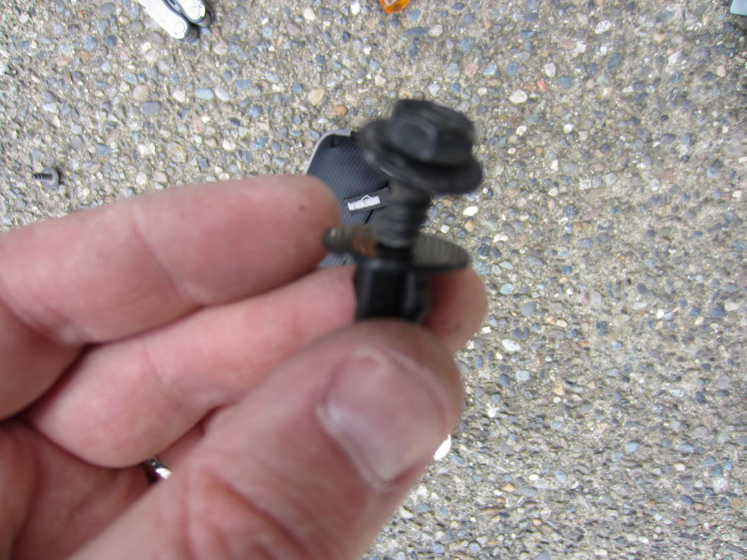

3.) Cut all the black push in liner clips. These same push in clips and used to screw the fender flare to the body of the truck. They are kind of a pain to remove. But I found a nice set of RC Car Body Scissors, that worked great.

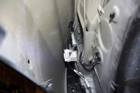

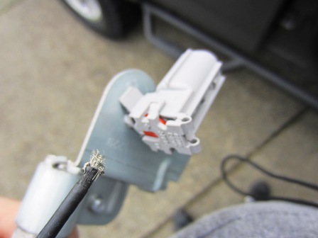

4.) Now you should be able pull back the liner and see your Antenna and the 10mm Bolt that holds it onto the bracket.

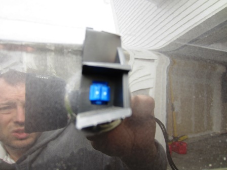

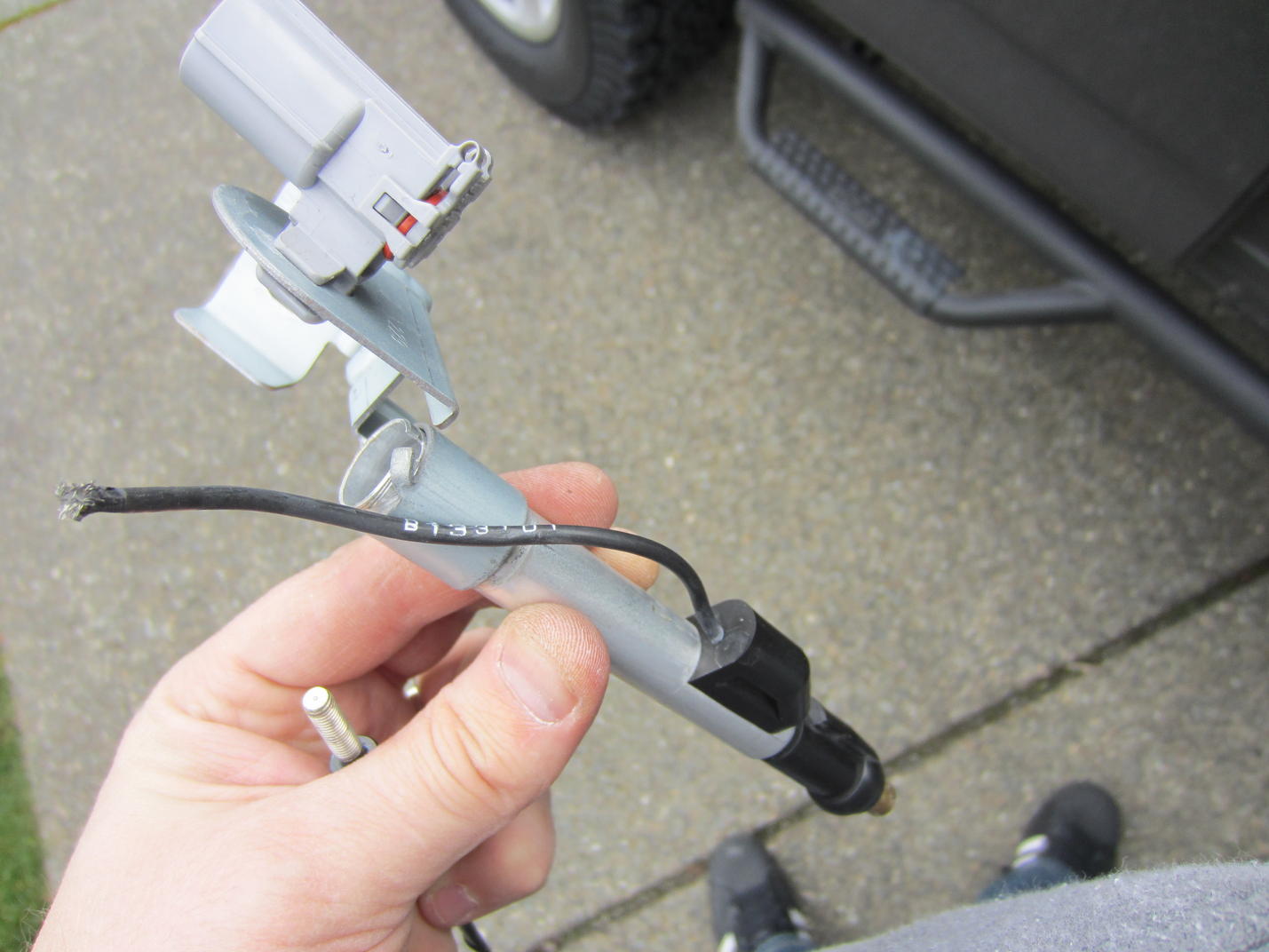

5.) Unplug the male and female antenna wiring form the mount.

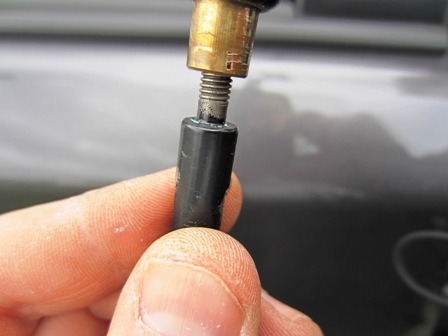

7.) It looks like there was some lock tight and plaint that made the antenna stick.

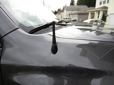

8.) My CravenSpeed works Great.
