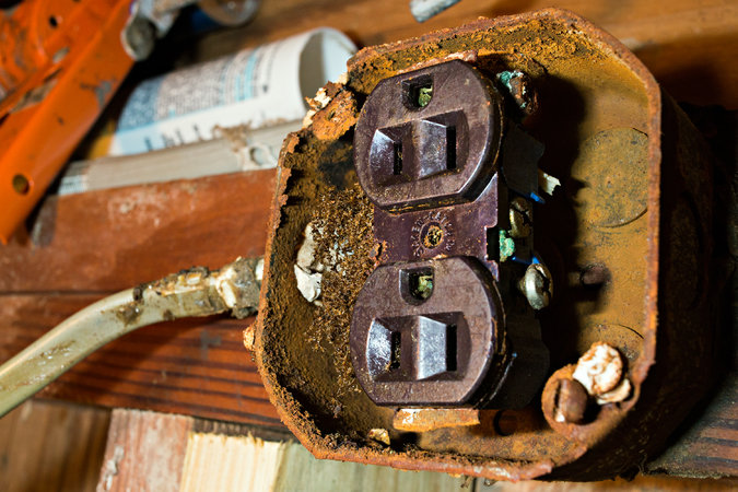

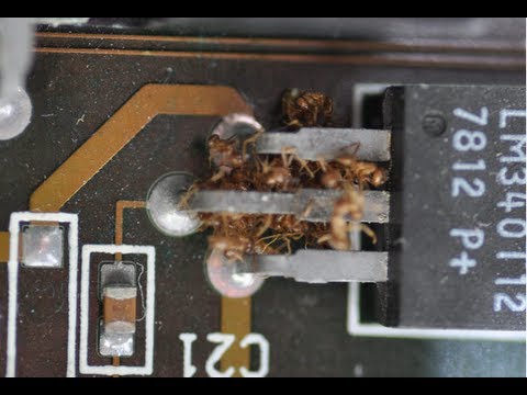

For the electrical issues I would pull up the fuse block under the hood and look for dead ants. We have lost thousands in repairs to these crazy/raspberry ants in the last 2 years. The Caterpillar dealer up the road from me lost 1.6 million in equipment due to them. They are incredibly invasive.

They are attracted to the electricity and they crawl into the fuse block and die.
They are full of formic acid and it shorts electrical components. Google it, they are becoming a significant nuisance in the south to any and all electrical equipment. Laugh all you want but insurance doesn't always cover the damage and they are extremely difficult to get out of a vehicle. He said he lives in Florida and has unexplained electrical problems.
