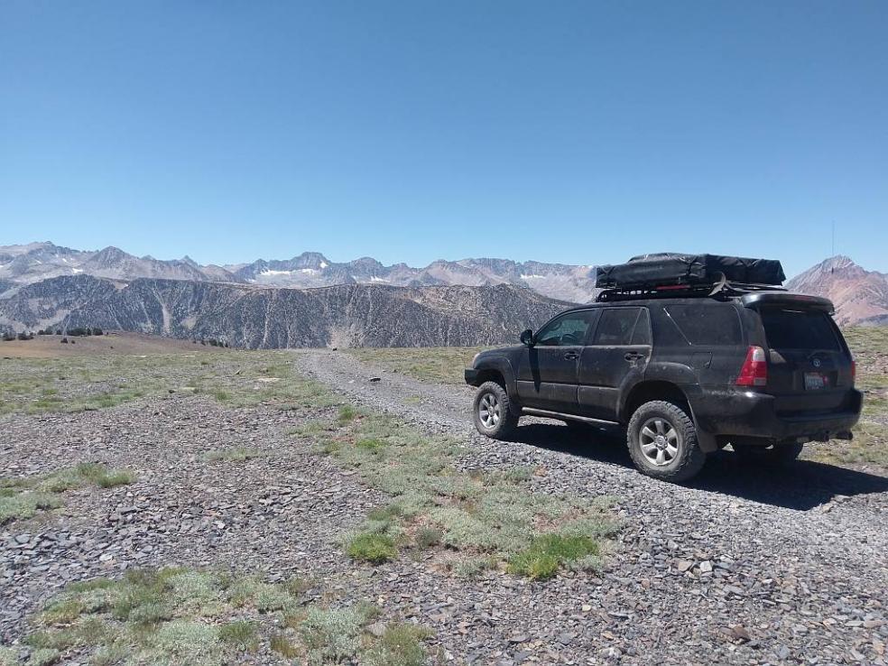

I got the Icon Overland springs for the same reason. They are dual-rated so they ride ok when unloaded and hold quite a bit of load. Unloaded you do get 3" of lift though (don't have a rear bumper), loaded about 2". Had Toytec springs before and kept hitting my bump-stops all the time when loaded. Not anymore with the Icons. Really happy with them.
Here a picture of how it sits with the Icon Overland springs fully loaded. Front springs are 700lb set to 3" with full bumper and winch.
