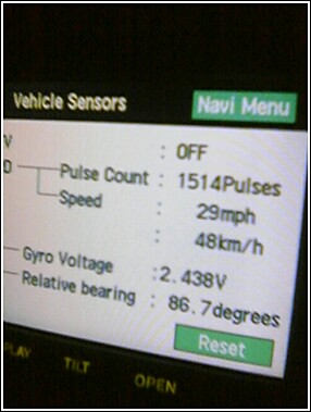

IT WORKS ON THE 4RUNNER!!! MY 2005, FREAK'N AWESOME MOD.
Just go into the service mode, you can do this while driving even, and turn the over-ride button on. Hold it for 5 sec, see it highlight, and hit the back key.....
Now you can enter driving directions while driving!!
ENJOY!
Luke

This is great, now tell us how to make it stay in this mode permenantly, and elimiminate that stupid disclaimer every time you use the nav system.

I know how overide the system but how did you get the screen that show the speed. Also is there any other info that can be displayed.

which sateliteS it connects to, and ......error log:bash:

I can get the NAV into diagnostic mode by pushing and holding the INFO button (bottom right) and then then turn on/off your park lights 3x-5x times. This lets me see the speed and sensor info etc. But even in here there is no Override Button?

Great find!! I just tried it out on my 2005 factory unit and it worked. I held the 'info' button down while turning the parking lights on/off 3 times. The only problem is you have to restart the truck to get the radio back on.
i just tried to get my nav to work while i am drivin it works like a charm. what else can we do to it. i read something about the speedometer but not sure, can we get a clear response on how to do it.
