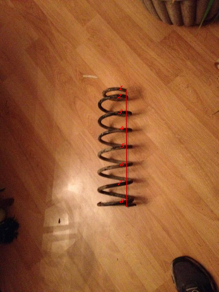

Let's play count the wraps
Im seeing 8 as well. what is the color code on them. that will tell more as to what size they are than guessing on the number of wraps.
Here is how I count them.

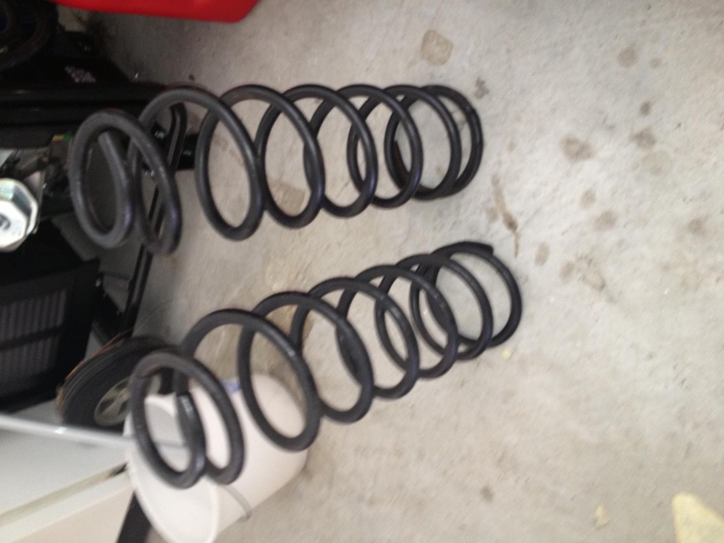

Ok so we may need to see the other coil to determine these. Here is a pic of a pair of 7.5 wraps from the 4sale section.
The top one shows the 2 ends half way apart indicating a 7.5 wrap but the bottom one is the same as yours (what I would call an 8 wrap). Im assuming this is because of the drivers side being taller to accomidate for the extra weight of gas tank and driver.
So based on that picture, I would have to say that they are a 7.5 wrap set. the shorter looks to be a 7.5 wrap and the taller an 8. I think they use the shorter of the 2 to determine what to call a set.
