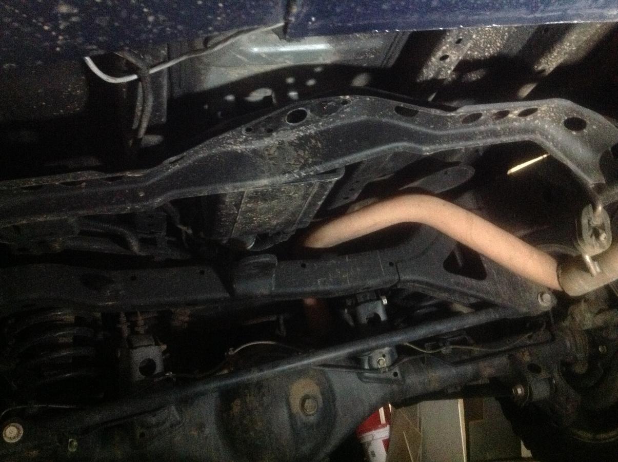

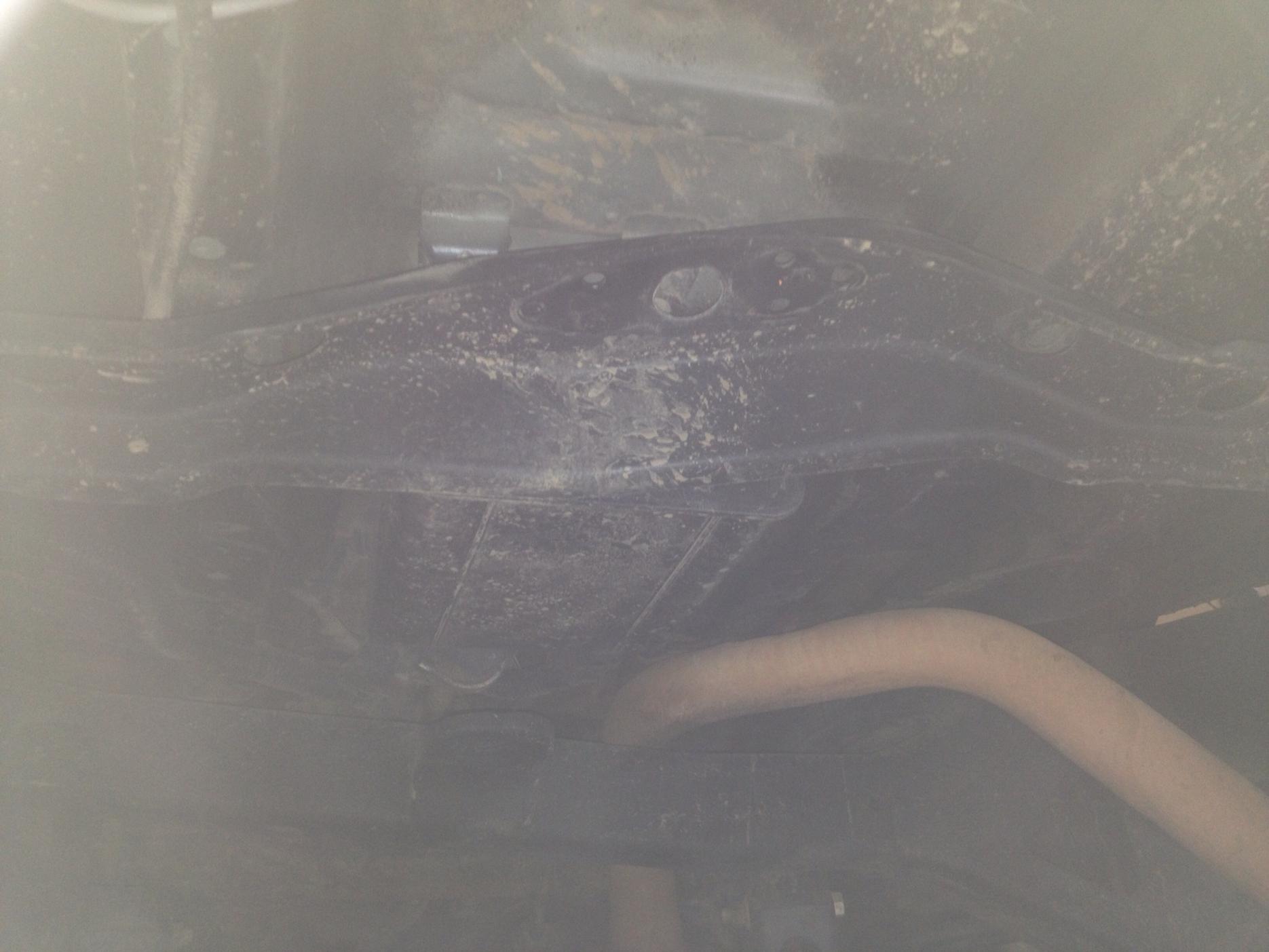

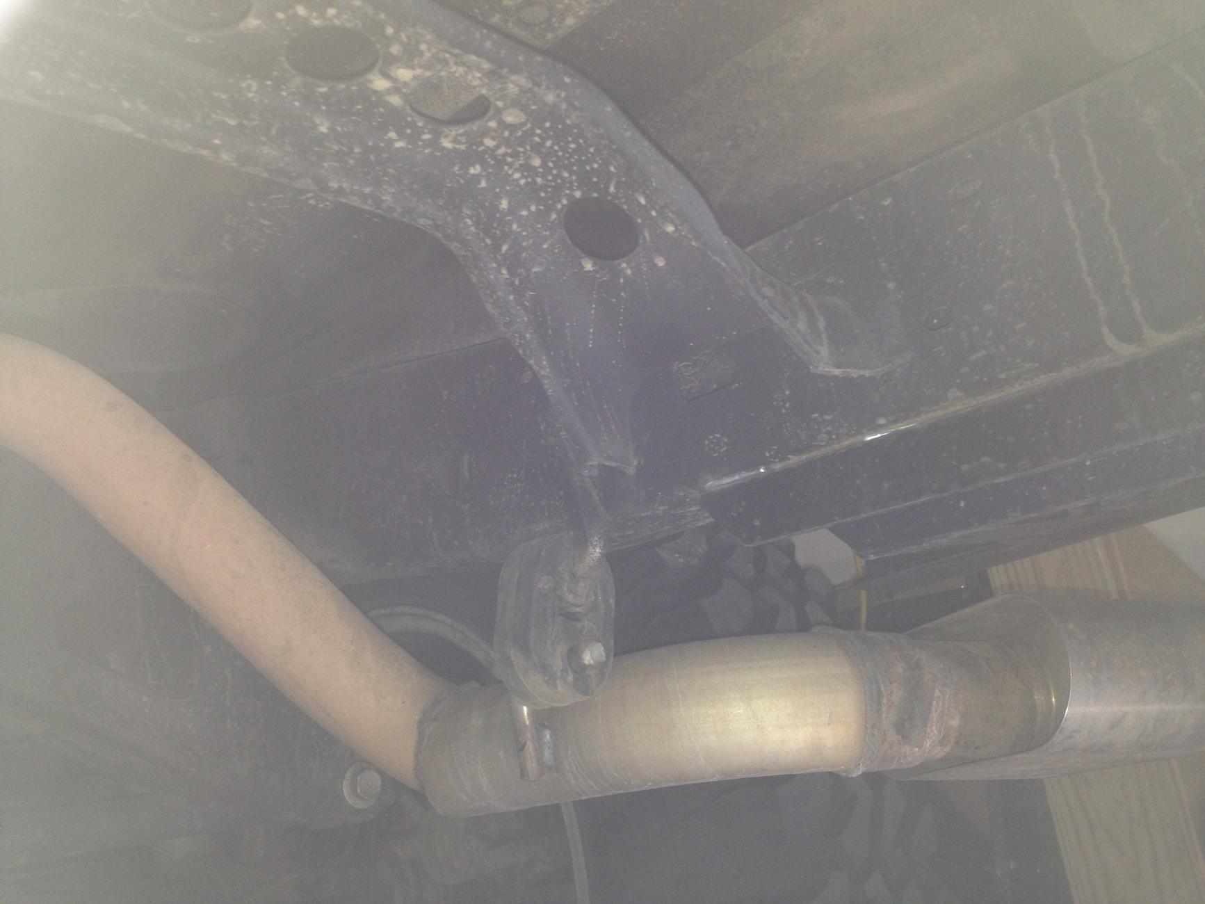

It is formed but has holes in it I can grab it and get it to move with my hands I will try and get a picture of it in a bit
Crashman, if you can deform it in any way with your bare hands then it is absolutely NOT structural and you can remove it without a second thought.
Well this is the best I could get at night with my phone
Cut it out. It's not structural. If you're still worried about it later just weld in a new crossmember after the tanks are mounted.
