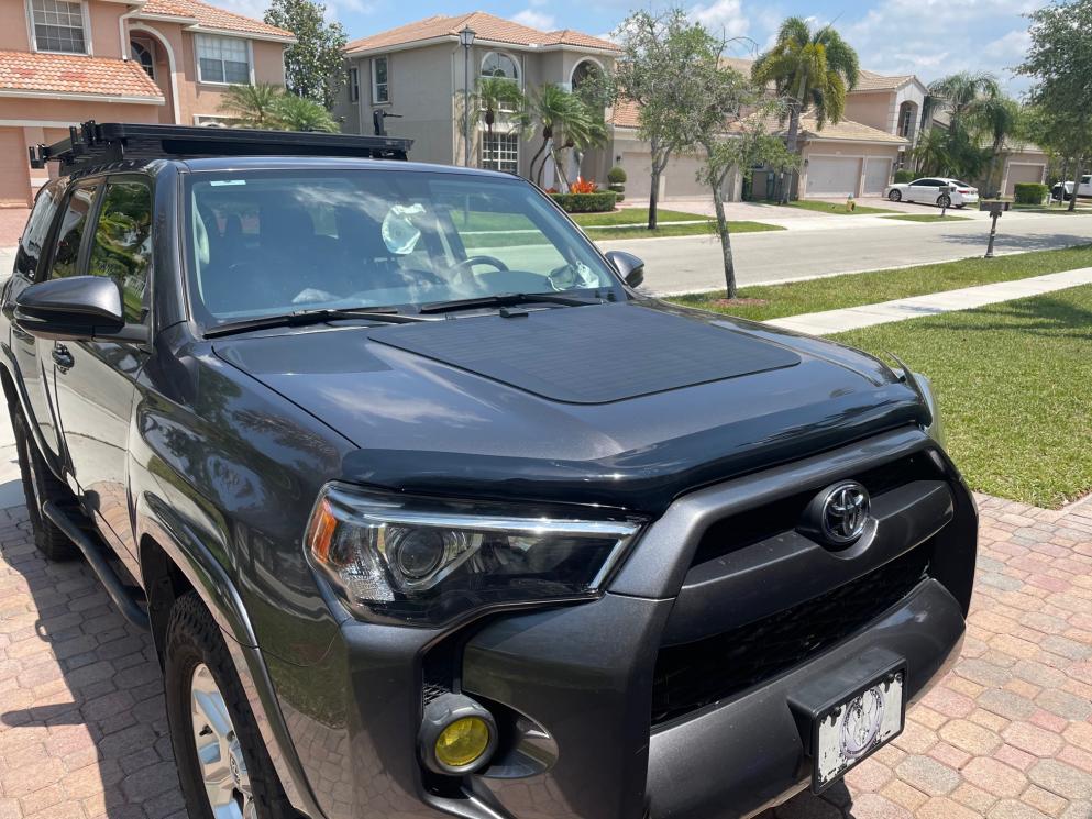

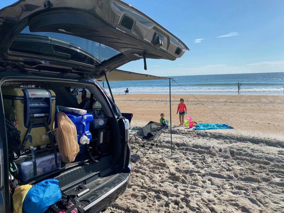

Fridge + Solar = Indefinite Cold :cheers:
Great setup! Do you have links to the hood solar panel and fridge setup that you have?
The solar is from Cascadia 4x4. They have a bunch of options for vehicle specific sizes. So far it has been great and works very well in the South Florida sun. It's a 90watt panel and pulls about 75 watts in full sun, 30-40 watts in indirect light, plenty to run the fridge and keep the battery topped off. The kit I got also comes with a charge controller so it works in keeping the battery healthy even with no fridge in the car. It is a semi-permanent mount, so taking it off would not be the easiest. Our hood already had plenty of imperfections from all of our adventures so wasn't a big deal for me....I would only recommend if you are planning on keeping the vehicle for a long time. I have more details in my thread on post #280.

The fridge is a 47qt ARB on a DFG fridge slide. The cargo storage its mounted to is home built and designed to work with our 3rd row. Its modular, so it can work with the 3rd row completely tucked away or using 1/2 the 3rd row at a time. I have more info on that build in my thread linked in my signature. The build for the cargo storage is in the link below...post #181, with more pics and info on post #204, #224 and then with the fridge slide and how it's attached on #244 (its always being modified based on our needs).
