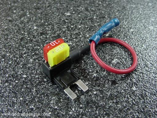

Wiring this thing is gonna be a female dog. The red/black power cables are only a couple feet long and won't reach to the battery. Where the **** am I gonna pull the power off of to power the cb?
wire it to the fuse block (under the dash), and then ground it to anything metal attached to the chassis.
You can get a "Mini fuse add a circuit" at the auto parts store, these make it really simple and easy to wire up accessories like CB's and such
I put mine in the same time i did my HU, i tapped into the full time +12 on that so i can still use it with the truck off. its got a built in switch that way.
With my suggestion you can also have it run when the car is off, just find out which place on the fuse block has power when the car is off. Use a circuit tester.
So if I pick up one of those, I just solder the red into one of those fuse connector things and ground the black, and put that fuse thing in an empty slot in the fuse block (assuming there is an empty slot)? Thanks this looks like the simplest way
Yep, and you don't even have to solder, you can just crimp it. And I know there are a few empty places on the fuse block under the dash, there are also a few under the hood too on that fuse block. And if you have to get more wire that's easy too, same section in the auto parts store.
I don't want to discount what twitchee2 said though, you can also tap into any power wire too back there, something like the cigarette lighters/power ports, that would be fine too. But I prefer to use the add a fuse thing.
