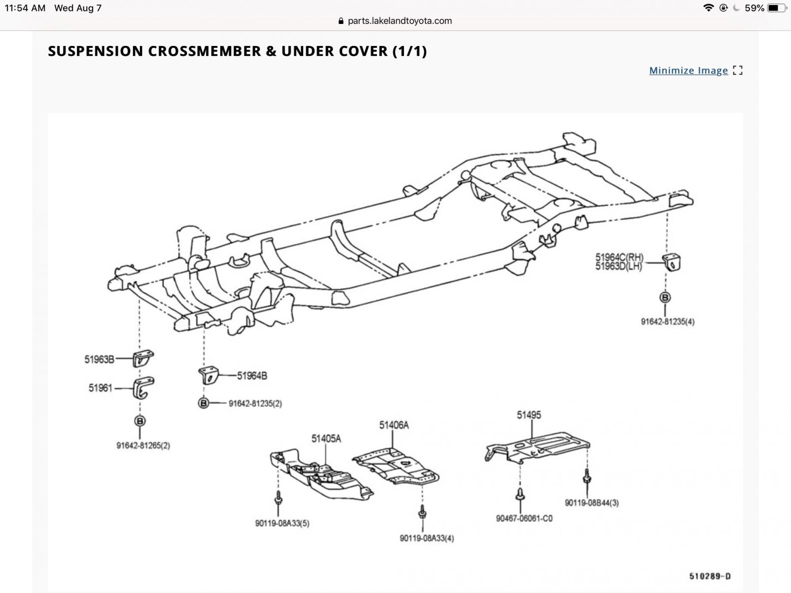

Removing both mine today had a bunch of sheared off bolts. The ones that came out really had no threads left and managed to drill out the broken ones. Now just need to figure out bolt sizes and where to get those clip things. I’ll probably run a tap through and use SS bolts with a bunch of anti seize when reinstalling. Anyone have part numbers/ sizes or diagram ?
Bolts are M8 x 1.25 and measure out the length you need compared to your old bolts.
But since you have some bad threads on the nuts on your subframe, just run a tap for the next size up.
That easy.
Diagram for skid plates and hardware as requested.
