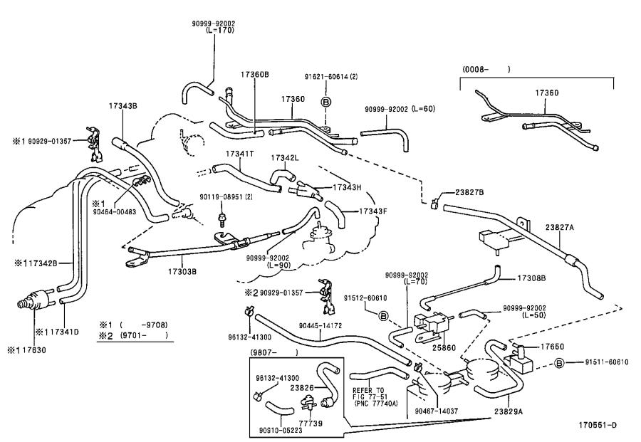

The FPR looks look based off of no fuel in vac line
Fuel pressure is steady at 45-46 psi under idle.

https://www.toyota-4runner.org/atta...182d1589500365-lets-talk-tests-a1_170551d-jpg
If anyone ever stumbles across the crazy thread this picture may help for vac lines. Look like Toyota part numbers for each.
When I rebuilt the engine I ordered all new coolant lines to delete the aux heater. As well as the vacuum lines from the IAC to the two injector rail vacuum ports.
