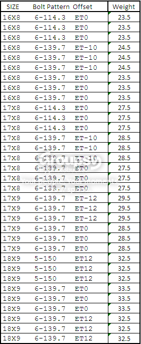

-The 17x8" Konig Six Shooter weighs approximately 20.5lbs per wheel. The 17x8" Level 8 MK6 weighs approximately 27.5lbs - 28.5lbs per wheel (depending on the offset). Official weight chart from Level 8:
Size_zpseea439b8.png~original
This is a 35% - 40% weight difference, and please remember that your wheels and tires are unsprung weight. This is a huge difference, and you will notice decreased acceleration, decreased fuel economy (worse gas mileage), bumpier suspension, and increased stopping distance (worse braking performance) with heavier wheels. A 10% - 15% difference in unsprung weight is usually noticeable, greater than 25% is significantly noticeable, and 35%+ difference is very, very noticeable.
I do realize that the Level 8 wheels are cheaper priced than the Konig wheels. I don't want to speculate about why they might be cheaper, but I will recommend that you consider the added costs of : more fuel (because of decreased fuel economy), more frequent brake pad and rotor service and replacement (because of the need to apply more pressure to stop in the same distance), more frequent need to service or replace your shocks and suspension bushings (even more frequent if you offroad), and a general all-around more sluggish and bumpy/bouncy feeling to your 4Runner from installing heavier wheels (hard to put a dollar figure on this, but in my opinion "fun factor" is most valuable).

Stock SR5 wheel is supposedly about 29.6 lbs....so even the heavier level 8 mk6 will be lighter. Trust me, if cost wasn't a factor, I would be all over the Konigs. My budget calls for a set of wheels that I can have installed for round $700-$800 out the door. Unfortunately, that won't even get the Konigs to my doorstep.
I never thought choosing wheels would be so difficultly! Not sure if I can live with the giant 8 in the center cap. Come to think of it, I like another set or 2 of level 8s, but hate the center caps!
No problem, I completely understand. If your current wheels are 29.5lbs then you definitely won't be degrading the performance of your vehicle with a set of 28lbs wheels.
However, I just wanted to point out that you would be significantly improving your performance with a set of wheels that are 35% - 40% lighter, and it would save you money in the short term (gas mileage) and long term (vehicle wear and tear), to the tune of a dollar figure that is probably more than the price difference of the wheels. :)

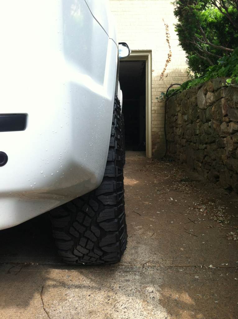

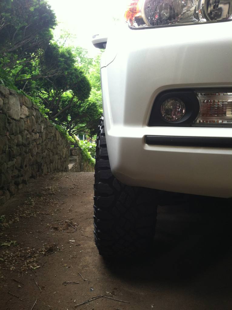

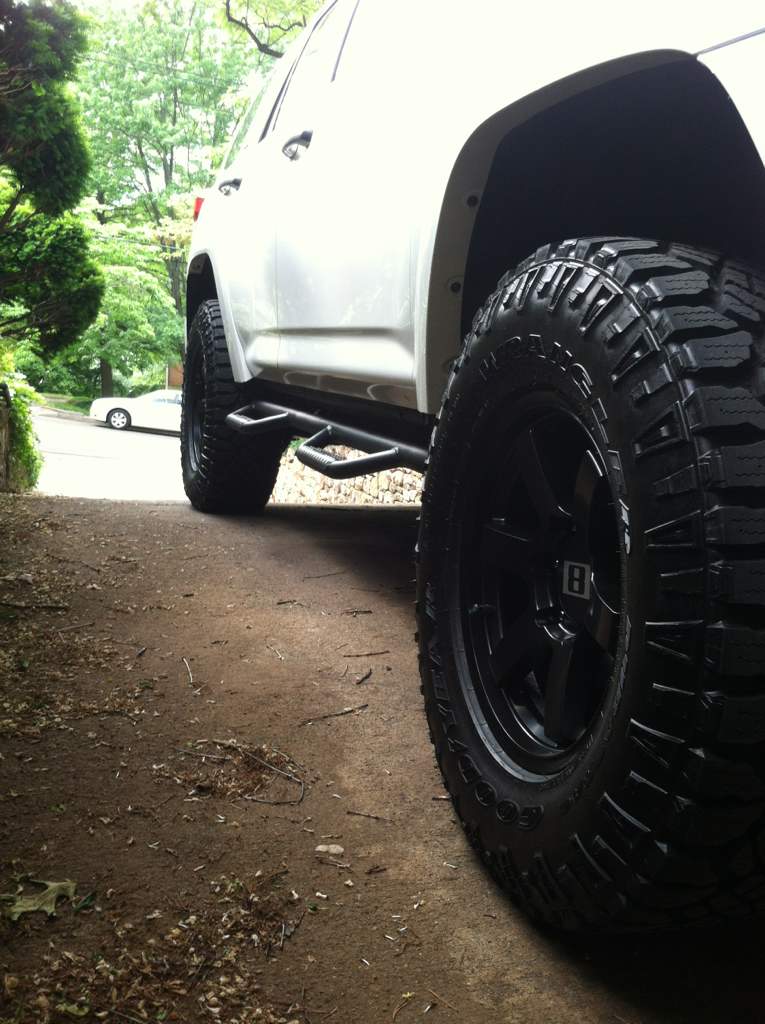

Looks like I will be the guinea pig for these. Thanks to discount tire direct, the price couldn't be beat. As much as I really like some other MFGs wheels (especially Konig & Method), I simply decided to go the more economical route. Ordered 17x8, 0mm Offset in Matte Black this afternoon. Decided on the less aggressive offset for an easier fit. Certainly not as aggressive as the 17x9, -12 mm offset a lot of you guys are running, but should still be a nice stance with the 285 Duratracs. Worse case scenario, when I break down and buy UCAs, I can always throw some spidertrax on if I feel the need.
Already have the order confirmation and UPS tracking info. Could have them on as early as Friday...if not, I will have my truck at the shop the day of or day after these arrive. Pictures to follow shortly....

Picking up my 4Runner @ 5pm with new MK6 installed...it is currently pouring down rain, so it will probably be later this weekend before I can get some pics...stay tuned!
