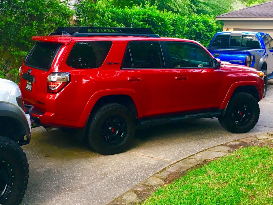

Here's mine with stock tires and 2.5 front, 1.5 rear. Which meant the rear was1" higher measuring at the fender, but measuring at the frame it was level. If you do the 2.5/1 it might have a slight reverse rake at the frame.

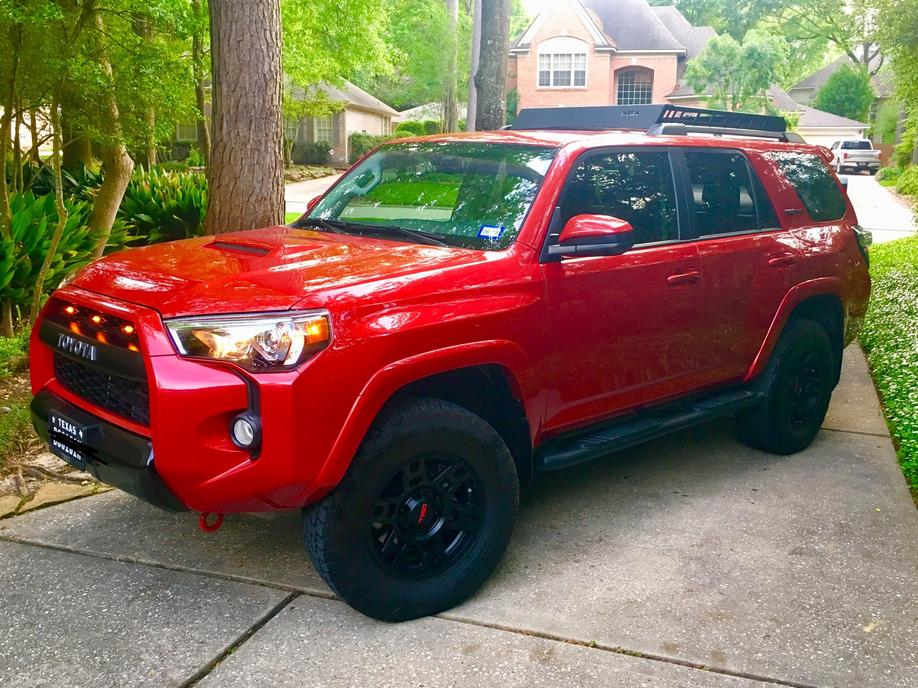

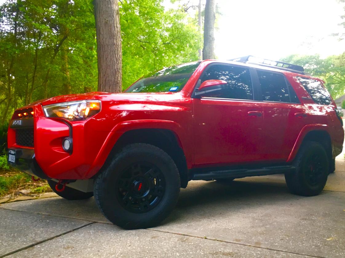

OP, Im running stock size BFG's with a 2/1 lift. I think it looks fine. My new lift (Toytec Ultimate) should be on in the next week or 2 which will be a 2.5"/1.5 inch , but I'm going to keep stock size tire since I don't want to deal with any rubbing issues at all off road or on road. All I'm going to do is put on aftermarket rims.
Top is stock.
Middle are Bilsteins set at the 2.5" notch with no lift in the rear.
Bottom is with 2" lift ( I know you're specifying 1" though) in the rear. Keep in mind, the front is not this tall in person. It's still the same as the middle photo. The ground was angled downwards I guess.
Wow that looks awesome. I definatly wouldn't mind this look.

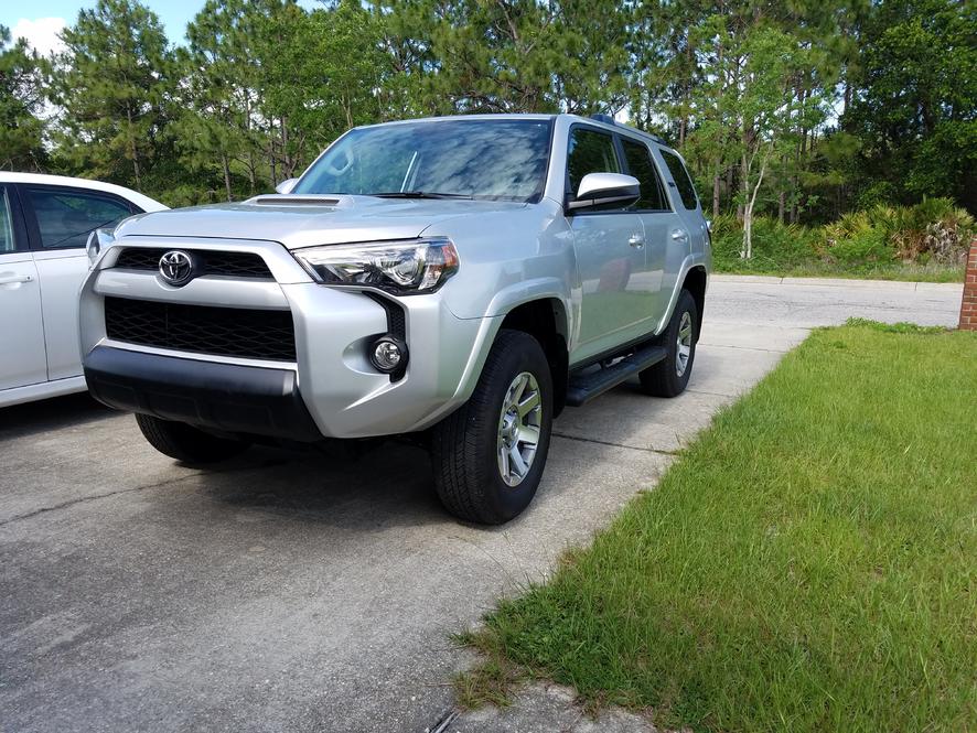

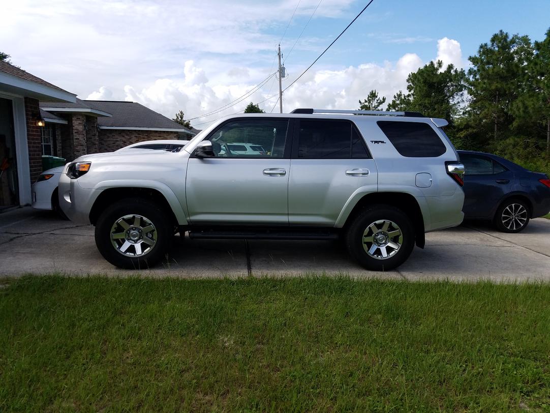

Toytec 1” Baja perch spacer level
Installed Toytec 1” Baja perch level. Rides great and looks like it should from Toyota
