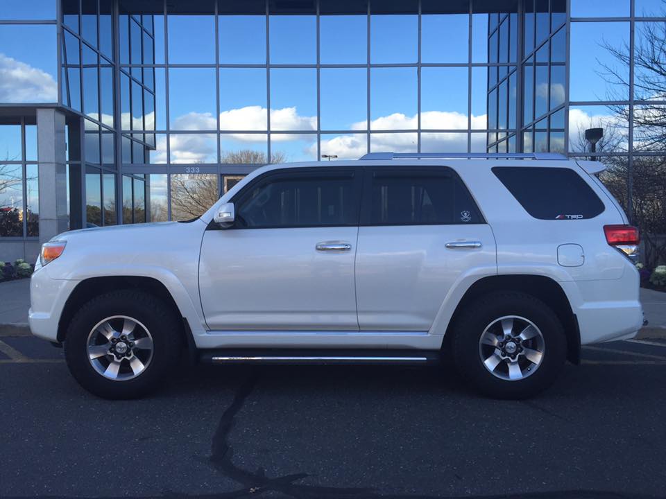

For everyone's reference. Here is what stock tires look like on a 2" front and 1.5" rear spacer lift. I aligned the cars' scale and levelled the photos at the hubs for your convenience.
It ended up lifting the truck and cut the rake in half. (still some rake, which I wanted) Will be upgrading to 275's or 285's soon. Will post another comparison shot once finished.

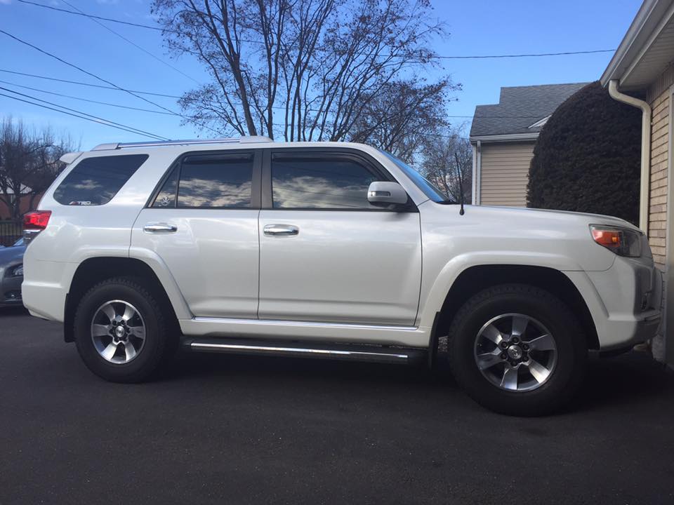

Top is stock.
Middle are Bilsteins set at the 2.5" notch with no lift in the rear.
Bottom is with 2" lift ( I know you're specifying 1" though) in the rear. Keep in mind, the front is not this tall in person. It's still the same as the middle photo. The ground was angled downwards I guess.

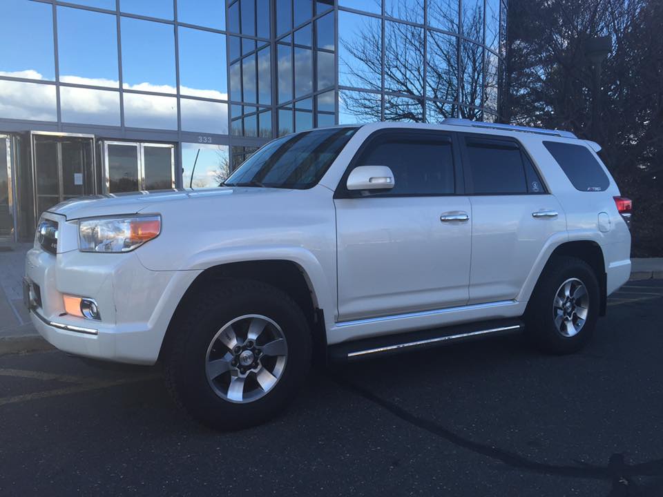

Here's stock tires with 1" leveling kit up front. No rear lift.

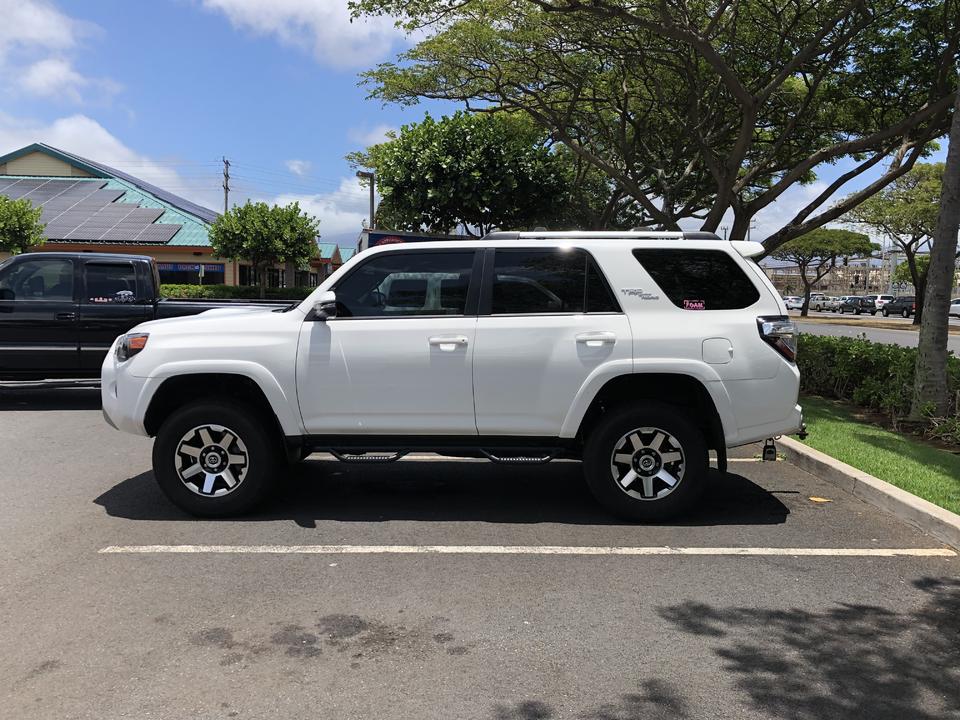

2017 TRD offroad
Bilstein 5100 set at 2.5 inches (front)
Rear bilstein 1.5 inch spacer and bilstein 5100 shock.

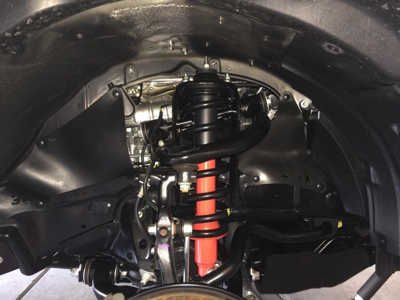

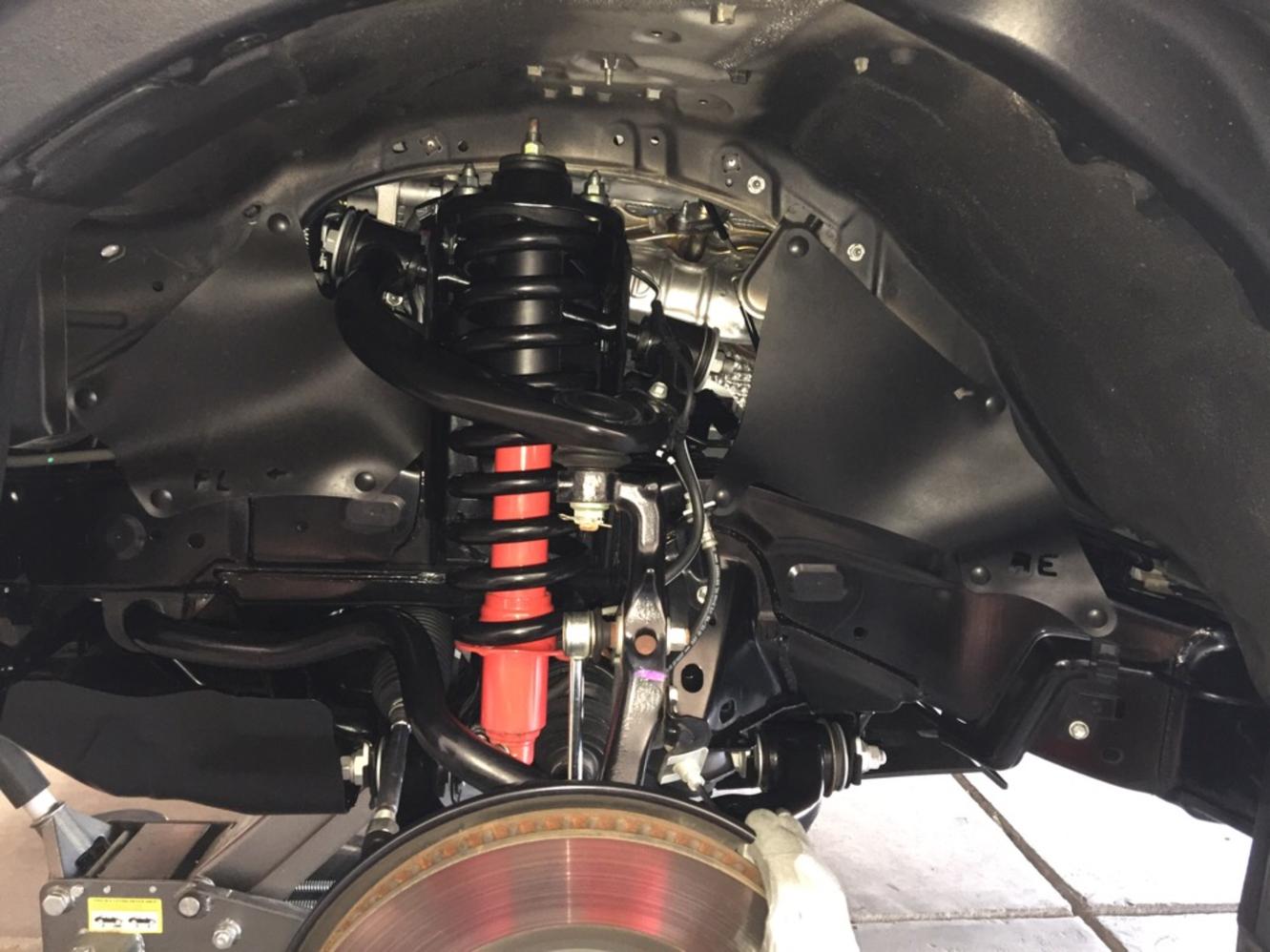

Does anybody know why the Limiteds have different front coil springs left and right? Noticed this when detailing the rig. The driver side has more coils (not sure what to call it) than the passenger side. I'm guessing to help compensate for the driver's and gas tank's weights??
IMG_0886.jpg Driver side
IMG_0887.jpg Passenger side
Our Limited is also riding very rough even when the roads aren't that bad. The vehicle is very jarring going over the slightest road imperfections. All stock and running 32 PSI all around. Not even 8,000 miles on a 2017 4x4... Definitely need some insight!
