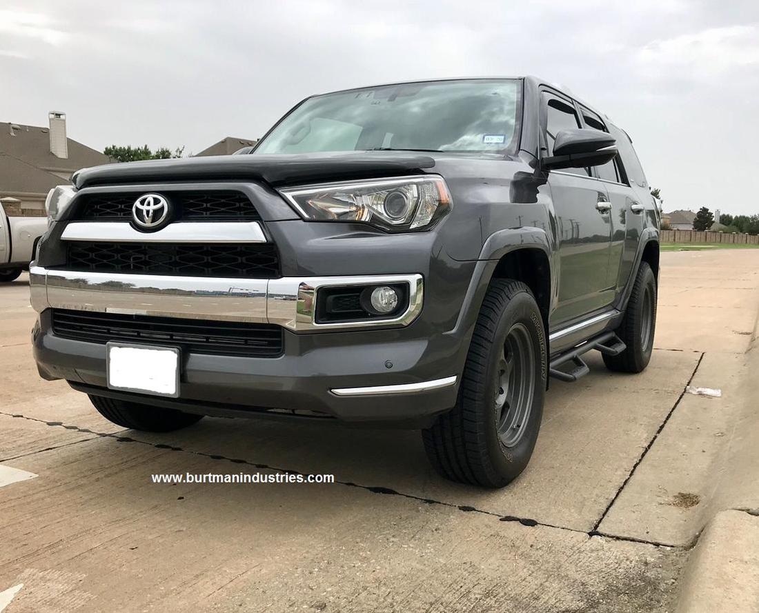

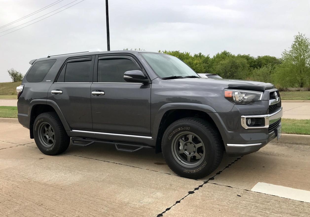

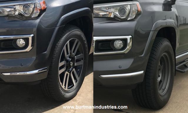

This wasn't easy, but got my customer to take some pics. This is our 1” front for 5th gen LIMITED as you requested. Again we have kits for all model 5th gens and pros. Guaranteed for life to never compress.
Also, put a pic for comparison of the stock setup - no spacer lift - vs ours with the 1" with the new setup, side by side

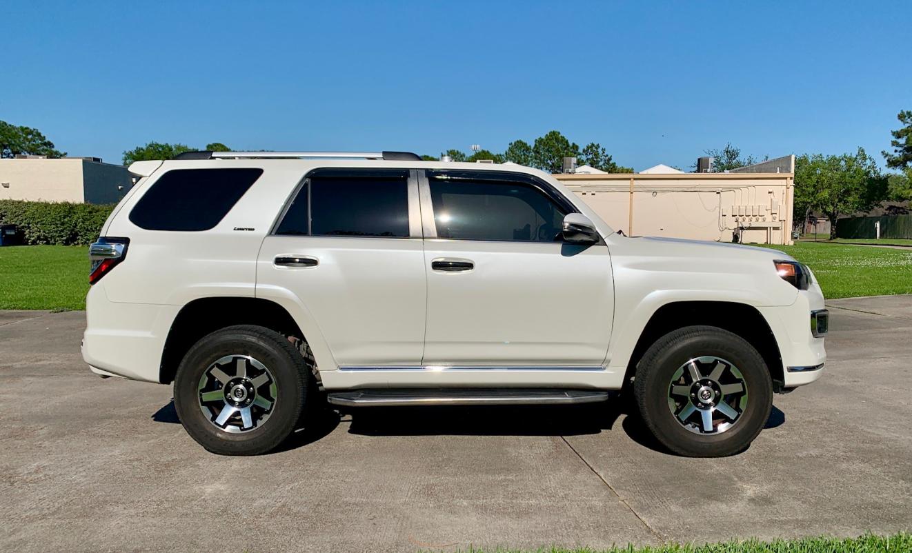

Here is my 5th Gen Limited 4x4 with Daystar 2.5"/1.5" leveling kit on the stock 20s with stock tire size. Planning on going with Gunmetal TRD 17s with 32" KO2's soon. Hope these images help get a good feel for the look and added tire clearance. Ride is close to stock, feels a little more top heavy under hard cornering but I don't drive my Runner around a track so I am really happy with the outcome. The rake just looked silly.

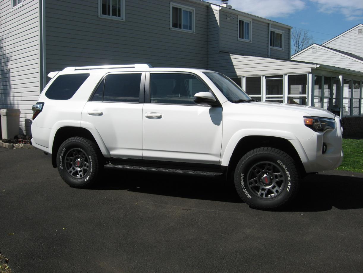

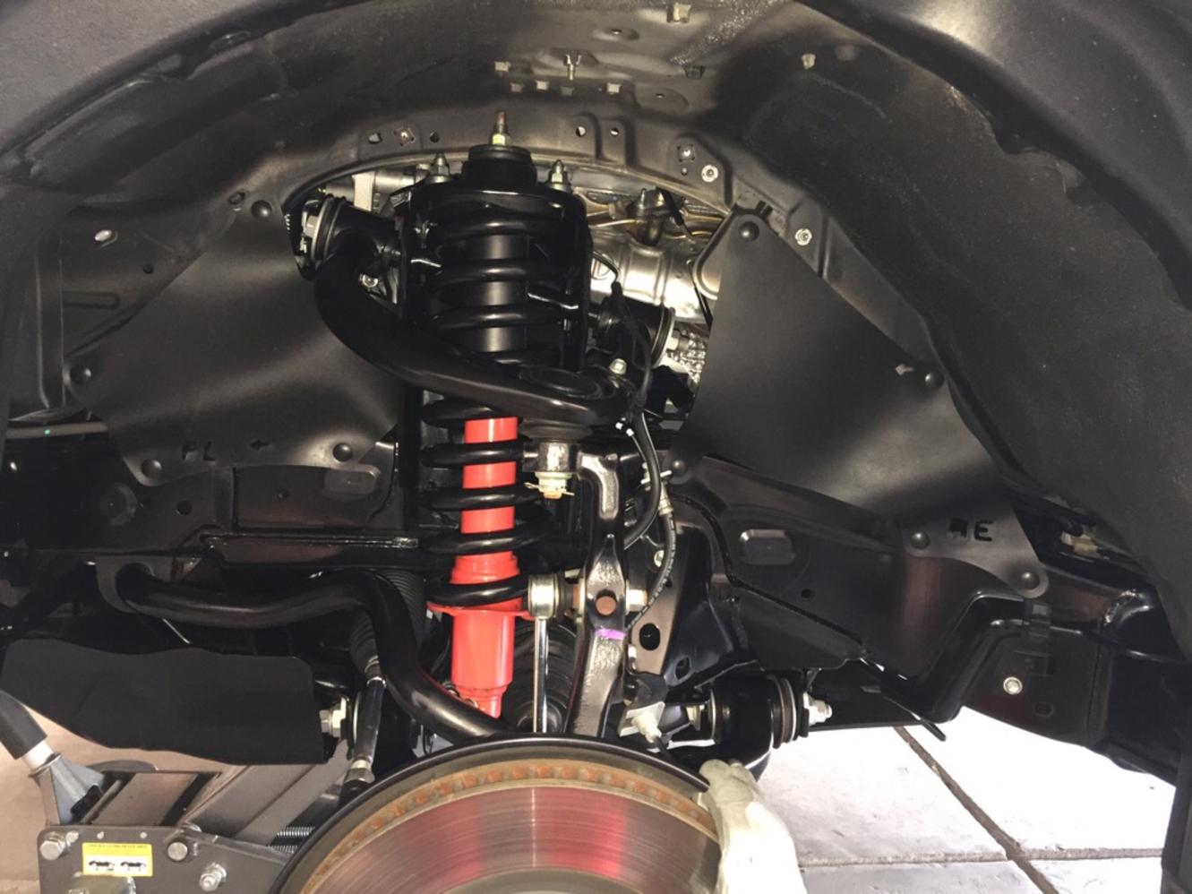

I did something a little different to level my front and not touch the back. I installed Bilstein 5100 at 0.85" (2nd notch from the bottom) and then a 3/8" spacer on driver side and 1/4" spacer on the passenger side. This removed the lean that all our Toyota truck has upfront. My measurements are 30.75" LF/RF and 31.00" on LR & RR. Here is my current photos with my new stock PRO rims and tires.

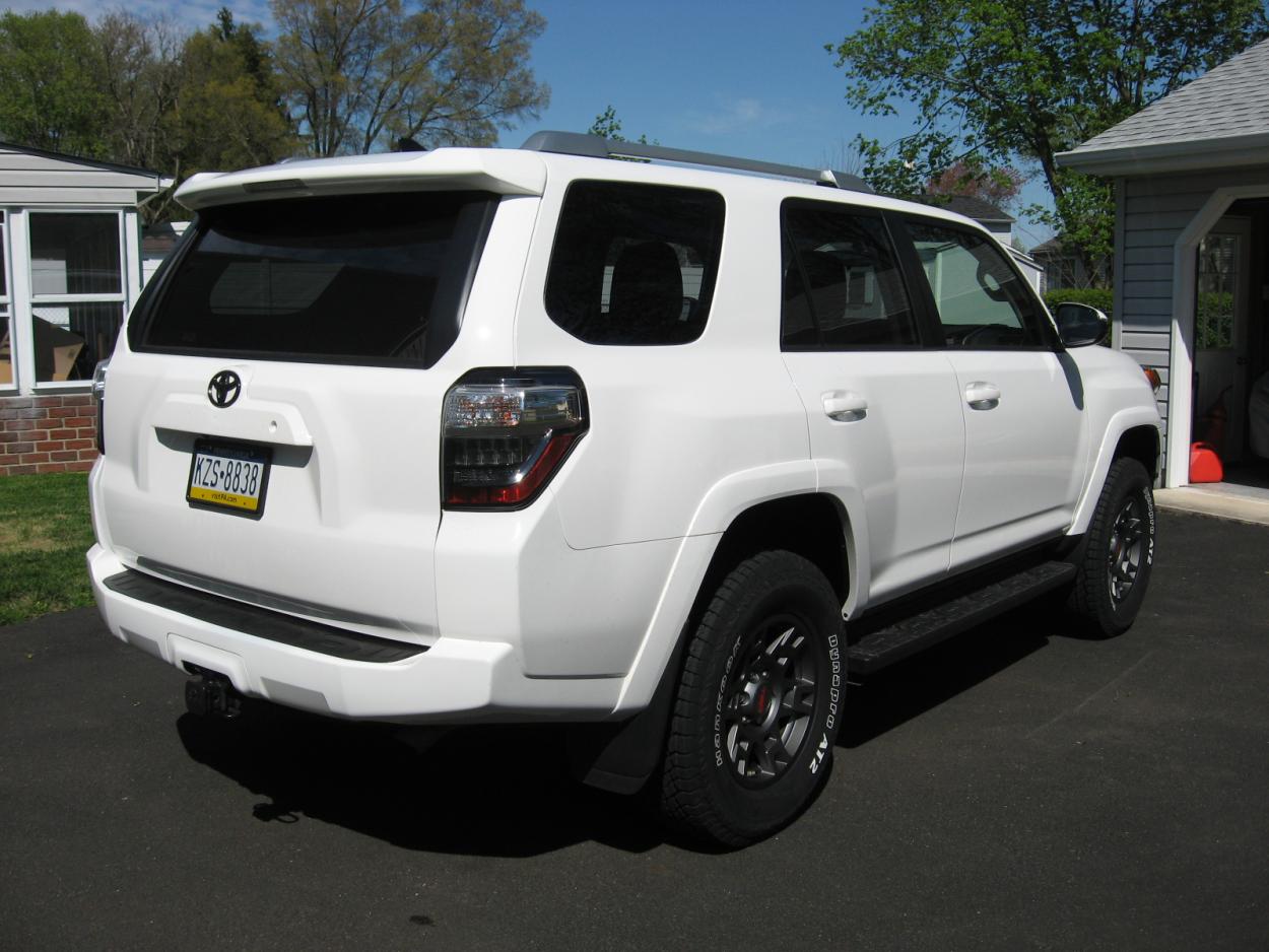

I love your setup! Those are the rims I want. How do you like those wheels? My 20's are so sunken in to the wheel well it looks silly. I understand that the Pro wheels do push out a little further to be a little more flush but not by much. I am hoping these will solve the issue, I wanna keep the wheels TRD if possible. Do you have any side view images so we can see how flush they look? I am not a fan of spacers. Also what size tires are you running, thanks in advance.

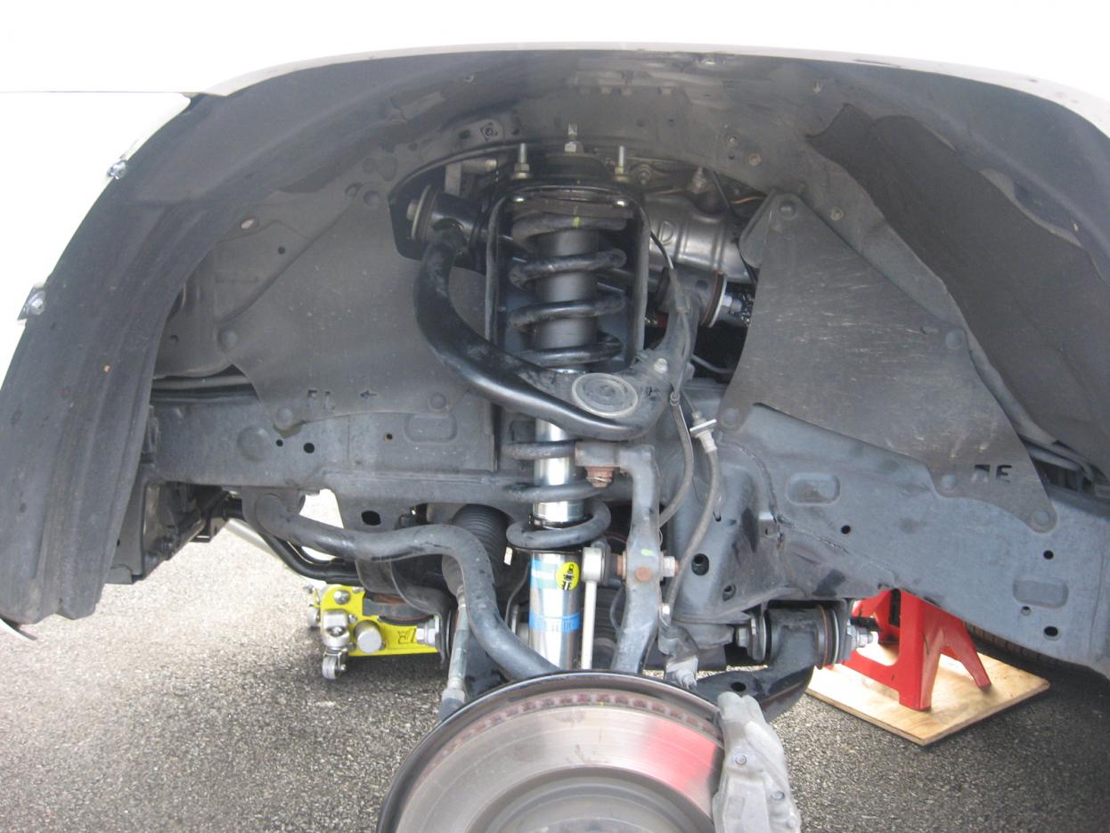

My 4runner is a basic SR5, adding the Pro rims did push the tires out about one inch and it does make a visual difference. The tires are stock size P265/70R17 Hankook Dynapro AT2 tires, had three sets on my old FJ for 10 years and they never let me down. I will post a photo from the side so you can see how the tires look. BTW I am also not a fan of the spacers, the spacers I added are minimum and barely noticeable, see the photo I posted showing the 3/8" spacer which you barely can see. I did not want to go full 1.75" up front, that is why I added them.
Did you use plastic or aluminium spacers? Nice 4Runner- do you have a close-up picture of the plate garnish without the lettering? I'd like to see how the dimples look on a Super White.
I used the plastic type spacer from Wheeler Off-Road. I will later post a photo of the rear end.

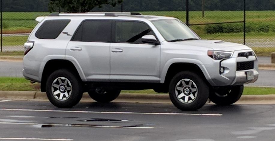

I have a Covid sale right now of lifts. Pretty much any size you want, and or can make any custom size you want also.
5th gen lifts, Covid Sale - for sr5, trd pro, etc. at Burtman Industries
2/1.5 kit shown :)
337328d1561161298-lift-leveling-kit-holiday-season-sale-f7904e79-8b79-44a0-86d6-06f42e7e7127-jpg
Jason the photo of the 4runner looks great! My question are you sure the photo is correct with 2" front and 1.5" rear level lift? Seems to me that the stock 4runner rake is usually averages 1.5" to 2" difference. So with that is it possible the photo you posted is 2" front and maybe 0.5" rear level lift?
