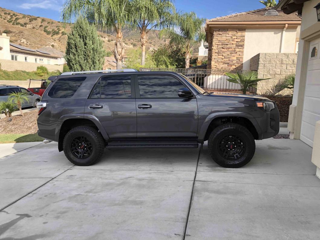

Own a 2016 T4R SR5 Premium 4x4. Truck has 35K miles. Currently running Kings and my wife doesn’t care for them for running around town, so I have to do the work. I primarily drive our Tundra and I have Bilstein 6112/5160 and she wants the exact same setup.
Last weekend, we installed Bilstein 5160 on the rear. No rear lift was added. Running TRD Pro wheels and Nitto G2’s (265’s).
We want the T4R to be set as close to level as possible. By level, I mean front and rear at the exact same height. Can someone with this setup or 5100s share their results? My options are .85”, 1.2” and 1.6” lift from the 6112s. Thank you I’m advance for sharing perspective. Photos of your rig would also be helpful for reference.
*UPDATE* We have gifted the T4R to my parents (Grandma & Grandpa) to help tote our daughters around after school everyday. Life happens and we are happy with the Bilsteins and this makes them a good option for a level look but daily daily daily driver. We will never off road on this setup.
-George

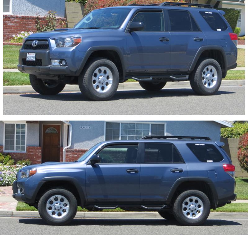

2013 Trail with 5100s. Front set to 0.85, rear 5100s no spacer. I do have AirBags but they are at 5 PSI. It's slightly tail high, but not much.
IMO 1.2 in front would be good. Much of a load will make it look tail heavy but that's what AirBags are for.

Completed the installation of the suspension today. Here is what I’ve done. The rear is OEM with Bilstein 5100. The front is Bilstein 6112 set at 1.2”. I called Bilstein because instructions say to set the drivers side on the 4th circlip and the passenger side on the 2nd That’s what I did and there is no driver side lean and the truck is very very close to level (front to back) and from the center of hub to fender it measures 23” on both sides. I removed my after market UCA’s because the uniball went bad after 25,000 miles and I wanted more durability so I reinstalled the OEM UCA.
I agree with move to stock UCAs for your setup - less worries and hassle in the future. Are you happy with the ride of 6112s vs the Kings?
23" front on 4/2 clip seems like a high measurement for that setting, hopefully it will settle. Did you have the alignment done yet? You sure you don't want some rake when your back is loaded?
Put 50 miles on it today and it really does ride nice. More compliant for a daily driver when compared to the Kings. Although the Kings were incredible off road on the once experience I had with them. Overall satisfied.
Loaded it up tonight actually. Had groceries, baby stroller, baby crib, and two kiddos. Truck was perfectly level loaded up. Now the truck has been given to my parents, so they can help with our kids on a daily basis. #DadLife
