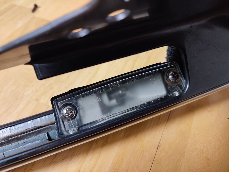

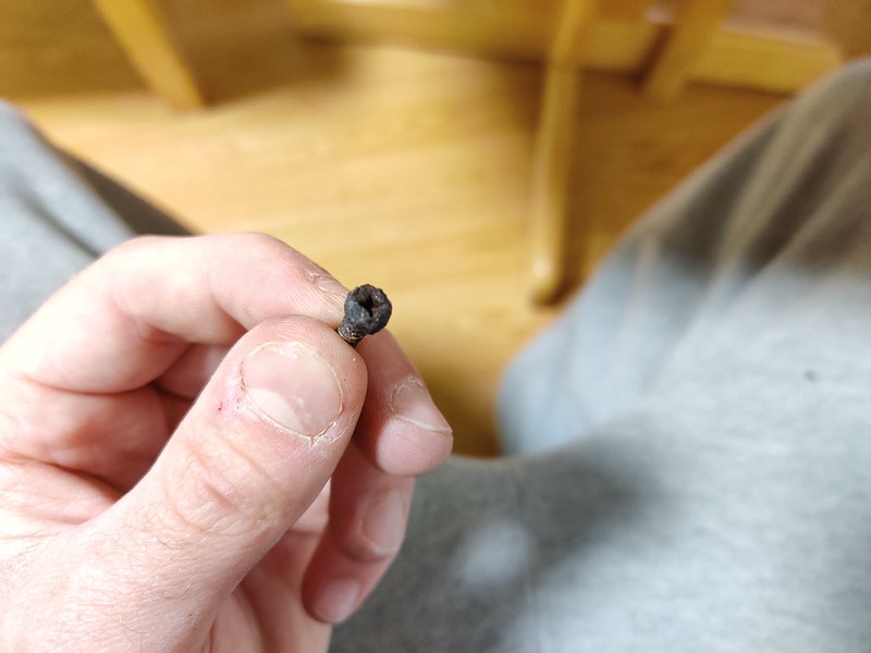

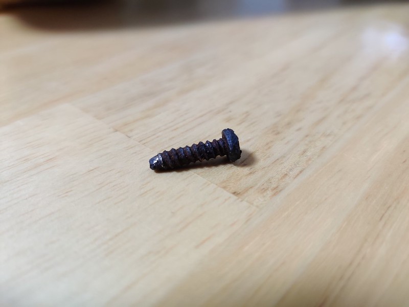

You can see the screws I pulled out below, as well as what it looked like with the replacements.
IMG_20200318_173501 IMG_20200318_173441
IMG_20200318_173229
