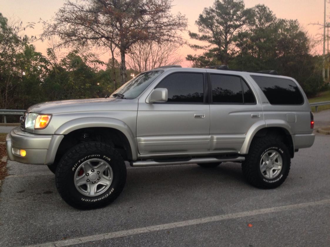

OP. It's not a requirement to run extended brake lines or panhard drop. I'm lifted 3.5" in the rear with stock lines and just fine. Some people may disagree here but there is plenty of slack back there even when flexing
