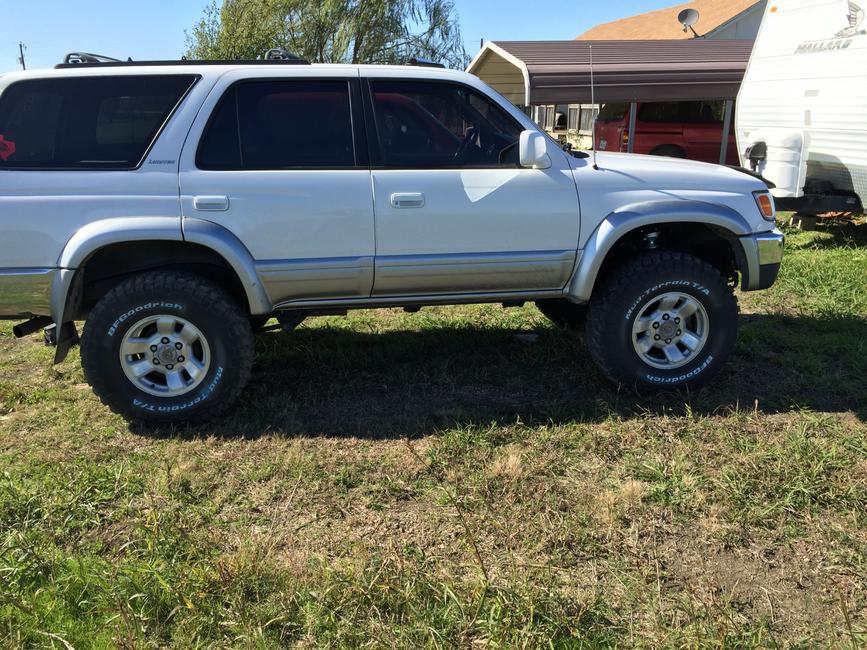

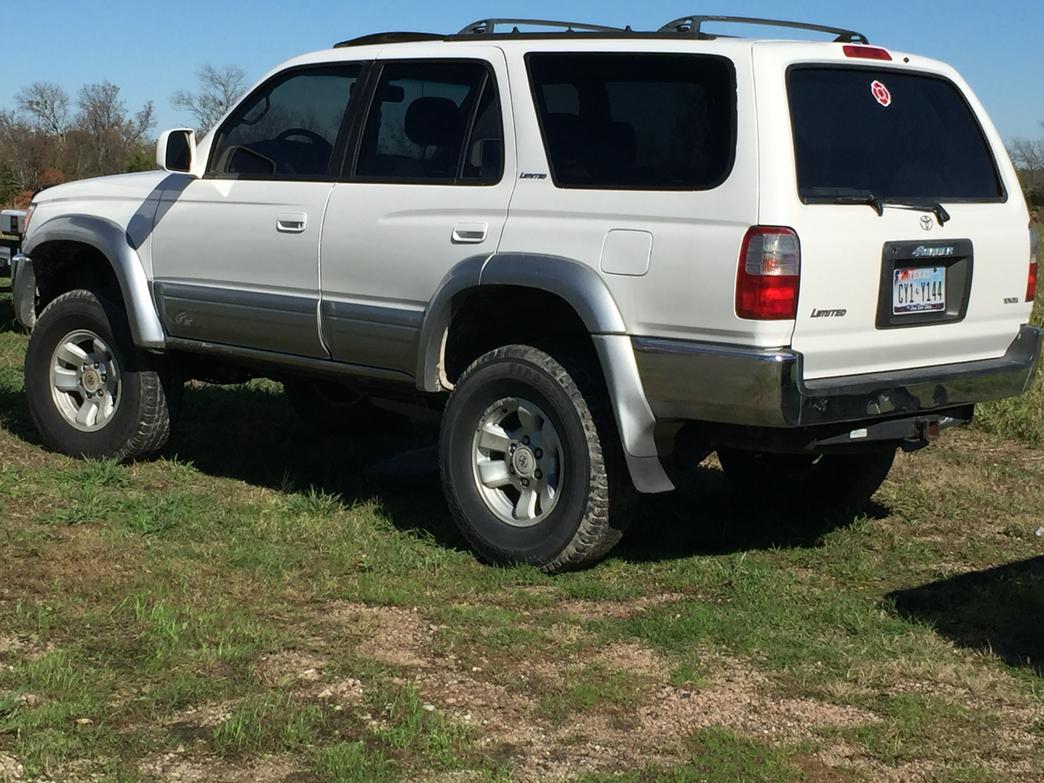

So I don't have aftermarket bumpers yet... I got the adjustable front shocks on the ultimate lift and they should help when I do put the heavier bumper on. Here is my truck with 31's and the lift with all-terrains and then with 33's and mud tires
