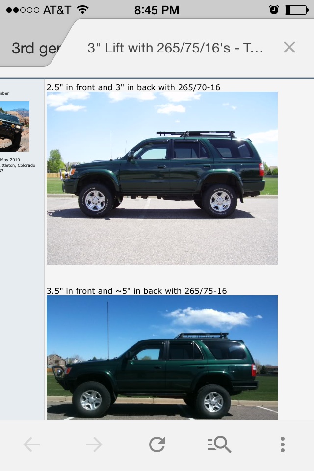

I like the look of the bottom pic.

I like the 1.2 kit because I don't have to peice stuff together later,like most I'm sure after awhile I will want to up grade,this will be a dd for 4-5 years I'm sure.
