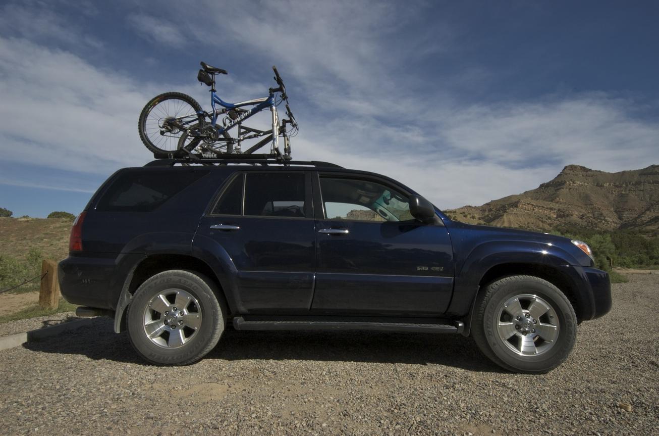

Before & After

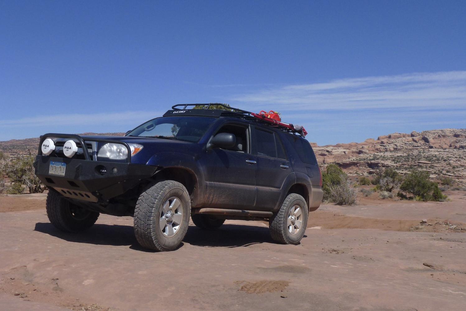

-Icon 2.5 Extended Travel Coilovers w/ Remote Reservoirs (Preloaded 1.5") FRONT
-Icon 2.5 S2 Secondary Shock System w/ Remote Reservoirs FRONT
-Icon Piggyback w/Remote Reservoirs REAR
-Icon 2" Rear Springs with AllPro Offroad 1.5 lift spacer
-Camburg 1.25 uniball UCAs
-Toytec Dif-Drop
-Toytec 1" Body Lift
-Custom Energy Suspension 6.5" Sway-Bar Links
-Method Racing Standard 17x8.5 Wheels
-Cooper STT 285/70/17
For those of you looking for a new suspension I really like the new stuff Icon stuff I got.
With the swaybar links and the extra travel on the rear shocks, the rear rides very nice.
The front dual set up rides about the same on road, but is amazing going fast over the washboards and woops.

are you hitting your UCA on the coil spring?

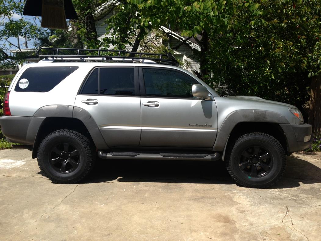

Here's my new additions. FJ springs, Revtek spacer lift, painted wheels, and a disco roof rack(dont ask how it's attached).
Unfortunately though I have both CV joints leaking. Whats a realistic price on replacing those? Pep Boys wanted $550 each. I don't have the time or I'd do it myself. I know their price is WAYYY too much.
