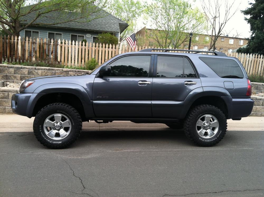

03 limited 4x4, 2.5" daystar in front no rear lift 285/70/17 duratracs.

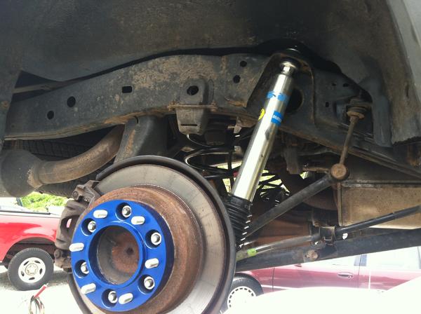

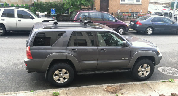

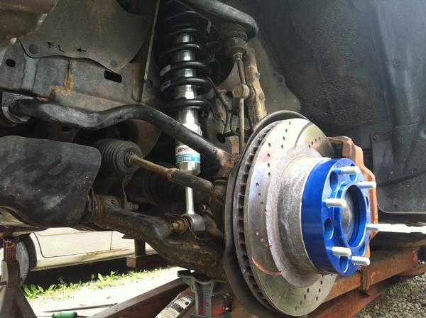

2003 4runner SR5 V6 4x4:
  • Bilstein 5100's
  • 2010 FJ Cruiser Springs/Coils (bought new from dealer)
  • Energy Suspension Polyurethane Front and Rear Sway Bar Bushing Kits
  • Spidertrax
  • Nitto Terra Grappler 265/70/17
I didn't measure any before/after, sorry.

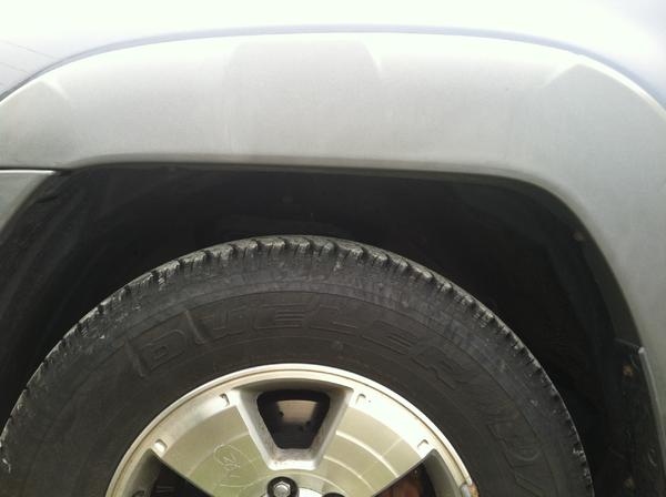

Before - Front:
Front:
Rear:

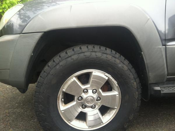

After - Front:
After:
It says 2.5" Daystar lift in the front... Still a tight squeeze for that tire size though. UCA probably not rubbing since he's got aftermarket wheels.
Thanks. I was kind of excited thinking factory wheels bigger tires on my toytec but was worried about my UCA. So I would probably want offset wheels then to solve this? Thanks Superman
Yup. Enough offset to clear the UCA. That's why a lot of folks here run wheel spacers with factory wheels here. Even with aftermarket wheels, I hit my stock UCA's. My tires are just so wide. Needed my SPC UCA's to remedy that. I believe around 285 is also where some folks start to experience clearance issues with body mounts at full bump and full lock. Something else to be aware of.
You were able to fit 285s with that lift?? No rubbing inside the wheel well or on UCA?
No rubbing on the stock uca's at all probably have about a 1/2" clearance. As for the fenders there a tight squeeze for sure.
Up front I had to completely remove the front mud flaps, pull the front fender liner forward about 2", cut the pie shaped piece off the bumper that was left exposed, and also trim a small triangular shapped piece off the fender flare on the back side of the wheel well opening. Tire just barely clears the body mount.
For the rear I just had to cut the mud flap off and reinstall the remainder of it to cover the unsightly gap between the body and bumper.
