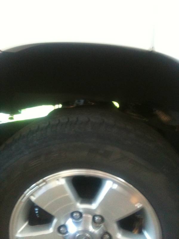

Finally got around to posting a pic

Thanks man. It rubbed on the back inner fender...not real bad but the cleats made it sound like hell. I got a 1/2 in body lift from Alex to put on sat, between that a the trimming I should be good to go.

You'll be amazed what that 1/2" will do!

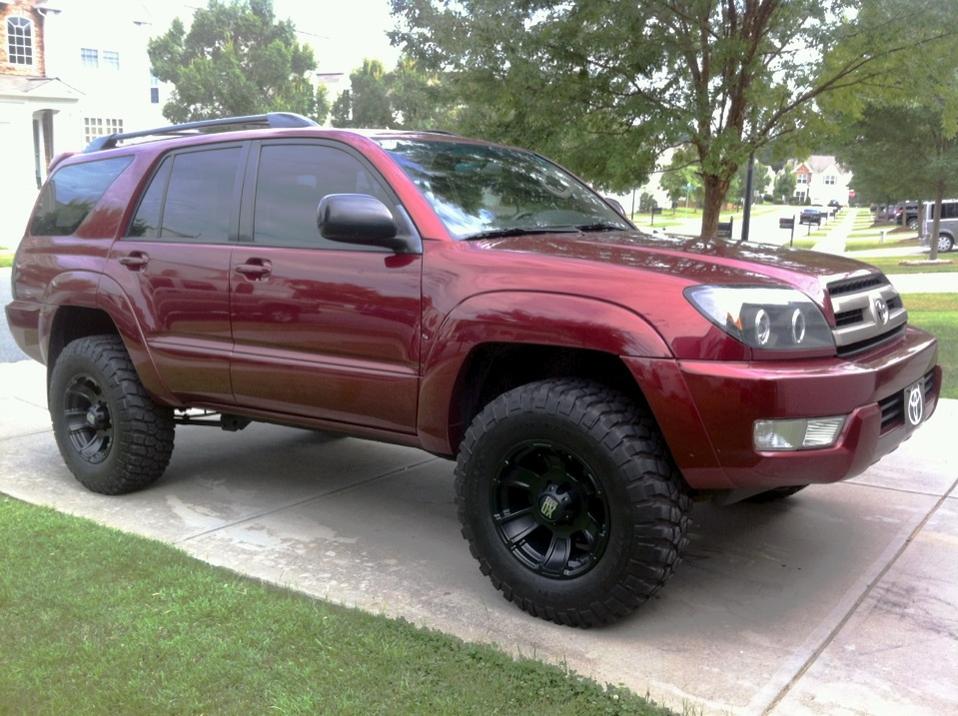

That's a clean looking truck you've got there. I have a weakness for SRP lol

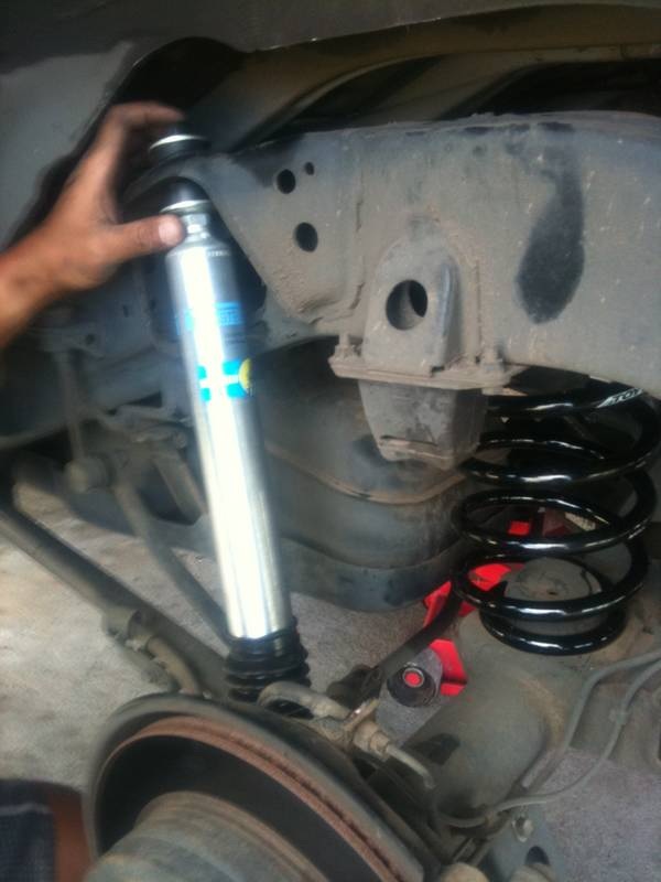

1st time on here so. Here's my lift, 1.5 RB Bodylift, after it was installed.

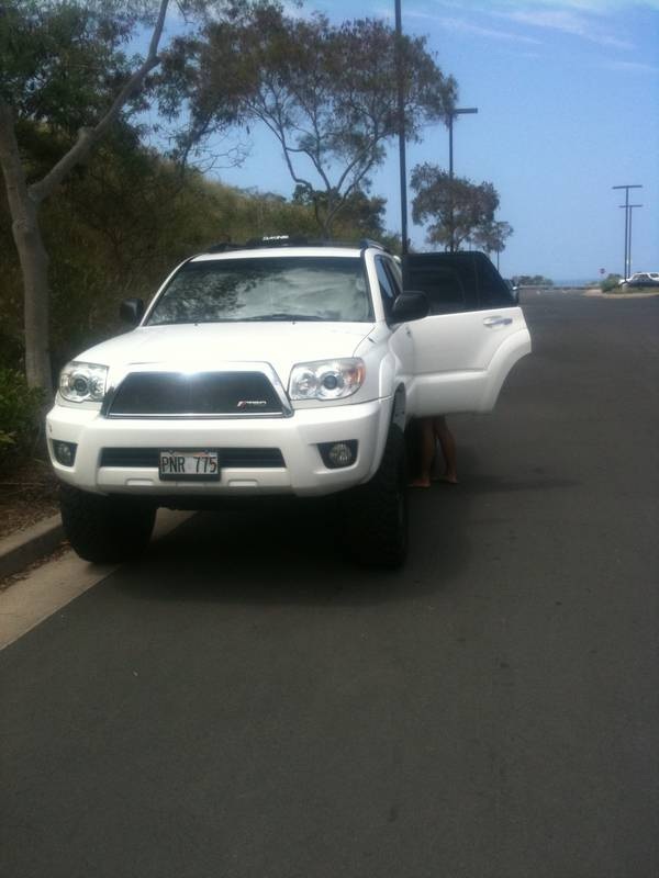

I don't know how to put all the pic. Together. After owning it for 6yrs. I thought I might just give it a different look, and after seeing all ur threads, made me wanna do it too. But I had it planned for awhile now so here she is.

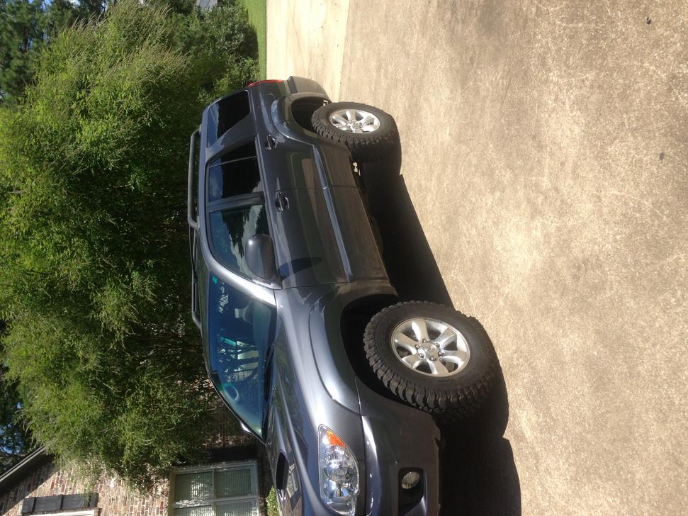

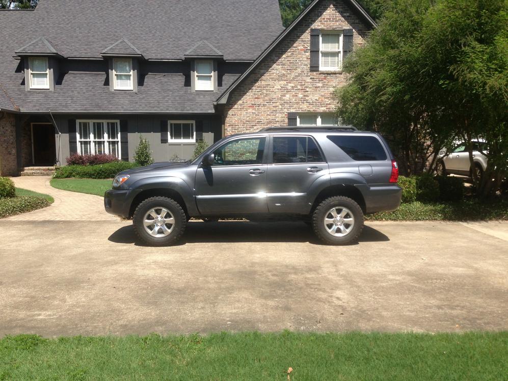

Glad I can finally post in this thread. Lift is Bilstein 5100s all around with front @ 2.5 setting and Daystar 1.5 Spacers in rear. Tires are BFGoodrich MT KM 255/75/17

Looks good Jake! I'm starting to really like this tire size! How much rubbing did you have? I'm think that it would be a bit less than a 285.

Thanks! And I'm a big fan of the tire size myself. I actually don't rub anywhere, I think taking my mudflaps plays a part in that

it's actually really similar in size to the 265/70. The 255/80 is closer to the 285, both are 33's. I really like the pizza cutters. definitely less rubbing, 255/80 and a 1" BL sounds pretty good to me...
