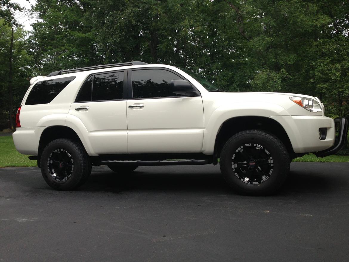

265/70/17 Falken Rocky Mountain ATS
17X8.5 6-139.HR-6MTB MB CHAOS Wheels
Toytec leveling kit
(can someone tell me how to find out what size it is? Do you just measure it? I bought it installed already)
I originally purchased the same tires in 33s which rubbed on the front bumper when turning so I settled for the smaller ones. I'd like to go bigger again though. Any ideas what I can do to make them fit? Would a different offset wheel help at all? Different tire? or just a new lift?
Thanks for any comments or help

If its a spacer lift you can just measure the front spacer and youll get your answer. As far as fitting 33's. I would think you could fit 33's with not much trimming. Or just don't turn so sharp haha

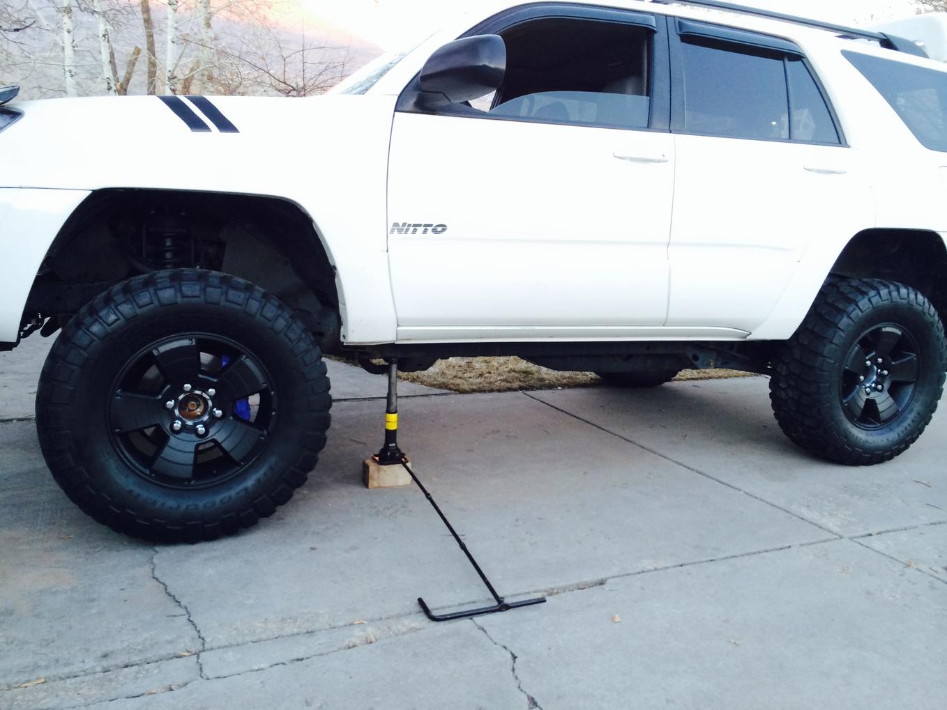

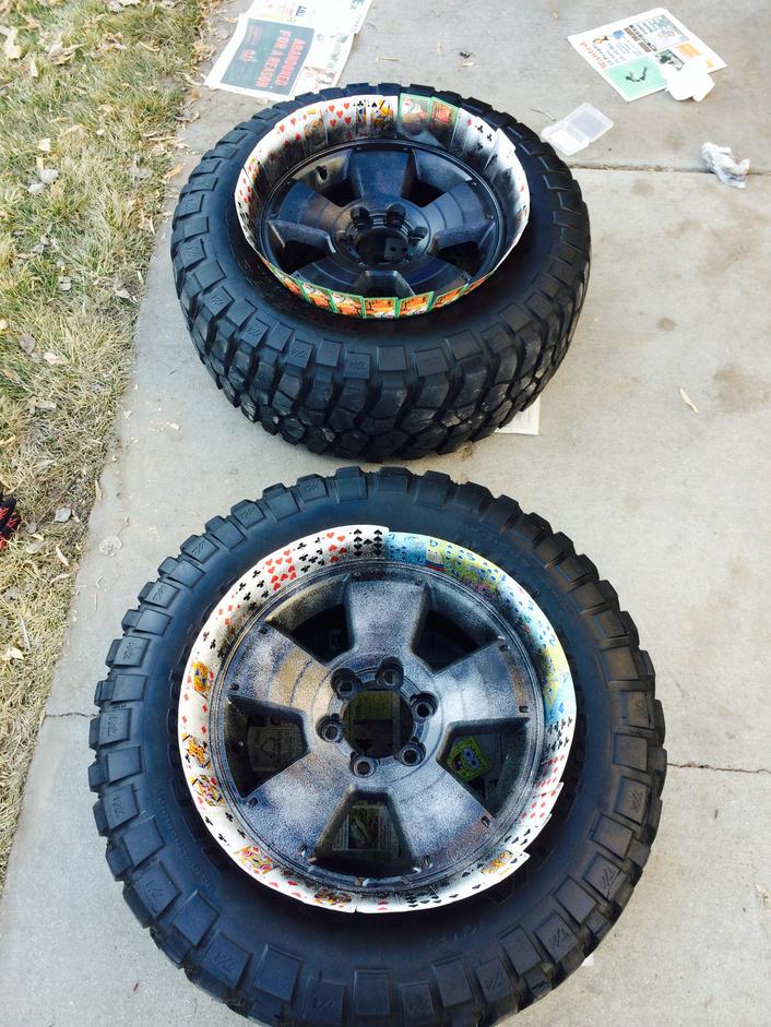

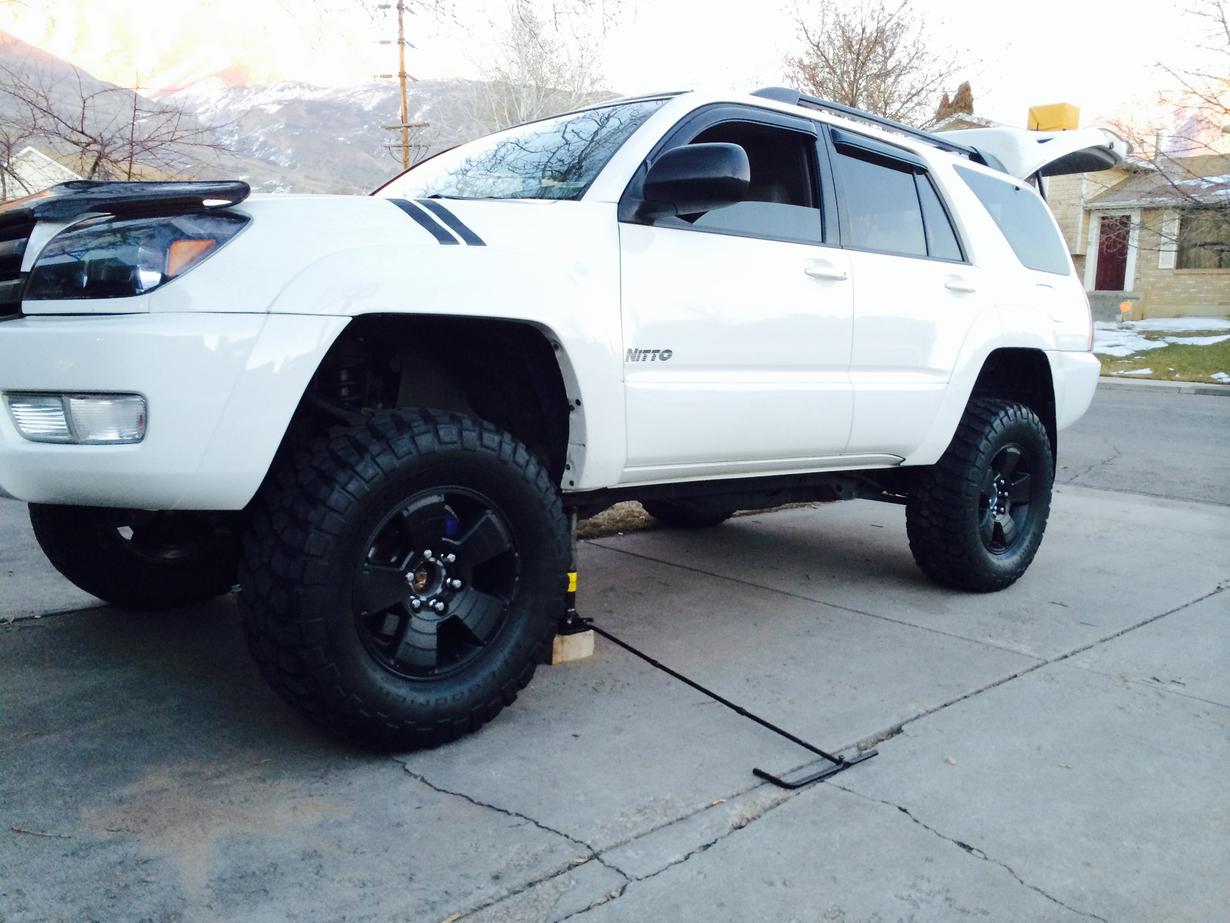

My stunna 2003 4 Runner
Bfg Km/2 285/70/17 Plasti- Dipped my rims even though its freezing here in Utah

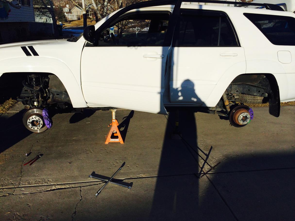

It can be done...
I removed my Sport brake system and purchased the '07+ FJ brake system. As you can gauge by the dust shield in the pic, the FJ rotor is 1" smaller (dia) than the stock Sport rotor. I can tell a little difference, but nothing I gave a second thought about. I also purchased some Pro Comp Xtreme steelies and 285-75-16 Definity Dakota M/T's the same week, and finished the entire transformation over a weekend. I was super stoked with the final product.
The new brake system going on (about two months). I removed and sold the spacers as soon the new rims arrived.

markaidan, love the playing card idea, I am totally going to use it! Runner looks great, BTW. Thanks!
EDIT: I see I have made an error, BlindT4R was using the cards... my mistake. I really like both rigs!
It is a great idea and I have used the same process in the past, but credit must be given to [MENTION=100135]BlindT4R[/MENTION] for his posting of the playing cards.
And, thank you for the compliment - if that was directed at me? You may be referring to BlindT4R sweet 4Runner?! His is white and mine is silver...
