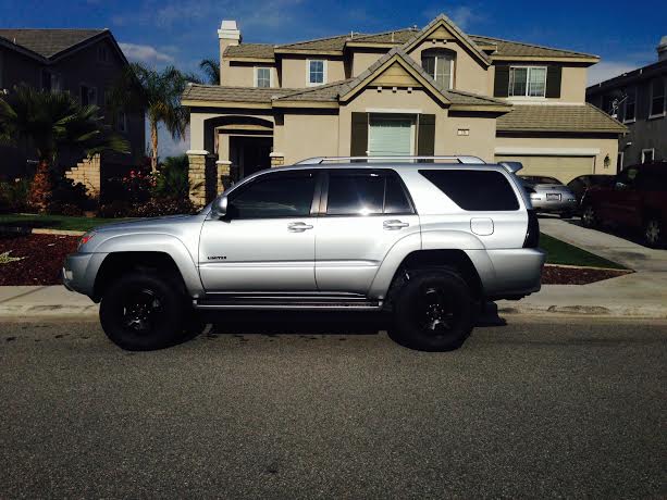

I still have some more work to finish this up. I am happy with the stance and the way it looks right now (minus the mods in the future). The ICON suspension is ridiculously nice. Also the Toyo M/Ts are a much softer riding tire than I imagined. They are almost as quiet as my BFG T/A KO's but have a little bit more of a hum to them. The biggest problem that I came across is that at about 3/4 turn there is sever rubbing on the body mount. Going to take care of that in the very near future. Also I am planning on cleaning up the trimming they did. It looked as though they were in a hurry, lines aren't even inside the wheel well and just looks poor. I know the average person wouldn't even notice, but it still bothers me. Ill post some more pictures with a better camera when the final product is done (along with a washed car).
Looking back on it I probably should've just gone with the 285/70/17 just due to the totality of the fitment issues. Live and learn.

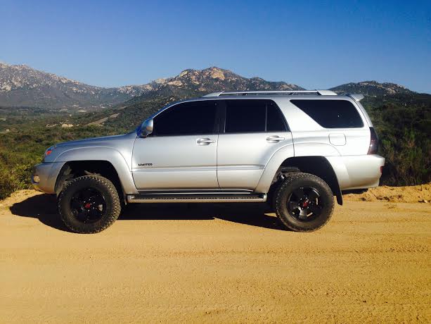

So glad I can finally post in here! Crappy pictures but it's 5100's all around with tacoma springs up front and super flexes in the back. Install took me and my buddy 5 hours, 2 of those spent on one bolt. Im sitting at about 38 inches in the front and 39.25 in the back.
just curious, what setting did you set the front bilstein shocks to?
They're at 2.5. These tacoma coils are off a pre-runner so I don't know if they're any different than the springs from a 4x4 would be, but using this combination I netted right at 4 inches of lift in the front. Cv's are fine after I re-clamped them and my alignment guy was able to get it back in spec. Loving it :thumb:

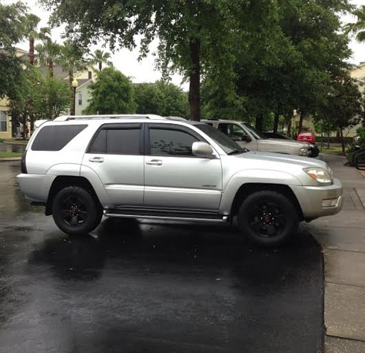

Still along ways from where I want it to be, but it's a start and I had to replace the stock suspension. It was wore out. Driving from SD to Orlando is much better than the trip from Orlando to SD......I wanted to get Fox, King or Icon, but being in Orlando, I'd never get the suspension to work the way they are designed for the open desert.
This set up will work just fine.

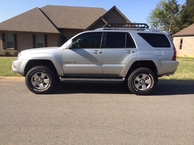

1. OME 884's front, Toytec Superflex's back, 5100's all around approximately a 3/2 lift
2. BFG TA KO's LT265/70/17's C rated with 1.25 inch Spidertrax
3. Just had it all installed yesterday so of course I like it, time will tell.

Cool - Any cutting, rubbing or triming needed?
Have a bit of rubbing on the flaps and front wheel well at the front bumper with full turn left and right. I just plan on trimming a bit of the flap on the inside and will push the plastic forward a little on the front. Hopefully that will solve the issue.
