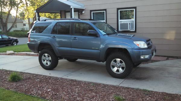

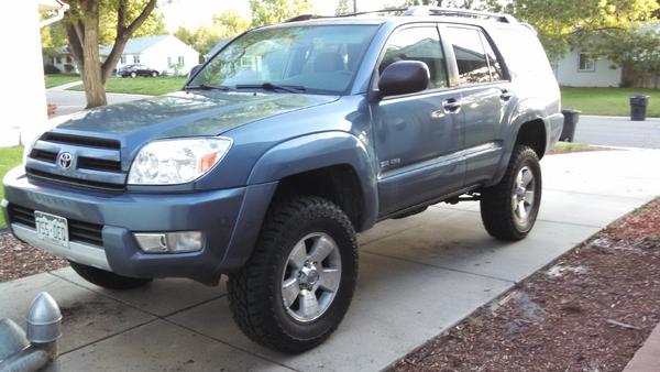

Finally contributing to this thread
2006 SR5 V6 4WD
TRD FJ springs/shocks + 1/2" toytec top plate spacer in front
Poly bushings
SCS Stealth wheels (gloss black)
Cooper Discoverer AT3 (P-rated and stock size)
Fender height: 35.5" front, 36.5" rear
Rides firm and corners very nicely (much less body roll)
Cooper AT3 is so smooth and quiet (compared to my previous c-rated Duratracs).
edit: pics below
I am finally able to post some pics of my rig up here. I may be the first person on here to purchase these tires but I have to say how impressed I am after the first few miles put on them. I kept it really cheap thus far on the build.... Using 5100's at 2.5 with stock springs and a toytec top plate spacer for a full 3"; in the rear I am running some Metal tech springs and Radflo 2.0's! The tires are 255/80-17 Cooper St Maxx.

They are super quiet on the freeway and the tall skinny tire is tops IMO. If your at 3/2 these coopers fit perfectly. I didnt have to push the front fender liners forward or chop the fender edge. My lady isnt thrilled about how high the rig is now; But I LOVE it! I finally cant see the top of the roof

These are 255/80-17 load range E 33" tall 10" wide no rubbing on stock sr5 wheels and no spacers needed. Whole inch taller than 75 series

You just made my day! For some reason I though you put on 255/75's and I wanted the 33's but your picture made them look close. Now I'm definitely getting the 255/80's. I did the fj swap instead of daystar but there should still be enough room
