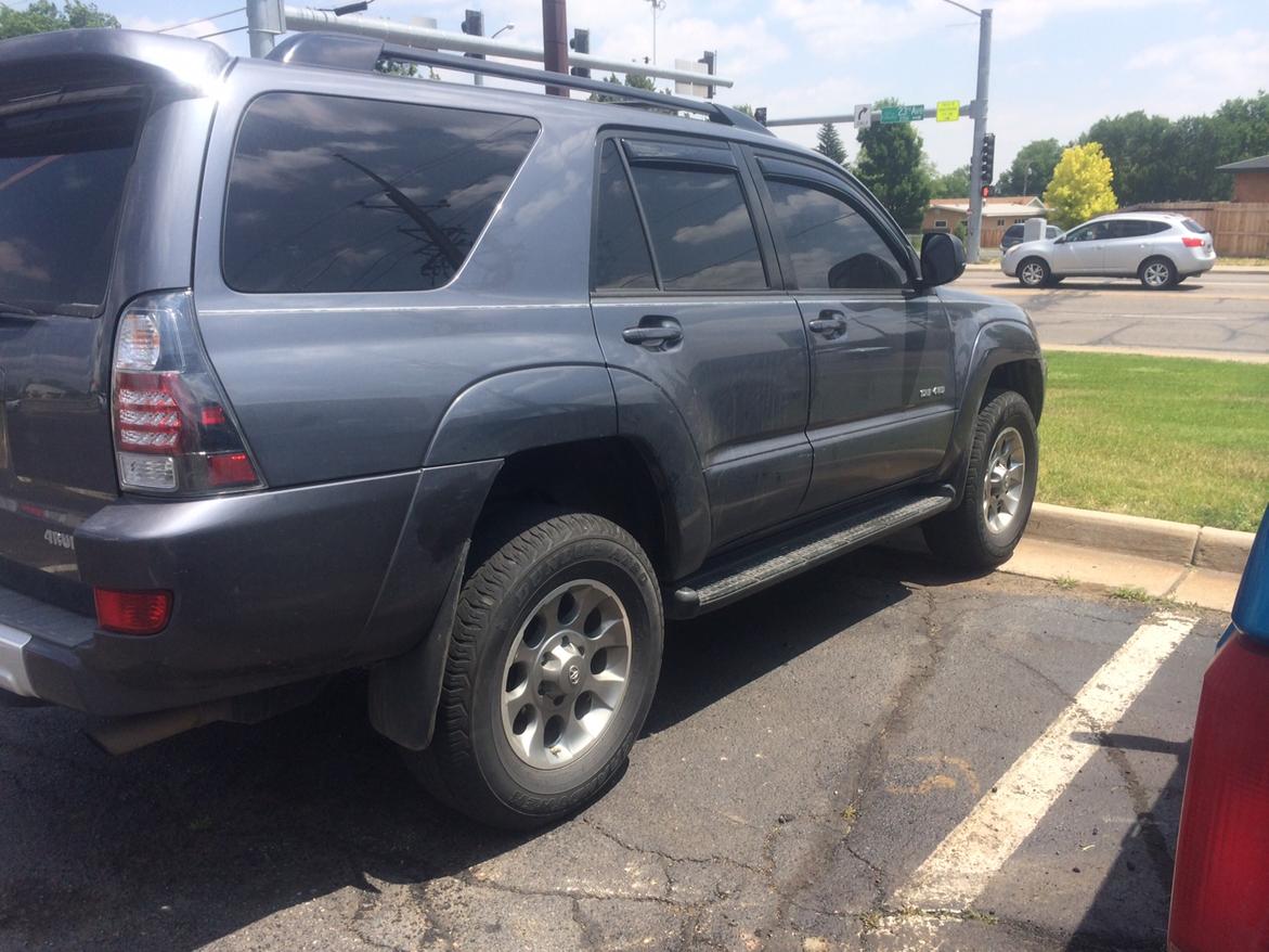

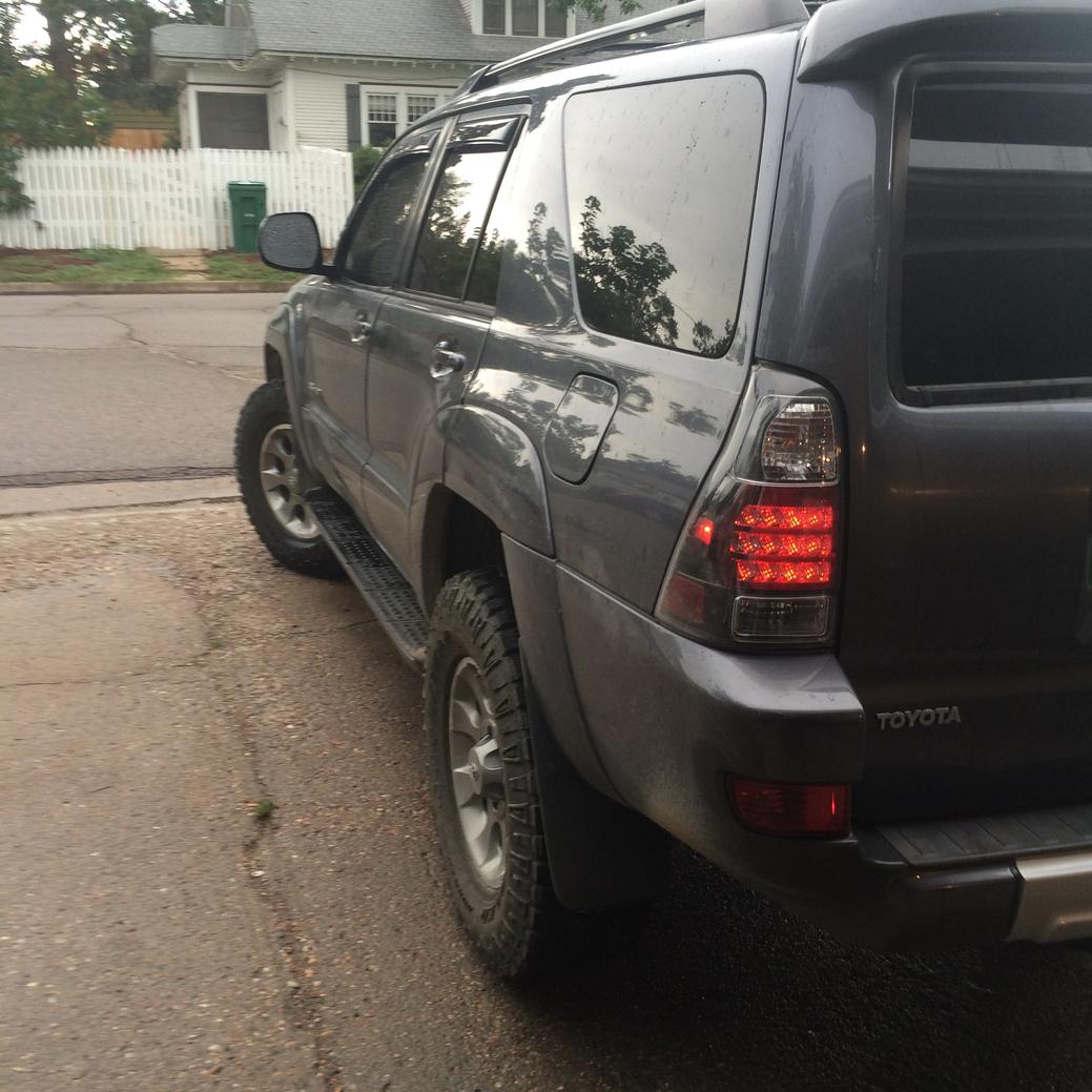

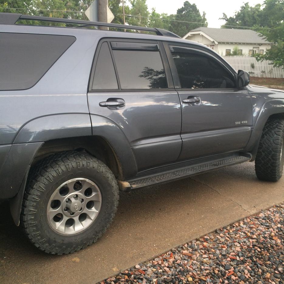

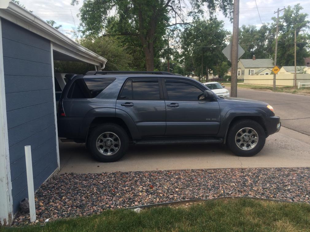

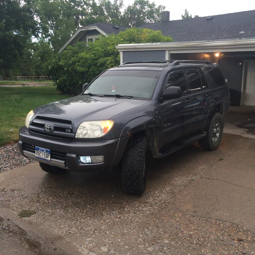

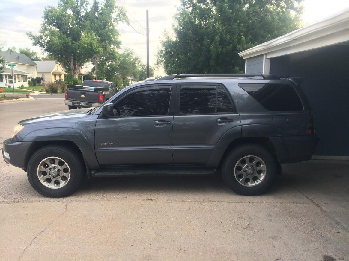

here is my runner with stock suspension then with FJ coils and 5100's at 1.75 and a cornfed 1.5" in the rear, then with new tires 285 75 17 duratracs lift measured from stock front @ 33" and rear @ 35" to after tires measuring 36" front and 38.5" rear thanks to all that helped! :cheers:

Where did you get the Duratracs in a 285-75-17? It does appear a Goodyear offers that size in the US. Goodyear USA
How much trimming did you do to fit that 34" tire?

What offset are your wheels? I'd say it was worth the trouble, looks AWESOME!

ah, you caught me, I just rechecked and found out I lied! sorry, its 285/70/17 I've trimmed most of my drivers mudflap, pushed my liners forward and trimmed the bumper about an inch. the rears are about half an inch from the tire so I'm still deciding how far I want to go. for some reason I like the mudflaps so I dont want to get rid of those.
I'll just keep trimming when it rubs. or do the classic highway assisted trim!

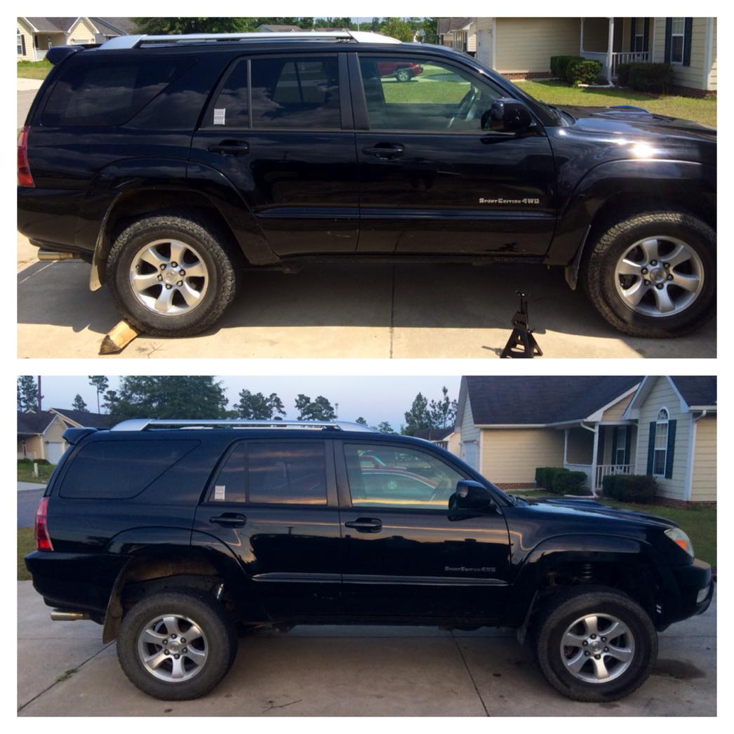

About Time
So after my almost one year of awing at everyone else's 4runner I finally decided to make an investment in mine.
I ended up going with the Toytec BOSS Ultimate life with the Superflex HD rear coils and Bilstein 5100's. I also purchased some UCA's but Ill save that for another day.<br> This kit took me two days to put on mainly because I only had a socket wrench, hammer and regular wrenches!<br>Tires are 265/75/17r Next purchase is tires!!
I still need to level out the back end but so far it drives much better than with the XREAS.
Now I can finally purchase a T4G sticker!!!

Looks great !
Any pointers for reducing install time ?
<br><br>
Invest in Strut Spring Compressors. I know Autozone will rent them out<br>for 55 and you have up to 30 days for a full refund<br>I paid 32 with military discount normally 35.99.
Didn't that kit come with the struts already assembled ?
<br><br>
