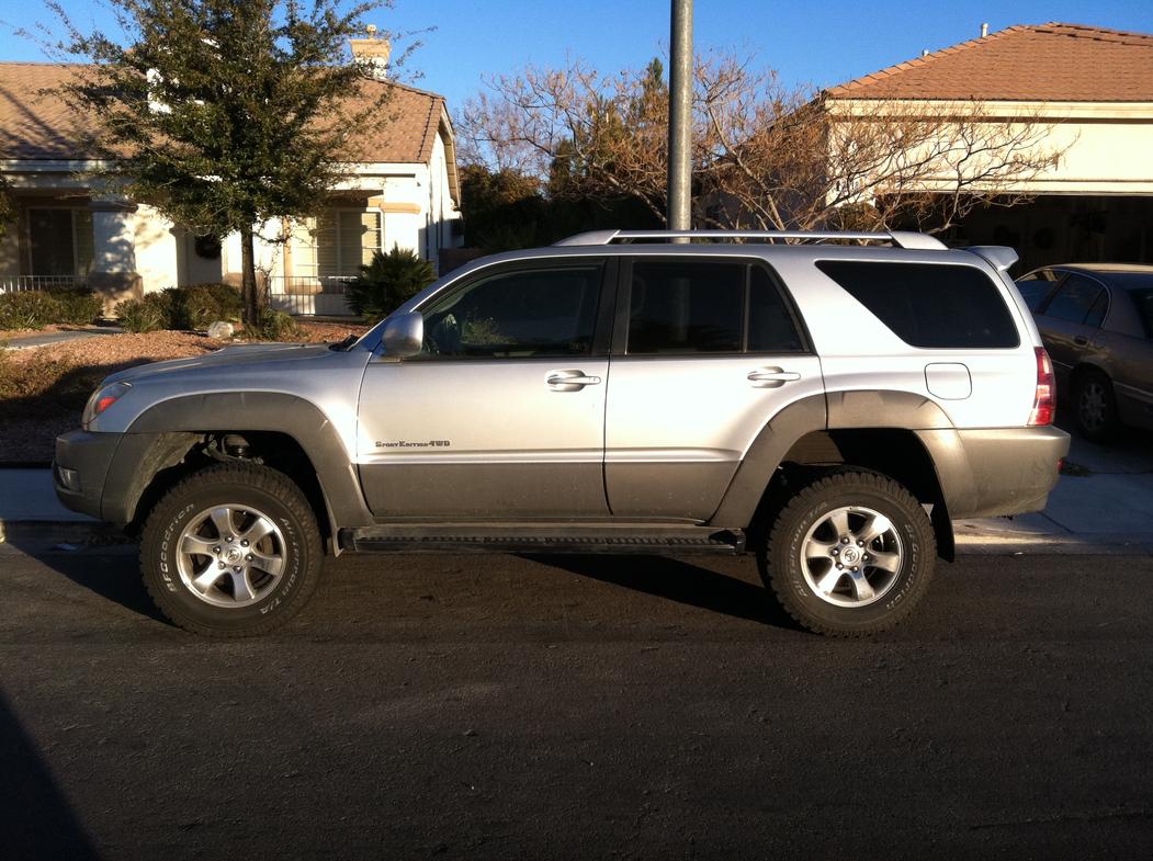

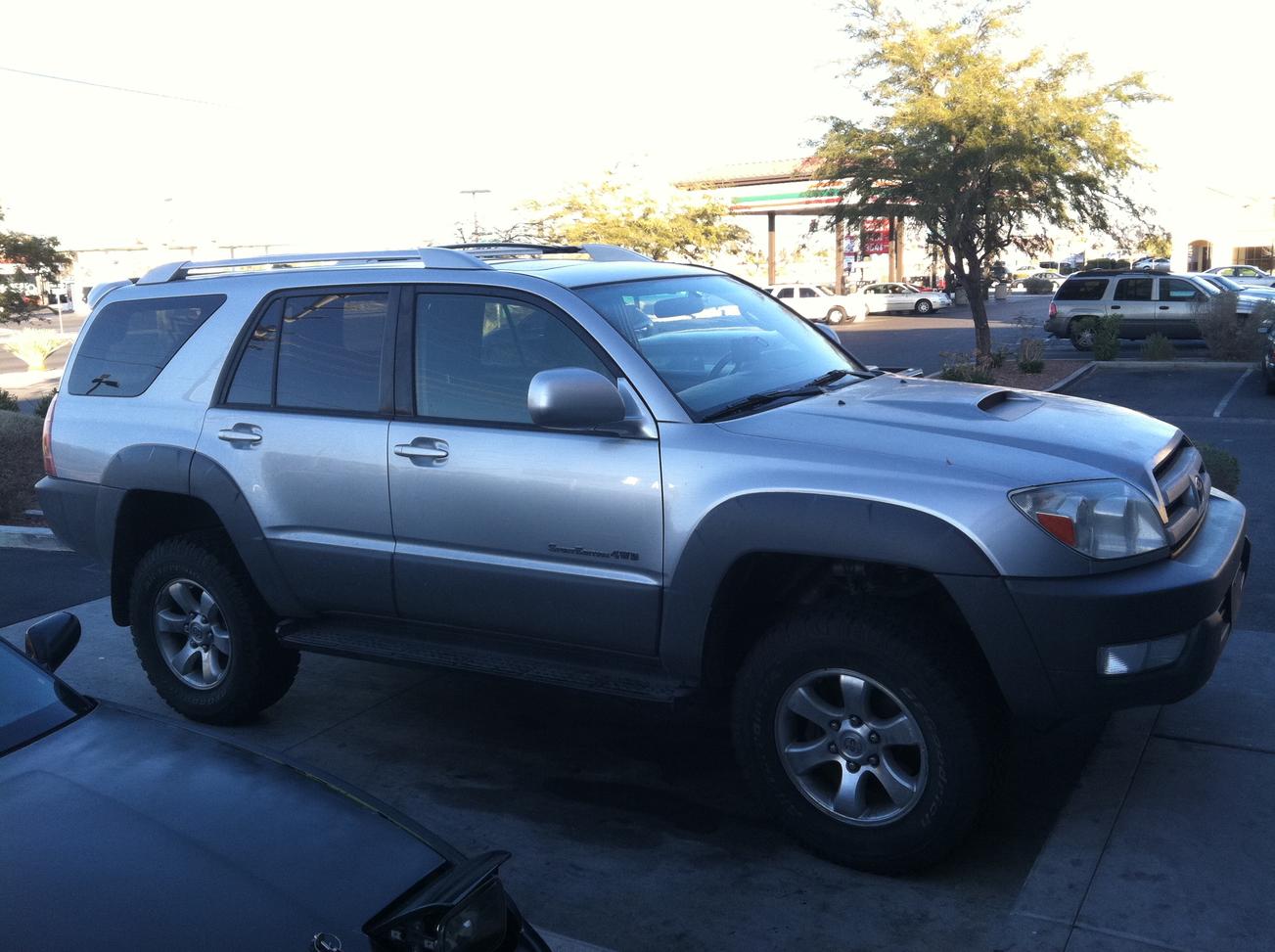

And to actually contribute to this thread, here's Momo's with the Daystar 2.5/1.5 before the BFG's next to my stock!
2011-12-12142708.jpg~original
DayStar 2.5/1.5
Bilstein 5100's X4 set at Zero
FJ Springs
BFG ATKO 270/70/17
Things I would do differently:
Probably take off the DayStar and just use the Front shocks for lift.
Be more careful on the front LCA ball joint...made a little hole
Take off the XREAS about 5000 miles earlier!
