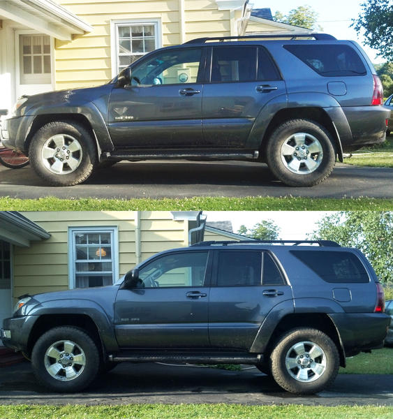

265/70r17
daystar 2.5/1.5
here is my before and after of lift, same tires.
adumb-albums-adumb%27s+4runner-picture12668-before-after-daystar-2-5-1-5-leveling-lift.jpg
Moved front fender liners forward, minor trimming on edge of bumper, kept front flaps on after cutting the body mount protrusion area of the flap. Tires did little to change the ride. Very happy, climbs like a beast.
looks so great man, we've got similar rides, and the BFG was my other choice besides duratracs! Great choice for sure!!

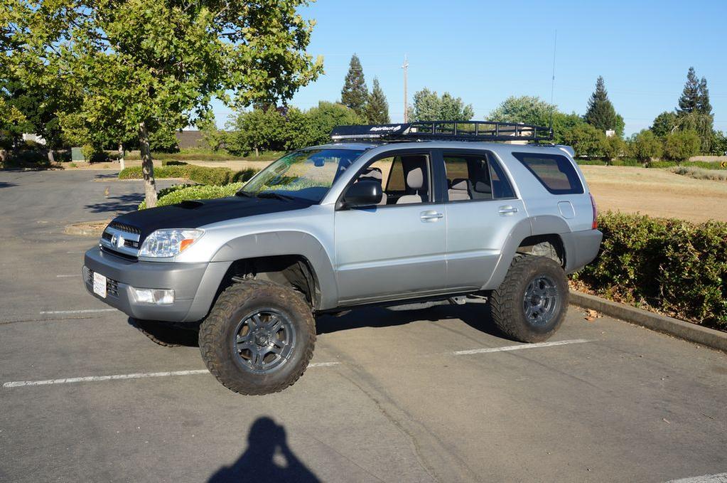

OME 886s front, All pro 3.5" rear springs, ATX artillery wheels, and 305/65/17 MT baja Claws.
