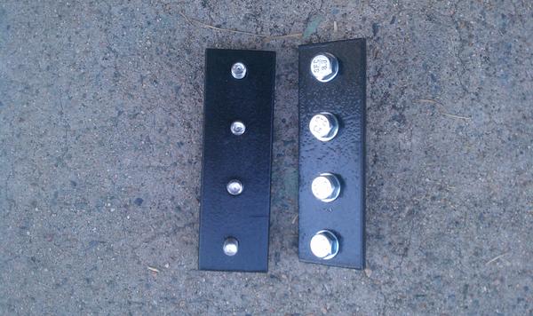

Here's my problem. I went to install my lift and the rear is insanely high. Based on what I have read, I am 2-3 inches than others on this board who have gone with the same set up. This is causing me additional problems to include over extending my sway bar and placing my new shocks in an extremely awkward position/angle. Here are some picks which should help explain.
Rear Shocks are Bilstein 5125 with Shackle mount adapter and LC7 the coils are 19" Double Pink Light Blue White 7.5 wraps and 19.5" Purple Green White 8 wraps.

Sway Bar is stressed to the MAX

You will need longer endlinks or extended sway bar brackets.

I have the lc coils in the rear. I took out the cone bumpstops and have sway bar lift/relocating brackets to prevent the stress to the sway bar.

Where did you get the sway bar relocating bracket?
