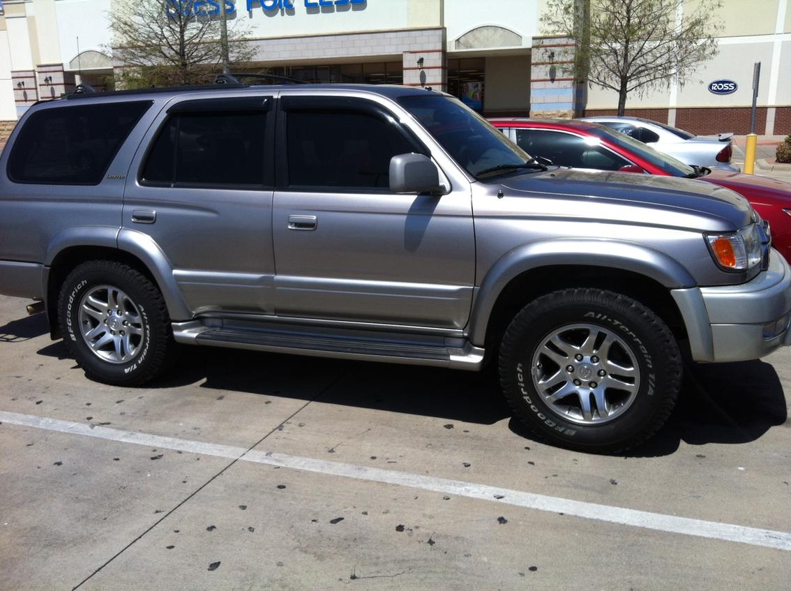

finally got my lift done! took me a whole day to install because of the dam rust.
front is taco's 5100 r.h.a shocks set at 2.5 and rear is ome 890 with blistein 5100. My measurement for the front is 36 inches and the rear is 39.

thanks! all i really like the stance of it but i ordered some new parts because the 2.5 setting wasn't enough to even it. I think it's because how old my coils are.

nice bro! i got the same set up as you at the moment. im getting ome 883's for the front along with the OME 90004 Nitrocharger Shocks.
Just out of curiosity...what did that setup run you? I'm looking to get my a#$ end up! Been looking around at different lifts for months. I won't mind the uneven rake in the rear...I carry about 150 lbs of tools in a receiver hitch basket box so I think it will probably even it out. I''ve got a bone stock '02. You can see how its currently sitting now. It needs improvement!!
