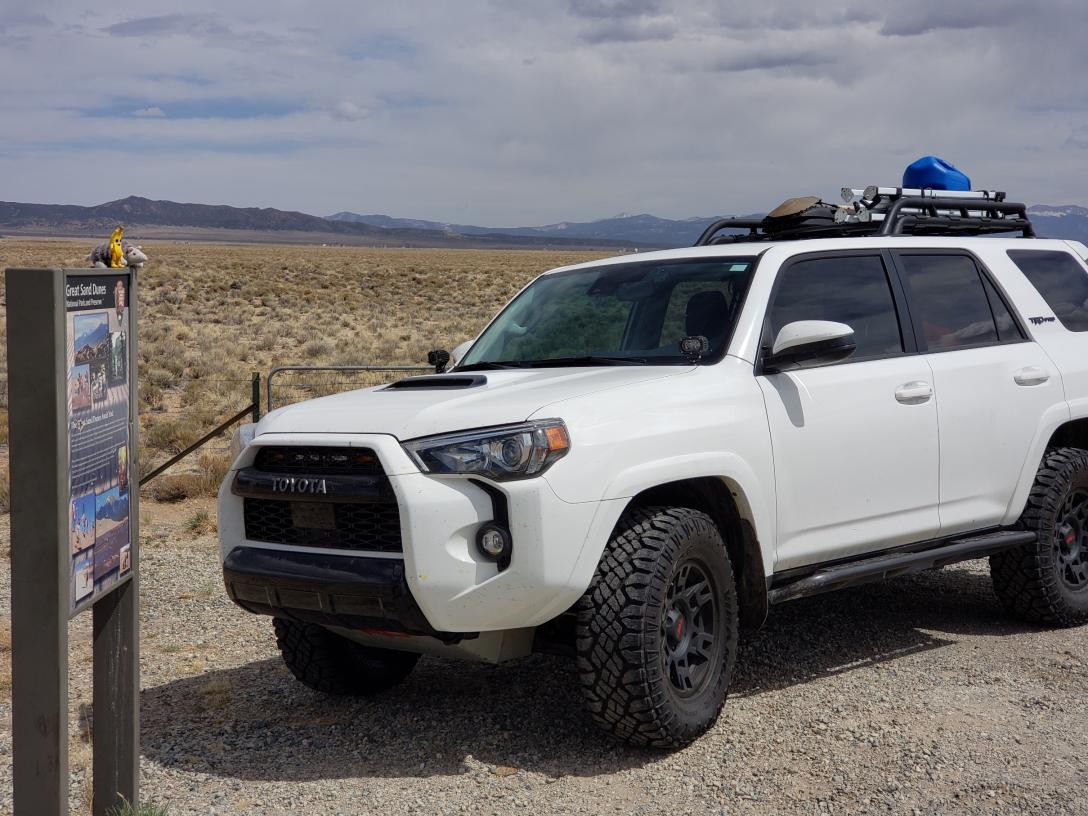

Here is mine a couple weeks ago...great sand dunes nat park.... duratracs measure a full 33.....stock trd pro suspension...no uca upgrade.
Awesome to see they fit!
1) Any rubbing or fender trimming needed?
2) Why did you opt to go with Duratracs instead of either BFG KO2 or Falken Wildpeak AT3?
Small amount of rub on driver front, pulled the liner forward a bit by unattached and reattached....fender liner / mudflap I used heat gun to push back and reset the shape.
Duratracs...like any tire you hear good and bad. I liked that they seemed to be slightly more aggressive in mud and the tread depth was 2/32 deeper than most. Also they have a 45k warranty (not sure about ko2 or falken)...also they are a full 33 inches O.D. Lastly every mall crawler here in Nashville runs nitto ridge grapplers...any i like to be different. Plus its not a mall crawler. I'm not a hard-core badass, but it has its share of pinstripes and gouges on the skids.

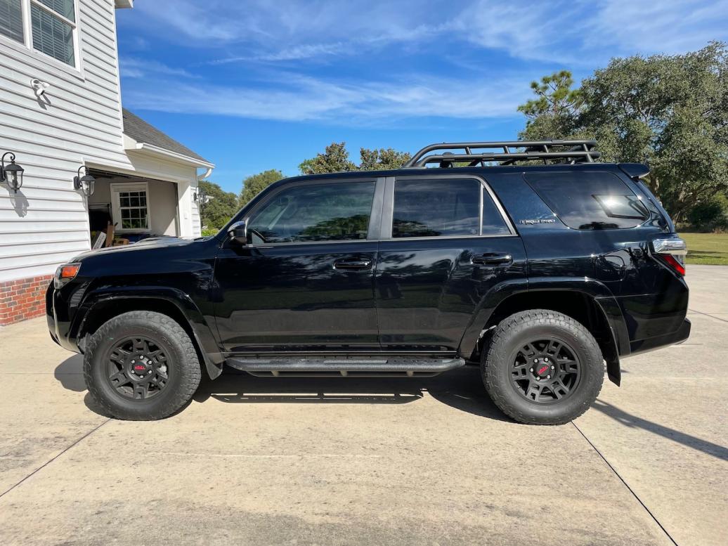

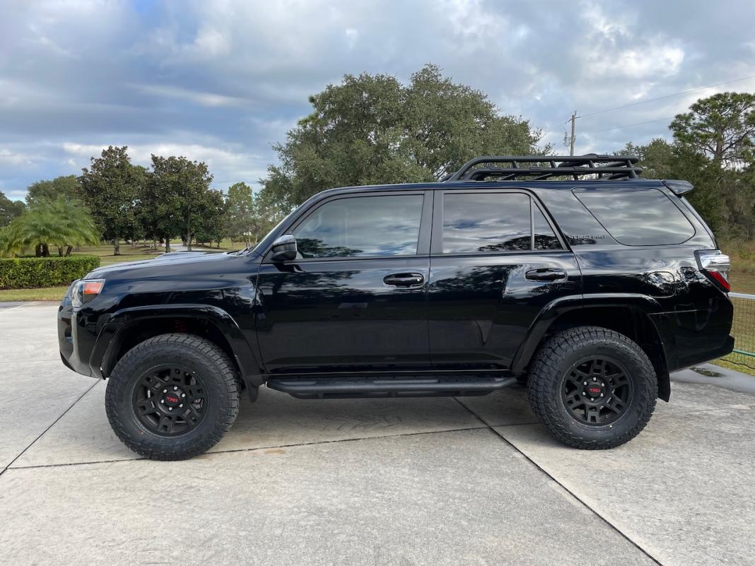

Appreciate all of the feedback on here from others who went this route. I just had the Eibach springs and 285 Wildpeaks put on my 19 Pro and so far I like the look. The ride is definitely firmer and you feel some of the smaller bumps more than before. It also wanders a little side to side at interstate speeds now. Overall I would do it again. I don't do any hardcore off-roading, so can't speak to rubbing at full articulation, but I towed my 16 foot trailer through a pasture over some pretty good bumps and no issues. Before and after photos
[MENTION=11567]Jeff74mg[/MENTION] - looks good. I have the Eibach's on mine as well. Aside from the springs (and an alignment, I'm assuming), was there anything else that you needed to do to get the 285s to fit?
The shop didn’t mention anything else and I don’t see any signs of trimming, so looks like the 285 Wildpeaks fit fine without further trimming or modifications.
