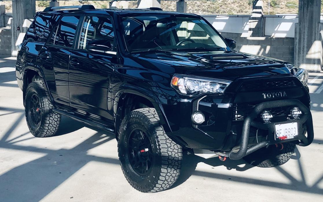

Go 285. You will never question yourself. I started with 275’s, but eventually went with the Falken AT3W’s in 285. If you get the SL rated ones you will have more sidewall and a smoother ride as DallasPRO stated. Also, there is so much more selection and availability of 285’s compared to 275’s. A 285/70-17 will also fit in the spare tire well.
Thanks man, that pic helps.....because it looks very similar to my 2020 TRDP which is also black. Not that the color matters but it makes it easy to tell what mine would look like on 285’s with OEM wheels.
I think it’s settled.
