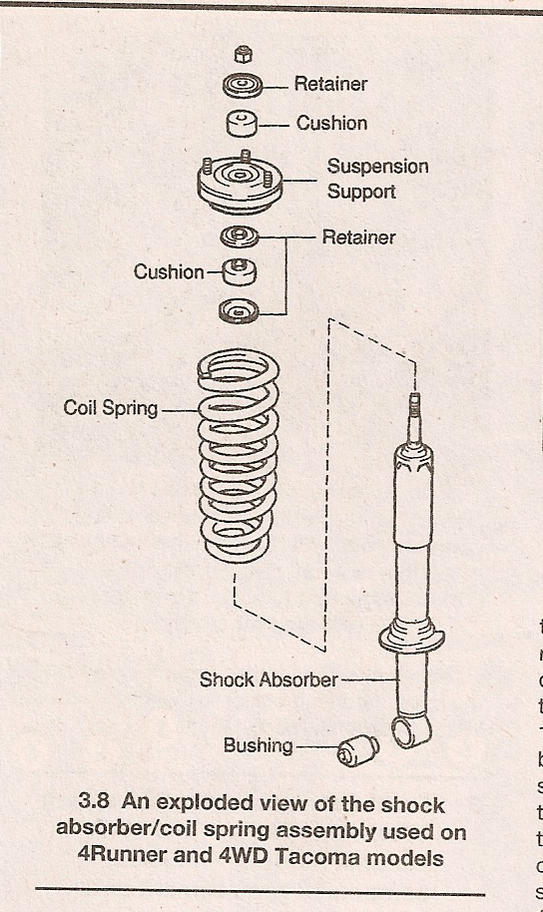

3. The mounting hardware for the front 5100 has top bushings and bottom bushings and top washers and bottom washers, but it doesn't say which is which? Does anyone know of a way to tell?

Just put 5100's on a few weeks ago. It will be the washer on the top of your pic first, smaller bushing with nipple up. Then scoop washer in the middle of your pic, second small bushing (can't remember nipple up or down, it should fit into notch on underside of tophat) - Large bushing on top of tophat, large washer, dampening rod bolt. Are you putting a new top hat on as well? That should be the order if I recall.
had a few moments. scanned coilover assembly diagram and attached it. The thing I remember is the second smaller nipple bushing was already in my new tophat.

Very nice diagram! I think Bilstein should include a similar diagram. I am re-using my 4runner top hats, but I did buy Tundra Spring isoloators (basically just rubber pieces) that go between the spring and the top hat, I read somewhere that is all that is needed. I guess I will see once I get it all torn apart!
